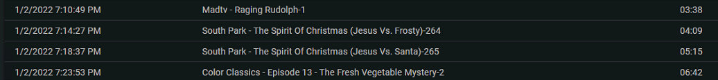

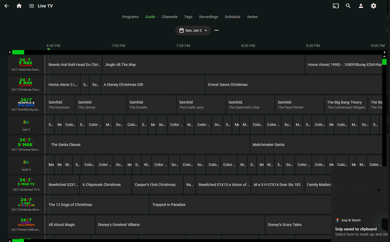

Carlo 4561 Posted January 2, 2022 Posted January 2, 2022 I've never seen ersatz tv before so I'm not sure how it works. The show times you show are very unusual. Can you take a screenshot and show us what this information looks like in your guide?

eeeeeesy 31 Posted January 2, 2022 Author Posted January 2, 2022 1 hour ago, cayars said: I've never seen ersatz tv before so I'm not sure how it works. The show times you show are very unusual. Can you take a screenshot and show us what this information looks like in your guide?
