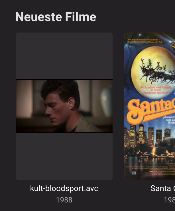

Burrito78 15 Posted December 7, 2021 Author Posted December 7, 2021 (edited) Hi @Luke, thanks for helping me! See information below. I imported the movie "/Filme/Bloodsport (1988)/kult-bloodsport.avc.mkv", did a library scan and then exported embyserver.txt. embyserver.txt Edited December 7, 2021 by Burrito78
Happy2Play 9802 Posted December 7, 2021 Posted December 7, 2021 Hmm Luke will have to comment more as it should have queried the folder name not the file name. file:"/volumeUSB2/usbshare/Filme/Bloodsport (1988)/kult-bloodsport.avc.mkv" 2021-12-07 12:44:55.102 Info App: MovieDbProvider: Finding id for item: kult-bloodsport.avc 2021-12-07 12:44:55.337 Info HttpClient: GET https://api.themoviedb.org/3/search/movie?api_key=f6bd687ffa63cd282b6ff2c6877f2669&query=kult-bloodsport.avc&language=de 2021-12-07 12:44:55.637 Info HttpClient: GET https://api.themoviedb.org/3/search/movie?api_key=f6bd687ffa63cd282b6ff2c6877f2669&query=kult+bloodsport+avc&language=de 2021-12-07 12:44:55.936 Info HttpClient: GET https://api.themoviedb.org/3/search/movie?api_key=f6bd687ffa63cd282b6ff2c6877f2669&query=kult-bloodsport.avc&language=en 2021-12-07 12:44:56.235 Info HttpClient: GET https://api.themoviedb.org/3/search/movie?api_key=f6bd687ffa63cd282b6ff2c6877f2669&query=kult+bloodsport+avc&language=en 2021-12-07 12:44:56.282 Info HttpClient: GET https://private.omdbapi.com?apikey=fe53f97e&plot=full&r=json&y=1988&t=kult-bloodsport.avc&type=movie Are all of your movies in their own folders in /Filme?

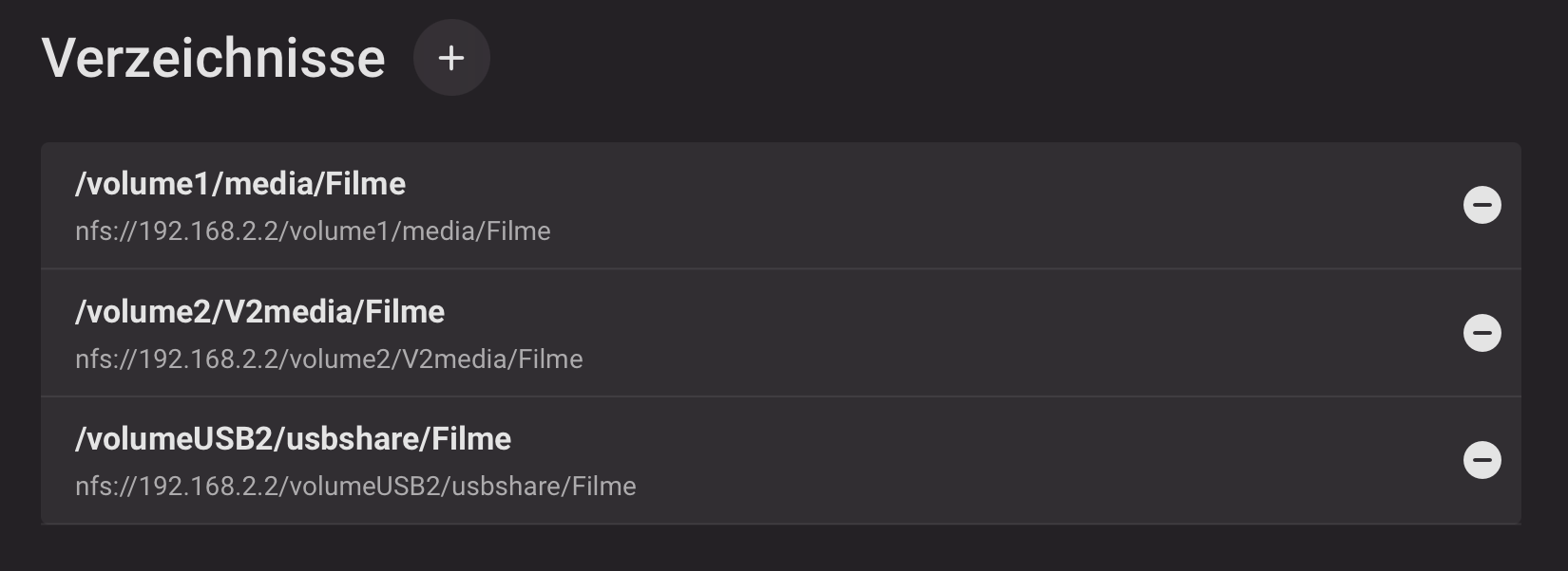

Burrito78 15 Posted December 7, 2021 Author Posted December 7, 2021 Just now, Happy2Play said: Are all of your movies in their own folders in /Filme? Yes, always in their own folder but this "Movies" library consists of 3 different folders on different shares/drives but that should make no difference. Every movie is in a folder "ENGLISH-MOVIENAME (YEAR)".

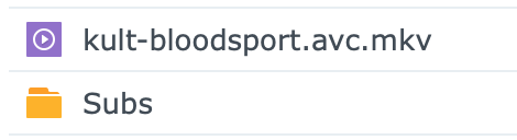

Luke 42197 Posted December 7, 2021 Posted December 7, 2021 What are the contents of the Bloodsport (1988) folder?

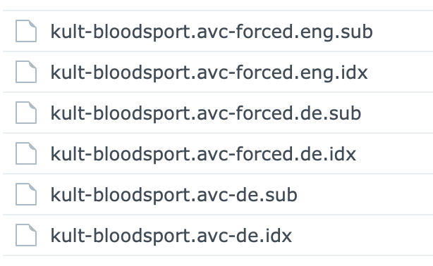

Burrito78 15 Posted December 7, 2021 Author Posted December 7, 2021 (edited) @Luke Only the movie file and a "Subs" folder: These files are inside the "Subs" folder: Edited December 7, 2021 by Burrito78

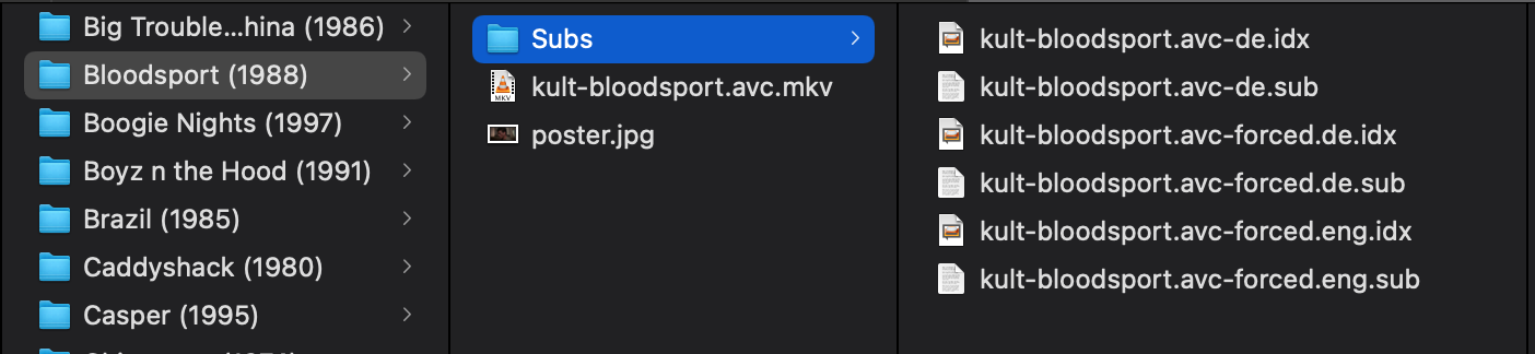

Luke 42197 Posted December 13, 2021 Posted December 13, 2021 What are the complete contents of the folder?
Burrito78 15 Posted December 13, 2021 Author Posted December 13, 2021 @Luke I will post a different screenshot with folder contents below. This is after the library scan after adding the movie.

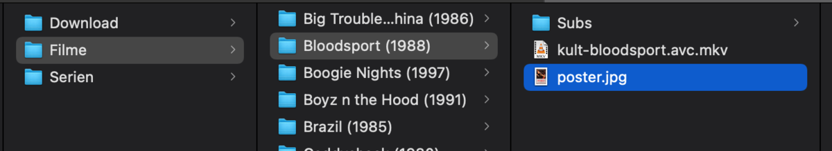

Burrito78 15 Posted December 20, 2021 Author Posted December 20, 2021 (edited) Just to clarify, the only problem i face is that automatic identification based on folder name isn't working. Instead identification seems to be always based on filename. I tested to change the poster through image editor on the unidentified Bloodsport and the result is seen below as expected. The poster.jpg is my custom poster: Edited December 20, 2021 by Burrito78
Luke 42197 Posted December 20, 2021 Posted December 20, 2021 poster.jpg is the one you just downloaded?
Burrito78 15 Posted December 20, 2021 Author Posted December 20, 2021 5 hours ago, Luke said: poster.jpg is the one you just downloaded? Yes, i downloaded that poster from somewhere online and uploaded it in Emby image editor.
