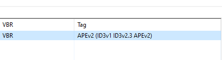

ginjaninja 605 Posted December 13, 2021 Posted December 13, 2021 19 minutes ago, Shai1 said: I actually went through and changed this one back in Emby to Jay-Z feat. Alicia Keys this weekend and then clicked the "Lock this item to prevent future changes" and went back in just now and checked it and Emby has already changed it back to Jay-Z;Alicia Keys? And this is after I clicked Lock it to prevent further changes after I made the change to it to put it back the way it is in the metadata? So changing it in Emby was useless and so was the Lock it button. fyi i would delete that file..there is a private message function on this forum when you click on a user... theres probably a few things going on here like getting to the bottom of rescanning whilst metadata is locked.. but it also is not going to help that you have multiple tag formats in your file assuming you have no need for this, i would configure mp3tag to remove all tag formats and write your single preferred tag format that all your apps/devices understand (i doubt you would have a problem with id3v2.3)..may not be the only issue but will help see the wood from the trees have sent you file back with just 2.3

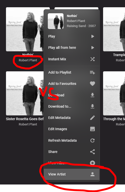

ginjaninja 605 Posted December 15, 2021 Posted December 15, 2021 (edited) just an idea @Luke maybe the artist field (showing A feat. B ie the plain string) could be stored separately to the track's artists. the 'view artist' ... command could cascade out to the full set of artists. I would love to see the connecting words like 'feat' (but not at the expense of the multiple artist understanding) . but would be happy with multiple artists not being directly clickable if wherever there is a track in the ui i can get to the individual artists....I think that may be a generally welcome improvement. (I am conscious that currently the "view artist" ... action makes only the first artist accessible) edit on reflection it perhaps is a little more important that track tiles show the track's artist rather than a 'plain artist string'. navigation would be made more cumbersome (if i had to use ... menu) but still more than doable and worth considering. A simpler compromise might be track tiles continue to show the (first of the) track's artists rather than the imagined 'plain string'. Edited December 15, 2021 by ginjaninja
