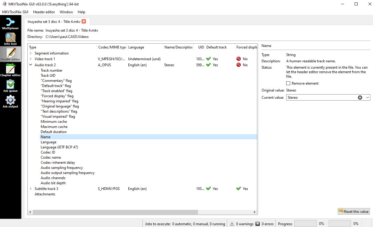

Ronstang 294 Posted December 2, 2021 Posted December 2, 2021 Only one problem Paul, I have a file open in MKVToolnix header editor because the second audio track is misidentified and I want to change that....but I cannot figure out how to edit anything. For me it appears it is acting as an "header viewer only". Any idea what I'm doing wrong?
pwhodges 2025 Posted December 2, 2021 Posted December 2, 2021 Click the chevron next to the track to open the drop-down of fields; highlight the field you want to edit; edit in the right-hand panel. Then from the top menu "Header editor / Save" to write back into the original file. Paul 1

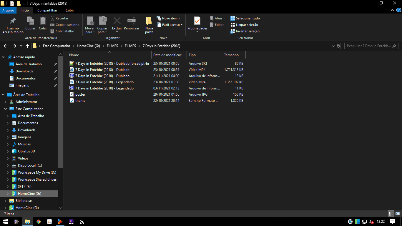

wagnermoreira1982 3 Posted December 2, 2021 Author Posted December 2, 2021 (edited) My files are all in mp4 and separated, dubbed and subtitled in the same folder shown in the images. So I asked what would be the way to always leave dubbed as the first option. Edited December 2, 2021 by wagnermoreira1982
rodainas 191 Posted December 2, 2021 Posted December 2, 2021 There is a misunderstanding, the problem is not dual audio as described on OP, but a multi-version scenario. Each client chooses the most compatible version by default, at the moment there is no option to control this. 1
