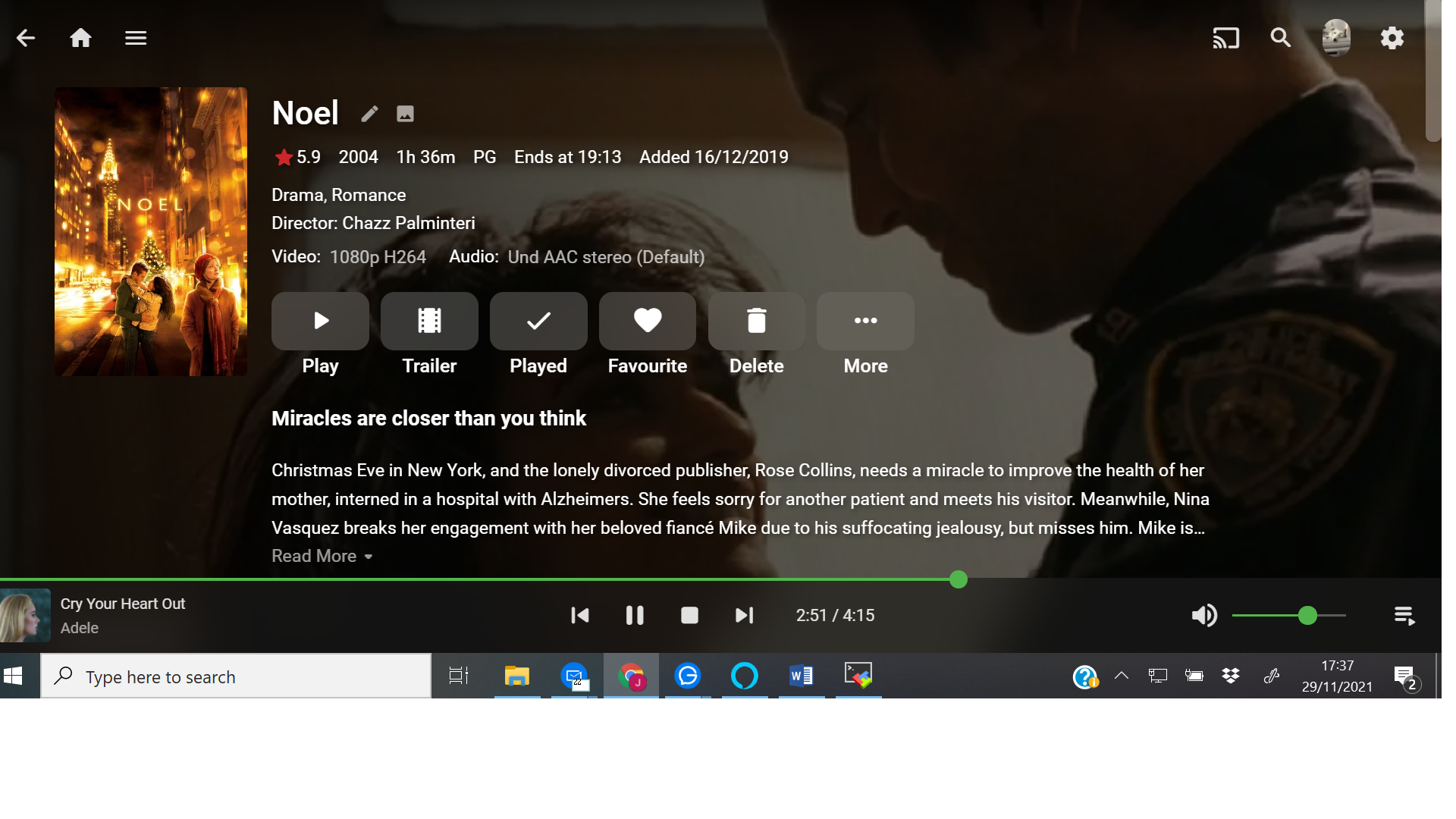

julianH1966 3 Posted November 29, 2021 Posted November 29, 2021 Hi All, Emby seems to be working ok, with a couple of issues. The library seems not to be updating correctly. I've checked the file system, here's a file I just added julianh@emby:/mnt/films$ ls -l Noel* total 1935744 -rwxrwxrwx 1 root root 55236 Nov 28 20:17 fanart.jpg -rwxrwxrwx 1 root root 1981156952 Dec 16 2019 'Noel (2004) WEBRip-1080p.mp4' -rwxrwxrwx 1 root root 6996 Nov 29 14:22 'Noel (2004) WEBRip-1080p.nfo' -rwxrwxrwx 1 root root 788299 Nov 28 20:17 poster.jpg julianh@emby:/mnt/films$ but it's not seen in the most recent movies. But if I search for it I can find it, but the date added is wrong, 2019, as you can see in the film-date screen shot. So it must be date / time Here's the response from the terminal session on the emby server; julianh@emby:~$ date Mon 29 Nov 17:38:57 UTC 2021 I also checked the date on the Virtual machine that send the file to it. julianh@importer:~$ date Mon Nov 29 17:40:17 UTC 2021 Here's a bit more on the Emby's time julianh@emby:~$ timedatectl status Local time: Mon 2021-11-29 17:44:59 UTC Universal time: Mon 2021-11-29 17:44:59 UTC RTC time: Mon 2021-11-29 17:44:59 Time zone: Etc/UTC (UTC, +0000) System clock synchronized: yes NTP service: active RTC in local TZ: no Here's a bit more on the Importer's time julianh@importer:~$ timedatectl status Local time: Mon 2021-11-29 17:46:00 UTC Universal time: Mon 2021-11-29 17:46:00 UTC RTC time: Mon 2021-11-29 17:46:00 Time zone: Etc/UTC (UTC, +0000) System clock synchronized: yes NTP service: active RTC in local TZ: no So I can see what's happening. For some reason the file's being added with the wrong date, which means it's not a "most recently added" in this case it's 2 years old. So in effect it's behaving correctly, but obviously it's not, the date added isn't correct. Any suggestions? Thanks Julian embyserver.txt
julianH1966 3 Posted November 29, 2021 Author Posted November 29, 2021 (edited) Solution. - Well it turned out not to be But interesting none the less. ------ I spotted it as I was writing the end of the topic, but thought I'd leave it here in case someone else has the problem. Sabnzbd wasn't changing the actual movie file, The rest, the .nfs, poster etc files were generated "now" but the actual media file kept the original date, not the "downloaded" date. There's an option in sabnzbd "ignore_unrar_dates" which "Normally unpacked files will get the date/time stamp they have in the archive. If you set this option, the files will get the date/time of unpacking." So the media file's date will be changed to the downloaded date. To change the date to "now" here's the command find /mnt/films/Noel\ \(2004\)/ -print -exec touch {} \; /mnt/films/Noel (2004)/ /mnt/films/Noel (2004)/fanart.jpg /mnt/films/Noel (2004)/Noel (2004) WEBRip-1080p.mp4 /mnt/films/Noel (2004)/Noel (2004) WEBRip-1080p.nfo /mnt/films/Noel (2004)/poster.jpg root@importer:/mnt/films# ls -l Noel\ \(2004\)/ total 1935744 -rwxrwxrwx 1 root root 1981156952 Nov 29 18:55 'Noel (2004) WEBRip-1080p.mp4' -rwxrwxrwx 1 root root 6996 Nov 29 18:55 'Noel (2004) WEBRip-1080p.nfo' -rwxrwxrwx 1 root root 55236 Nov 29 18:55 fanart.jpg -rwxrwxrwx 1 root root 788299 Nov 29 18:55 poster.jpg root@importer:/mnt/films# Problem solved. I hope it helps someone else Julian Edited November 29, 2021 by julianH1966
julianH1966 3 Posted November 29, 2021 Author Posted November 29, 2021 (edited) Okay. So that's not the solution, the libraries updating, but the latest isn't. I triggered Scheduled Tasks -> Scan media files. So I am stuck now, I just went to the library and selected "scan media Files" it'll take a couple of days, but it's haveing files added to it by Sabnzbd too. Is there anything I've missed? Thanks Julian Edit - The last file did work after all, the first test was when a file was half downloaded. I think this needs more time/ tests. The second file worked fine. I'll come back in a couple of days when a better test is done. sorry for the delay. - Julian Edited November 29, 2021 by julianH1966
