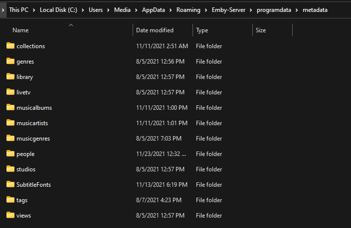

TugboatBill 16 Posted November 27, 2021 Author Posted November 27, 2021 I'm still working on this, but I've put aside the cert for now. I noticed that all my metadata is gone. NFOs and artwork are saved to the media folders. So I'm trying to set up a centralized metadata area. I created a share on my NAS and set it up in Library -> Advanced. The local path is to a mounted share which is the same share I used for the optional shared network folder for my clients. Perms on the mount folder in Ubuntu is 777. Below that Emby created folder metadata (emby:emby 755). Emby created a subfolder "views" w/same perms. In the log I see errors where it can't find folder "library/ etc" in metadata. I created "library" next to "views" w/same perms but that didn't help. log is attached. The dashboard shows the new location properly in Paths. embyserver.txt
Happy2Play 9800 Posted November 27, 2021 Posted November 27, 2021 34 minutes ago, TugboatBill said: I'm still working on this, but I've put aside the cert for now. I noticed that all my metadata is gone. NFOs and artwork are saved to the media folders. So I'm trying to set up a centralized metadata area. I created a share on my NAS and set it up in Library -> Advanced. The local path is to a mounted share which is the same share I used for the optional shared network folder for my clients. Perms on the mount folder in Ubuntu is 777. Below that Emby created folder metadata (emby:emby 755). Emby created a subfolder "views" w/same perms. In the log I see errors where it can't find folder "library/ etc" in metadata. I created "library" next to "views" w/same perms but that didn't help. log is attached. The dashboard shows the new location properly in Paths. embyserver.txt 107.06 kB · 0 downloads Sorry it does not work that way. It is either with media or not with media you can not have both. Sure there can be mixed depending on the options when you enable/disable library options and import media. But your log show Emby lookin in the custom path and not finding things. I assume they do not exist in that location. Quote System.IO.DirectoryNotFoundException: System.IO.DirectoryNotFoundException: Could not find a part of the path '/volume1/MediaMasterShare/Metadata/metadata/library/f5/f5e6a74766cf4a808ed1a49c5fe34705/poster.png'. The having both would fall under the precache feature request I believe
TugboatBill 16 Posted November 27, 2021 Author Posted November 27, 2021 So is the NFO the container for the metadata? Why does Metadata under Path on the Dashboard show /var/lib/emby/metadata? Is that a default that can be overwritten by the individual libraries? When I go into Emby on the new system (Home -> TV Shows) many of the series have no artwork. They do on the old system. Why is that? I can get them to display if I select an individual series and then refresh metadata.
FrostByte 5433 Posted November 27, 2021 Posted November 27, 2021 Did you enable "Download images in advance" in the library settings? Otherwise I think it won't download some of them until a client requests them. Try to check that option and then do a refresh including images
Happy2Play 9800 Posted November 27, 2021 Posted November 27, 2021 24 minutes ago, TugboatBill said: So is the NFO the container for the metadata? Why does Metadata under Path on the Dashboard show /var/lib/emby/metadata? Is that a default that can be overwritten by the individual libraries? When I go into Emby on the new system (Home -> TV Shows) many of the series have no artwork. They do on the old system. Why is that? I can get them to display if I select an individual series and then refresh metadata. Technically metadata path should only be changed at install. but /library is only used if you do not save images with media. All for bif files if you do not save with media, and if you chose to create Chapter images instead they are save there. Otherwise /library is not used. Metadata if not saved to NFO file only exists in the database. But relocating /Metadata affect more then just one folder. Since the database already has items in the default location you need to maintain the default location and new custom location for any new items added. Or you have to start over with custom paths set before any importing.
