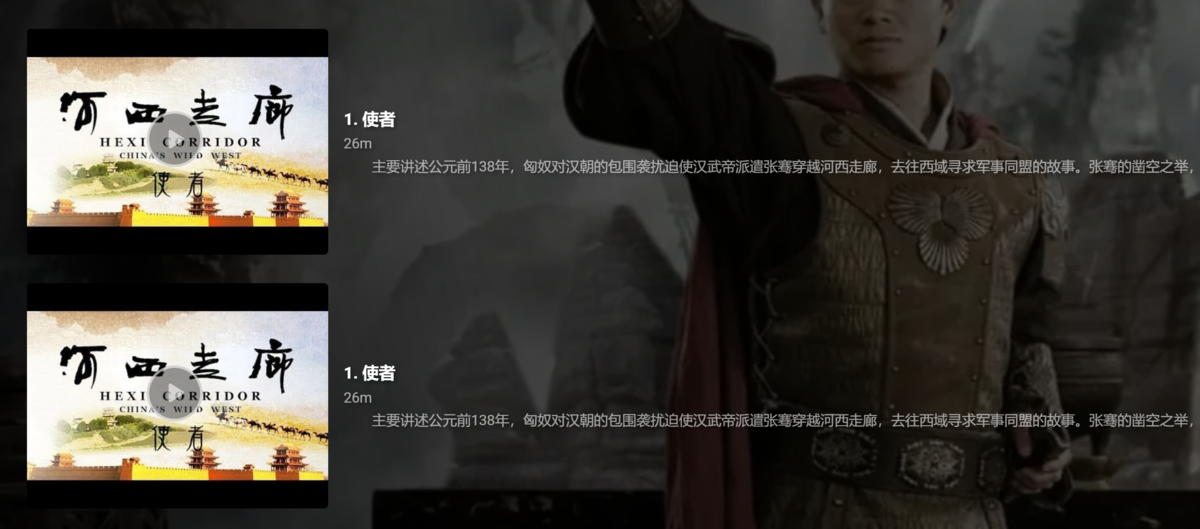

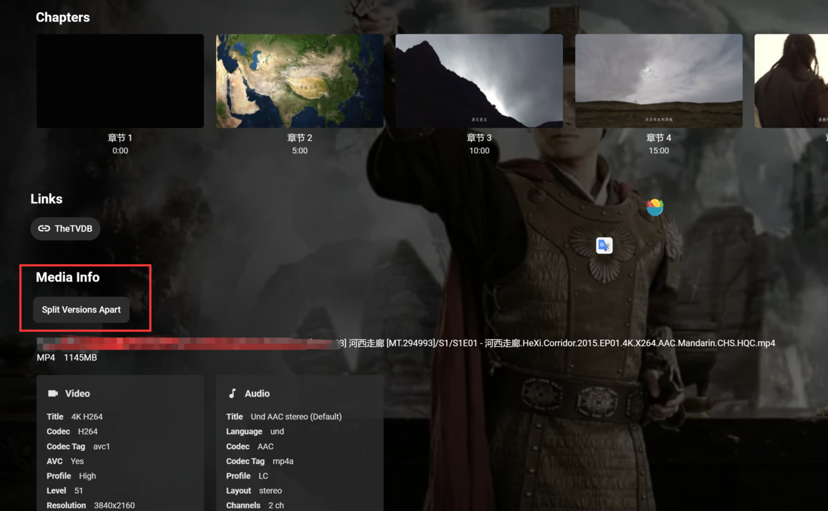

CentWind 4 Posted November 24, 2021 Posted November 24, 2021 If you have multiple files corresponding to one episode. You can name it like you do: SHOW NAME-S1E01-part1 SHOW NAME-S1E02-part2 Then, emby will recognize them as an episode. In the interface, you can find "Split Versions Apart" so that it can be separated. Pay attention to the naming, and then it will be sorted by file name. Now you will find that you have two first episodes. 1

CentWind 4 Posted November 24, 2021 Posted November 24, 2021 1 hour ago, mbarylski said: @CentWind When you split them apart do you need to manually update the metadata for those episodes and then lock the metadata? Have you tried this with a trakt.tv sync? Are you saying that you need to update metadata regularly? The method I'm talking about is just a method I found that can achieve the effect I need. I think this method is not officially recommended by emby. From my understanding, there is no need to manually update or lock the metadata. The two video files were identified as S1E01 at the beginning. This operation of spliting is just to make the two episodes directly appear in the interface, which seems to be different parts. The essence of this function is the same as that of the different versions in the movie. I am very sorry that my English is not very good, and some of the meanings may not be very accurate.

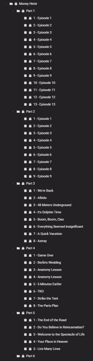

JoshuaAJones 68 Posted December 6, 2021 Posted December 6, 2021 (edited) We're all quite aware of how NF messed up the first season (outside of Spain). In order to get things back on track, I renamed the episodes like this: S01E01-part1 - Do as Planned S01E01-part2 - Do as Planned S01E02 - Lethal Negligence S01E03 - Misfire S01E04-part1 - Trojan Horse S01E04-part2 - Trojan Horse S01E05 - Groundhog Day S01E06-part1 - The Hot Cold War S01E06-part2 - The Hot Cold War S01E07 - Cool Instability S01E08-part1 - You Asked for It S01E08-part2 - You Asked for It S01E09 - Whoever Keeps Trying It, Gets It S01E10 - Masked No Longer S01E11 - The Head of the Plan S01E12 - A Matter of Efficiency S01E13-part1 - What Have We Done S01E13-part2 - What Have We Done S01E14-part1 - Against the Clock S01E14-part2 - Against the Clock S01E15-part1 - Bye Beautiful S01E15-part2 - Bye Beautiful This took care of the first 22 episodes and got Seasons 2 & 3 back on track and the episode descriptions tend to line up (-ish). I used episode length to arrange them. Not sure of a better way to get things sorted besides combining the episodes but I'd need to cut out the excessive credits to get it to flow better. Note: I do have to stop Part 1 after it finishes and select Part 2 to play to get this to work. It would be nice if file stacking worked for the TV shows but I'll manage. Edited December 7, 2021 by JoshuaAJones
rbjtech 5335 Posted December 6, 2021 Posted December 6, 2021 Either use the NF 'versions' and name accordingly (manually for Part1/2) or use the original versions with the automatic metadata. NF edited the Spanish show not only in episode length, but also content. They are not the same - so do not try and 'cross reference' them - it is not possible to accurately do this. I have the NF versions - so Part 1 & 2 do not have 'names' just Episode numbers - same as what's on NF.
JoshuaAJones 68 Posted December 7, 2021 Posted December 7, 2021 While I do see your point, automatic metadata will not work correctly, as people keep naming things in accordance with inferior sources (like iMDb). There are only 3 seasons of Money Heist, not 5 (or 6). I renamed my files to coincide with this so that Trakt would work for me. Others can do as they wish. People understand that all of TWD series have 2 parts but any other show that does the same becomes a different season (i.e. Sabrina). Personally, I use theTVDb for all of my TV scraping.
Happy2Play 9800 Posted December 7, 2021 Posted December 7, 2021 4 minutes ago, JoshuaAJones said: While I do see your point, automatic metadata will not work correctly, as people keep naming things in accordance with inferior sources (like iMDb). There are only 3 seasons of Money Heist, not 5 (or 6). I renamed my files to coincide with this so that Trakt would work for me. Others can do as they wish. People understand that all of TWD series have 2 parts but any other show that does the same becomes a different season (i.e. Sabrina). Personally, I use theTVDb for all of my TV scraping. Yes these are problematic as how each provider handles them differently. Emby does not yet support TMDB episode groups but you would appear to have this one. But TVDB and TMDB do not provide episode names in this case for this group of episodes. Money Heist (TV Series 2017-2021) - Seasons (edited version) (Digital) — The Movie Database (TMDB) (themoviedb.org) So in the end there will be manual work. Or users sharing then info they have for these specific series.
rbjtech 5335 Posted December 7, 2021 Posted December 7, 2021 (edited) 12 hours ago, JoshuaAJones said: While I do see your point, automatic metadata will not work correctly, as people keep naming things in accordance with inferior sources (like iMDb). There are only 3 seasons of Money Heist, not 5 (or 6). I renamed my files to coincide with this so that Trakt would work for me. Others can do as they wish. People understand that all of TWD series have 2 parts but any other show that does the same becomes a different season (i.e. Sabrina). Personally, I use theTVDb for all of my TV scraping. You can call the 'group' what you like - thus I have named them 'Parts' - to exactly match NF - that's why there are 6 of them. As far as I am concerned NONE of the metadata providers have data to match NF - so I did it all manually. Edited December 7, 2021 by rbjtech

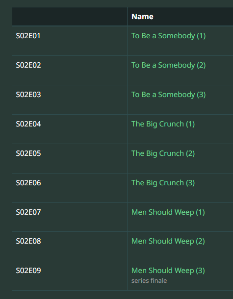

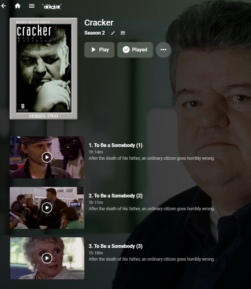

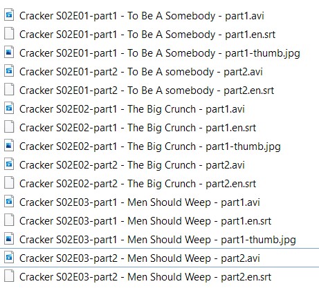

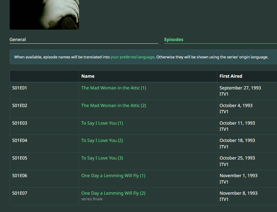

nospotify 186 Posted November 30, 2022 Posted November 30, 2022 Naming of mulit-part show episodes isn't working for me - attached are images of the actual file structure and naming, using 'part1, part2' as I believe properly reflects Emby's guidelines, followed by incorrect handling in Emby. How can this be fixed, so the three episodes, with two parts each, are all visible as well as correctly titled?
rbjtech 5335 Posted November 30, 2022 Posted November 30, 2022 (edited) If you have combined the parts, then you need to use the dvd order in metadata - otherwise it will just use the aired order - which was multiple parts. change to DVD ... then it will use this from thetvdb.com - in DVD order if you want to keep the multi-parts - then just name them correctly - (aired order) - again from thetvdb .. Cracker - TheTVDB.com Edited November 30, 2022 by rbjtech
pwhodges 2024 Posted November 30, 2022 Posted November 30, 2022 His problem's the opposite - the individual episodes are further broken up into two parts. I don't even know if that's meant to be supported for episodes as opposed to movies. As always, the best advice is to join the parts using MKVToolNix. In this case, the easiest way to get that to work for the subtitles as well will be to merge them in at the same time - that way the program knows the time offset to apply to the subs for the second part. Paul 1 1
rbjtech 5335 Posted November 30, 2022 Posted November 30, 2022 (edited) 6 minutes ago, pwhodges said: His problem's the opposite - the individual episodes are further broken up into two parts. I don't even know if that's meant to be supported for episodes as opposed to movies. As always, the best advice is to join the parts using MKVToolNix. In this case, the easiest way to get that to work for the subtitles as well will be to merge them in at the same time - that way the program knows the time offset to apply to the subs for the second part. Paul Hmm possibly - if somebody has taken a 3 part aired show and split into 2 parts - they really have screwed with things ! if that is the case - You are of course correct, then the only way to get correct metadata (automatically) is to merge into one file per episode - and use dvd order as I said above. Edited November 30, 2022 by rbjtech
