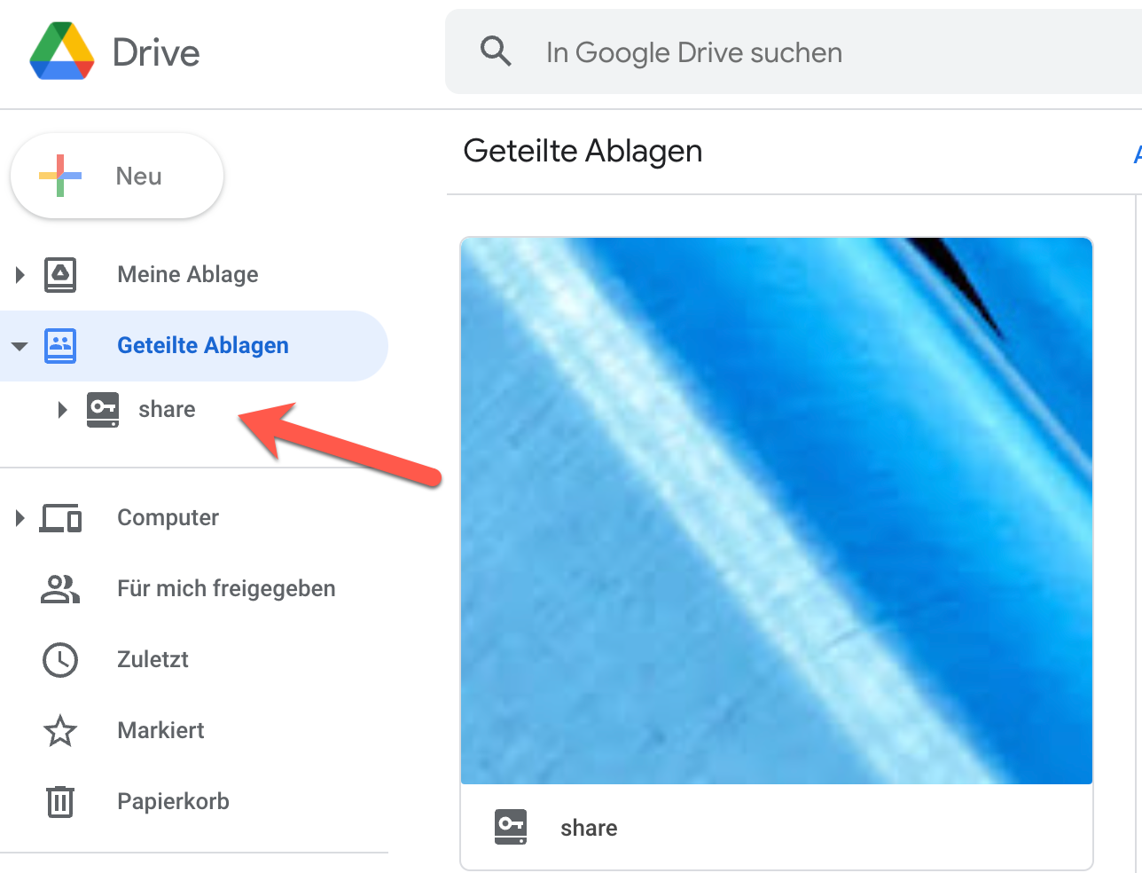

chris31077 0 Posted November 26, 2021 Author Posted November 26, 2021 Hello again, I tried it once more. This is the screen of my shared-Files. I am sorry for the German language . I would like to mount this folder "share" I used this command rclone mount gdrive: $HOME/mnt/gdrive/share --drive-shared-with-me --allow-other but this does not work 2021/11/26 18:08:34 Fatal error: failed to mount FUSE fs: mountpoint does not exist: /home/pi/mnt/gdrive/share Using this command rclone mount gdrive: $HOME/mnt/gdrive --drive-shared-with-me --allow-other Mounts only my share "Meine Ablage" in the screen. could you please let me know the right command?
rodainas 191 Posted November 26, 2021 Posted November 26, 2021 14 minutes ago, chris31077 said: Hello again, I tried it once more. This is the screen of my shared-Files. I am sorry for the German language . I would like to mount this folder "share" I used this command rclone mount gdrive: $HOME/mnt/gdrive/share --drive-shared-with-me --allow-other but this does not work 2021/11/26 18:08:34 Fatal error: failed to mount FUSE fs: mountpoint does not exist: /home/pi/mnt/gdrive/share Using this command rclone mount gdrive: $HOME/mnt/gdrive --drive-shared-with-me --allow-other Mounts only my share "Meine Ablage" in the screen. could you please let me know the right command? “Share” is a Team Drive (Shared Drive) So on the rlcone config you say yes when it asks if the remote is for a Team Drive and select it. Then on the mount command dont use —drive-shared-with-me.
