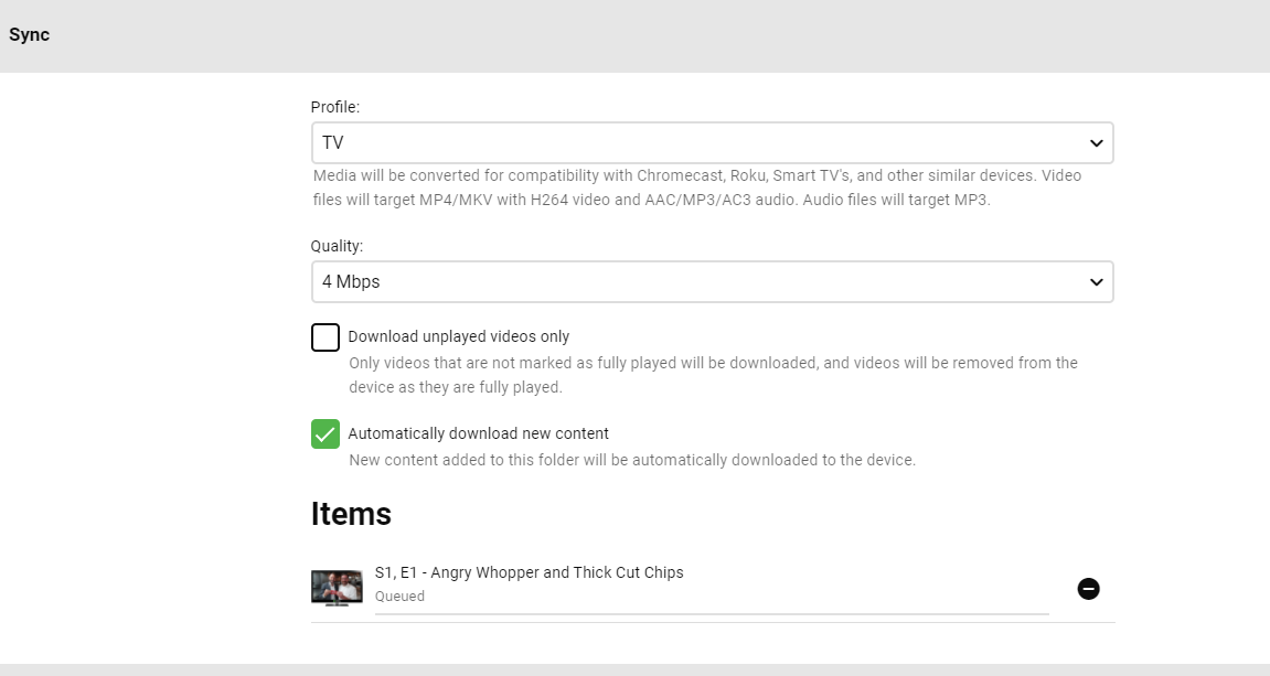

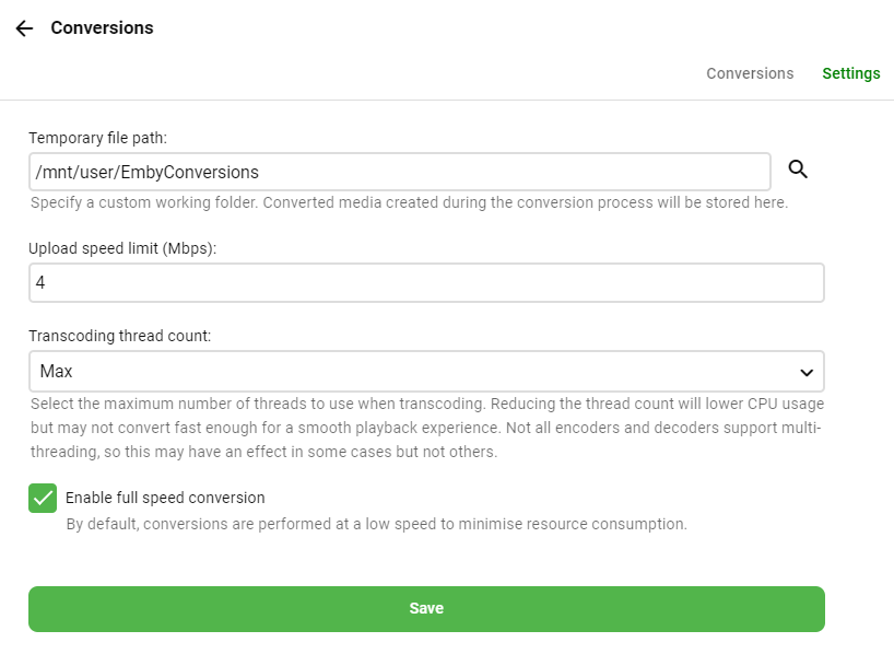

vaise 340 Posted December 5, 2021 Posted December 5, 2021 (edited) My ts files convert all fine. I have set it to replace the existing ones, TV format and 4Mbps. This is done as the admin user on the recordings folder from the web client. In my case, no other user has the security to do conversions. My conversions settings are set like this : Edited December 5, 2021 by vaise
