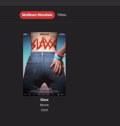

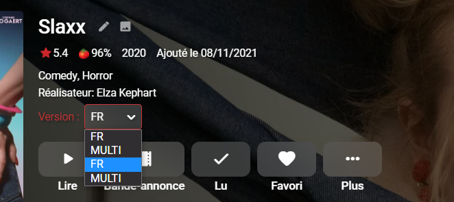

Nostromo86 17 Posted November 22, 2021 Posted November 22, 2021 Hello, Do you know why I have duplicate versions? There is a way to reindex the database cleanly View attachments thank you

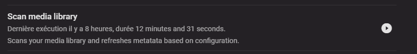

Luke 42197 Posted November 22, 2021 Posted November 22, 2021 Hi, that's strange. Try running a library scan and see if that helps.
Nostromo86 17 Posted November 22, 2021 Author Posted November 22, 2021 (edited) 21 minutes ago, Luke said: Hi, that's strange. Try running a library scan and see if that helps. Hi, Thanks Mhmm ok but you talk about Scan media library ? view attachments Because the scan is done every 12 hours the problem has been there for 2 weeks Edited November 22, 2021 by Nostromo86

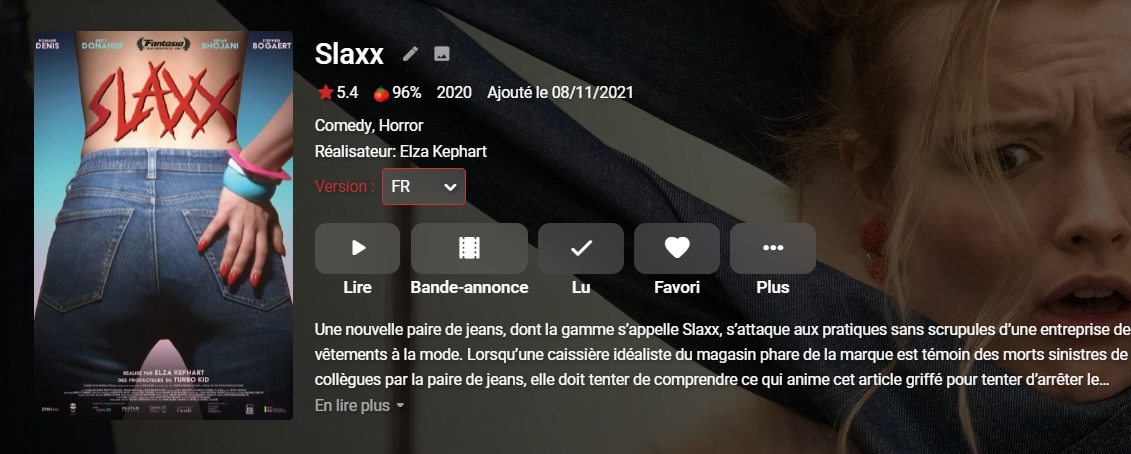

Carlo 4561 Posted November 23, 2021 Posted November 23, 2021 Hi, what does it show you at the bottom of the detail screen for these 4? Are the paths duplicated or do they point to different locations? How many of your movies are like this? Try doing a search of your movie library for one of those episode (complete file name) to make sure there is only one version. Let us know what you find.

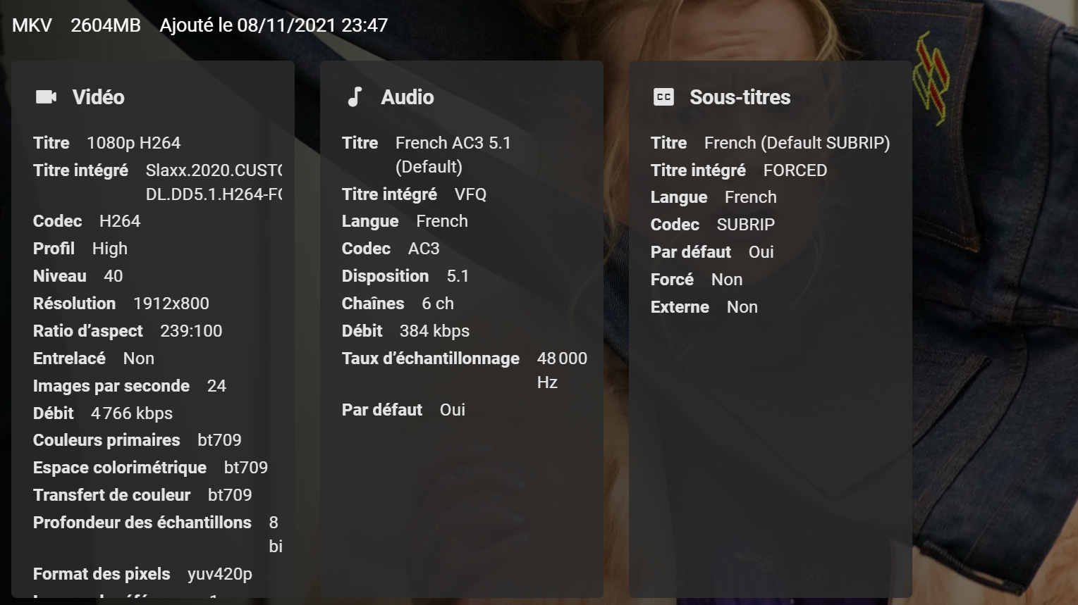

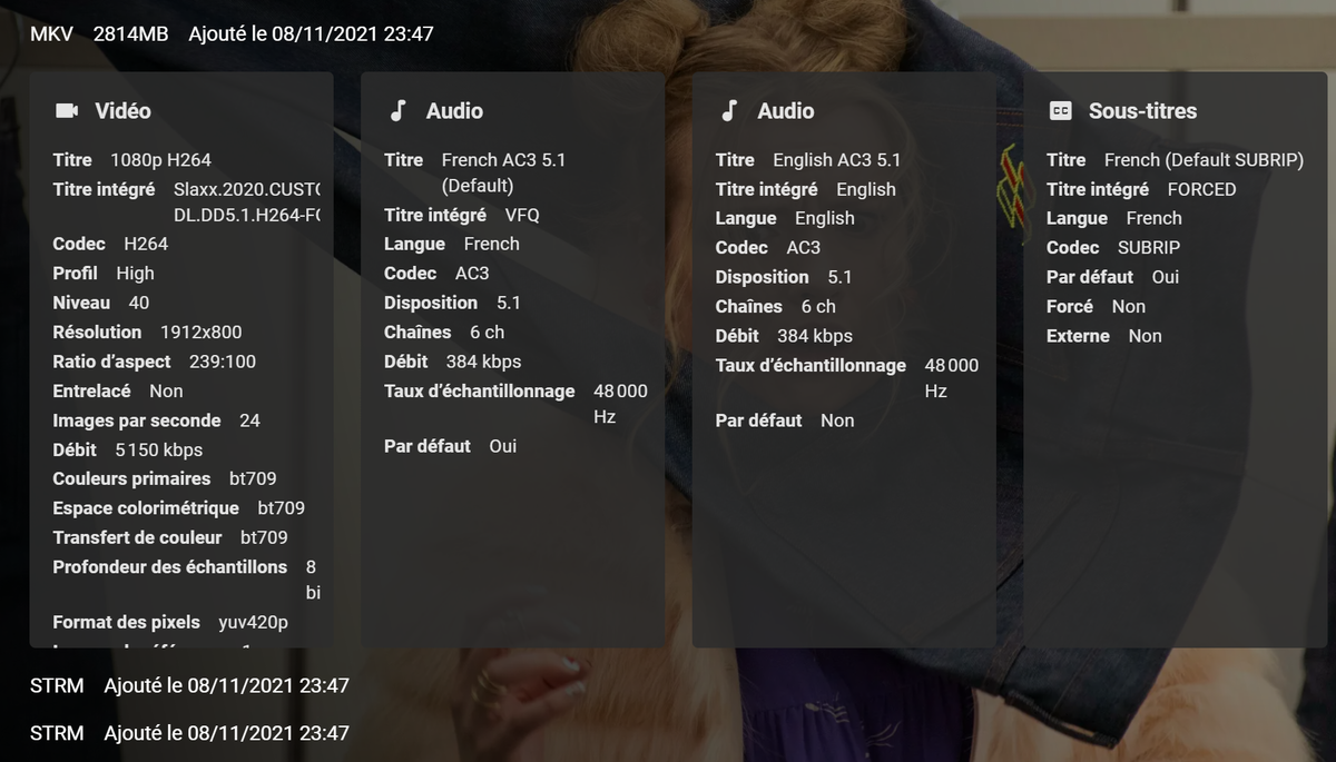

Nostromo86 17 Posted November 23, 2021 Author Posted November 23, 2021 39 minutes ago, cayars said: Hi, what does it show you at the bottom of the detail screen for these 4? Are the paths duplicated or do they point to different locations? How many of your movies are like this? Try doing a search of your movie library for one of those episode (complete file name) to make sure there is only one version. Let us know what you find. Hi, I don't know how many films are affected because I have 20,000 If I search, I can see that a movie I have only 2 strm See the attachments for the answers to your questions
Happy2Play 9802 Posted November 23, 2021 Posted November 23, 2021 But that image shows 4 versions, 2 mkv files and 2 strm files even if there are only 2 strm files in the folder. Have not tested multi-versioning strm files but I know the UI no longer shows strm files for a individual item once it has metadata. Will have to do some testing when I get a chance.
Nostromo86 17 Posted November 23, 2021 Author Posted November 23, 2021 5 minutes ago, Happy2Play said: Mais cette image montre 4 versions , 2 fichiers mkv et 2 fichiers strm même s'il n'y a que 2 fichiers strm dans le dossier. Je n'ai pas testé les fichiers strm multi-versions, mais je sais que l'interface utilisateur n'affiche plus les fichiers strm pour un élément individuel une fois qu'il contient des métadonnées. Faudra faire des tests quand j'en aurai l'occasion. Yes the MKV files are my strm files. i have only strm files on my server and all its okay, just few movie with duplicate files
Carlo 4561 Posted November 23, 2021 Posted November 23, 2021 Hi, can you show us what the folder structure looks like for that movie? Would you mind doing a test for me? Move that movie folder out of the library and perform a full library scan. Us the button at the on the right side from the Library menu. Now do a search for that move. Does anything show up? Now go to scheduled tasks and run the rotate log job and make sure Enable Debug Logging is off. Go back and run a full library scan again. Grab a copy of the server log at this point to upload. Navigate back to this movie again. Does it still show 2 of both or just 1? If still a problem please upload the server log with the full library scan as well as the two NFO files and the pic of the folder. Thanks

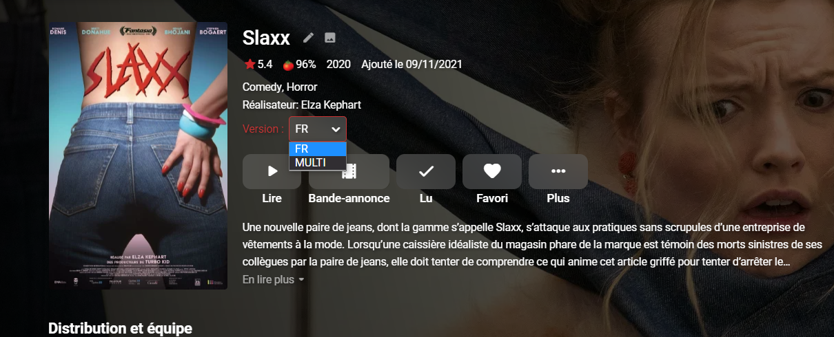

Happy2Play 9802 Posted November 23, 2021 Posted November 23, 2021 Does this happen on other media? I have not been able to reproduce this. STRM files that show media info do not show strm also. Can you remove the media, scan the library, verify with search the media has been removed, then re-add the media. Do you get the same results?
Nostromo86 17 Posted November 24, 2021 Author Posted November 24, 2021 14 hours ago, Happy2Play said: Does this happen on other media? I have not been able to reproduce this. STRM files that show media info do not show strm also. Can you remove the media, scan the library, verify with search the media has been removed, then re-add the media. Do you get the same results? Hi, I did what you said ans its good see attchments But i have 20000 movies, and i dont know what file is affected if I move my entire film folder, it will take 24 hours to rescan everything
