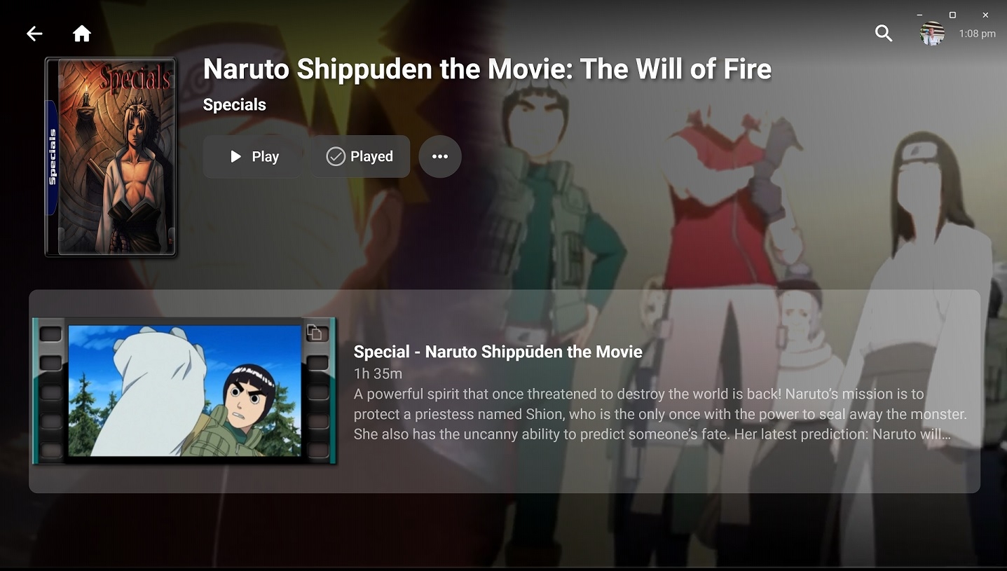

GrimReaper 4926 Posted December 22, 2021 Posted December 22, 2021 (edited) Something is off with your library setup, your screen shows "Naruto Shippuden the Movie: The Will of fire" as a title, not as a "Naruto Shippuden" TV Show as it should, and it also lacks Shuffle button that would show if it was Specials season. What library type you have there? What paths you entered? Edited December 22, 2021 by GrimReaper Typo
miniliQuid 95 Posted December 22, 2021 Author Posted December 22, 2021 5 hours ago, pwhodges said: I'm not clear from that whether your specials are or are not in a single folder, but your following image looks fine. With all the specials in a single folder called "Specials", I have never had a problem with TVDB failing to recognise them. The only suggestion I have is to try removing the "(2007)" from the file names, as TVDB isn't requiring that. Paul It's all in 1 folder, they way it is shown on the image (which is why I got confused it wasn't working). Will see if that helps if grimreaper his advise doesn't help. 5 hours ago, GrimReaper said: Something is off with your library setup, your screen shows "Naruto Shippuden the Movie: The Will of fire" as a title, not as a "Naruto Shippuden" TV Show as it should, and it also lacks Shuffle button that would show if it was Specials season. What library type you have there? What paths you entered? I don't think it is the library path since most shows seem to work fine. However you pointing that out made me notice the ones that have issues seem to have been identified wrong. Trying to manually identify those and refreshing the metadata, hoping that fixes it Thanks for the advise you 2!
miniliQuid 95 Posted December 23, 2021 Author Posted December 23, 2021 Jikes, none of the above changed anything. Been trying things since yesterday but something in my naming sequence must be off. For now I was able to solve it by simply splitting the episodes manually and then changing the metadata manually. However if someone can provide me a screenshot of there specials set up that works when identified automatically, that would be great. Might wanna change mine in case I ever need to remake the library in the future, automation is always better Anyway this is what happened for me, it just says every special episode is season 0 episode 0, even when they have obvious episodes named. So they get all packed together under the first video, but splitting them and renaming them helped. PS: in the picture below I had decided before starting manually that perhaps taking the names straight from TVDB might help, but even that didn't change anything.

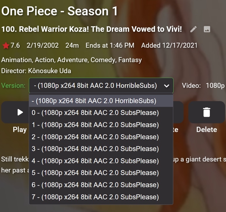

miniliQuid 95 Posted January 28, 2022 Author Posted January 28, 2022 As shown below, without titles things work fine as was suggested (without the title there are no title numbers to be confused with the episode number). However as soon as a show (tested it on another one besides one piece as well to be sure) goes above 999, the system still gets broken. But in this case it just adds all of the 1000 and higher episodes as versions under episode 100. This time however it is without titles in the file name as shown in the images below.
Luke 42289 Posted April 24, 2022 Posted April 24, 2022 On 1/28/2022 at 7:30 AM, miniliQuid said: As shown below, without titles things work fine as was suggested (without the title there are no title numbers to be confused with the episode number). However as soon as a show (tested it on another one besides one piece as well to be sure) goes above 999, the system still gets broken. But in this case it just adds all of the 1000 and higher episodes as versions under episode 100. This time however it is without titles in the file name as shown in the images below. Hi, yes this is something that we're going to have to review but it's happening because the episode detection is trying to avoid years in file names being interpreted as episode numbers.
Luke 42289 Posted April 27, 2022 Posted April 27, 2022 OK I've got these solved, at least for your file name examples. The changes are unlikely to be included in 4.7 as they come with some risk, but some time after that once it's spent a little time on the beta channel. 1
miniliQuid 95 Posted April 29, 2022 Author Posted April 29, 2022 On 4/27/2022 at 2:18 AM, Luke said: OK I've got these solved, at least for your file name examples. The changes are unlikely to be included in 4.7 as they come with some risk, but some time after that once it's spent a little time on the beta channel. Awesome! Thanks for that. Anyway I'd rather have it tested thoroughly than come with other issues, so no need to hurry on this. Currently the work around seems to work perfectly fine so far which is simply not having the titles in the files. Haven't seen any issues since I removed the titles, so I hope it stays that way Any solutions for the episodes past 999? Cause so far I have come up empty handed with any solutions to deal with those for the time being Anyway thanks for the update and the hard work!
