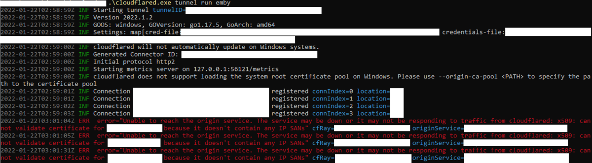

dr024 1 Posted January 22, 2022 Posted January 22, 2022 I also have TMHI and had pretty much given up on trying to accomplish certain things from my home network. I am just getting started with Emby in the last 24 hrs. I stumbled across it as a potential solution to my Kodi library failing to scan/update new files and add them to the library. Emby was relatively easy to setup and use as a solution to my library challenge. This led me to want to use Emby for more then just doing the heavy lifting for library/metadata management. I want to be able to use Emby to access my media from outside my network. While researching that, I came across several posts in these forums referencing CloudFlared/Argo Tunnel to accomplish this with TMHI as your ISP. i tried following the guidance and piecing together the ingredients to this particular recipe with some progress but ultimately no success. I already had/have a domain name and account (free) with cloudflare. So essentially i started with On 11/21/2021 at 2:25 PM, cayars said: configure Cloudflare with the specific settings needed to work with Emby Server and not abuse their services. To configure these items i followed the best practice guide i found on the forum for cloudflare and emby by @pir8radio I then moved onto On 11/21/2021 at 2:25 PM, cayars said: you will need like A and CNAME records but we will handle the "emby" sub domain programmatically so don't set anything up specifically for Emby use. These are my current DNS A records in the cloudflare dashboard. i imagine this should suffice if I interpret what i read accurately. On 11/21/2021 at 2:25 PM, cayars said: At this point you can get your own domain certificate from a 3rd party like Let's Encrypt or use a private cert directly from Cloudflare (what I do). We have to convert this cert to the pk12 format Emby needs and install this in Emby. I completed this using a cert from coudflare and converted the cert to the format Emby needs and pointed Emby to the cert in the settings. On 11/21/2021 at 2:25 PM, cayars said: Up until this point you are basically doing the same thing anyone would do setting up Emby for Cloudflare use. Now the fun/tricky part and it's a wee bit different depending on OS platform is setting up an Argo Tunnel. This used to be a paid only feature but they opened it up to free accounts as well (hence me starting to play with it). Emby Server is running on an Nvidia Shield, if i understood correctly cloudflared doesnt need to be running on this device just another device on my network. in which case i opted for my windows desktop that is always on. Is my logic accurate? On 11/21/2021 at 2:25 PM, cayars said: This tunnel is created using a single piece of software called cloudflared which is a CLI (command line only tool) that is used to establish an encrypted connection from your Emby Server machine to the Cloudflare Edge network. There are 5 steps to this but for Emby use I've got pretty much "cut and paste" instructions. These steps include getting authorized by Cloudflare (you do this from the CF dashboard), setting up PEM certs (used between you and CF), setting up the actual tunnel, configuring the tunnel for services (ie https, web sockets & SSH) and port, joining this to a location, creating a special DNS record with PEM cert associated with it (used by tunnel) and giving it a name such as "emby". Now you just start the tunnel and if done correctly you will be able to open a web browser or any Emby app and type in emby.your_domain.ext and it will work. At this point you just set this up so your computer establish the tunnel every time you restart the computer. On windows I create a service to start automatically so you don't have to do anything. After that long process it just works. You do not need to open any ports on your router so this is actually a good solution for anyone! The only way into your network is going through Cloudflare which is setup to only allow secured ports 443 and web socket access. If your ISP gives you a different WAN IP every single day it also wouldn't matter to you either because your computer always initializes the tunnel with an outgoing connection. You could use this on a notebook, walk over to your neighbors with a different IP and it starts working again. Once setup it just works! i went through the install process, authenticated, created the tunnel, created the config files and since it was for an application i used this format for the config file url: http://emby In-Home (LAN) access:8920 tunnel: <Tunnel-UUID> credentials-file: ~\downloads\.clouflared\credentialsfile.json I started routing the traffic and that added had a cname record to my domain that i named emby When i started the tunnel it appears to start but then errors out as pictured below. Despite error tunnel appears to still be running. when i try to access emby files at emby.mydomain.ext from my tablet on lte in i get the following error. It seems apparent i made some mistakes in going through this process. I appreciate anyone who took the time to read thru the whole post. I also appreciate any clarity or guidance. Best Regards. J
Carlo 4561 Posted January 22, 2022 Posted January 22, 2022 Looks like you're close but with those errors it will not work. Is this a running on windows? If so, send me a private message so we can expand on your setup a bit without having it in public. If you prefer I could do a remote session with you and get you setup. Carlo

dr024 1 Posted January 22, 2022 Posted January 22, 2022 @cayars The Emby server is running on an Nvidia shield. the cloudlfared items are running on a windows box. Ill send you a PM shortly. @upssnowman i came across zerotier as an option whilest researching and deploying this setup. ZT sounds promising and isnt off the table completely. Quite the opposite, I will be looking at deploying ZT once i can get this CF solution configured and tested. that will give me a baseline to measure against and make an informed decision about which solution i need for my use case. I just happened to be eating the CF sandwhich first, im going to try and finish it before i start biting into ZT. 1

Carlo 4561 Posted January 22, 2022 Posted January 22, 2022 3 hours ago, dr024 said: @cayars The Emby server is running on an Nvidia shield. the cloudlfared items are running on a windows box. Ill send you a PM shortly. @upssnowman i came across zerotier as an option whilest researching and deploying this setup. ZT sounds promising and isnt off the table completely. Quite the opposite, I will be looking at deploying ZT once i can get this CF solution configured and tested. that will give me a baseline to measure against and make an informed decision about which solution i need for my use case. I just happened to be eating the CF sandwhich first, im going to try and finish it before i start biting into ZT. The PC would have to be left on 24/7 for that to work. Nothing wrong with that but if you do this you would be far better off moving the Server to the PC as well. Is this something we could do? 1
dr024 1 Posted January 23, 2022 Posted January 23, 2022 @cayars Thank you for the help earlier. I am glad it wasn't a complex fix. The time and effort are greatly appreciated. I am going to let this simmer for about a week and I'll PM you.
Carlo 4561 Posted January 24, 2022 Posted January 24, 2022 You were so close. You had everything setup perfectly except the config file. Even that was darn close but has mixed formats in in thanks to the way they do samples (all over the place). I know how frustrating things of that nature can be. I just happened to know the ingress format they wanted since you were routing to another machine. Don't ask how long it took me to figure out. You may want to keep things like they are now. I was just commenting that if you had to leave the PC on for the tunnel it may make sense to just use that for Emby as well. BTW, see if you have an old PC or notebook not being used. A Notebook could be setup with the tunnel running on it which is low powered. You could actually run that from a thumb drive with a headless Linux server even. 1
