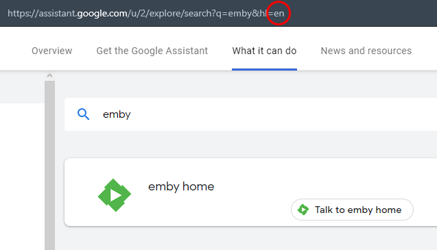

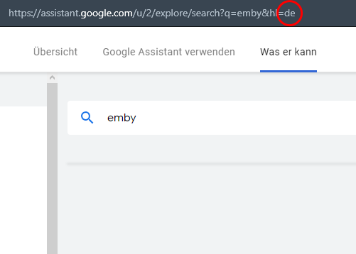

chaank 0 Posted February 2, 2022 Posted February 2, 2022 In addition to what I wrote before: When searching for "Emby" on the assistant website from Google, there's a search result in the english version but not in the german version - see images.
Luke 42289 Posted March 1, 2022 Posted March 1, 2022 On 2/2/2022 at 6:32 AM, chaank said: In addition to what I wrote before: When searching for "Emby" on the assistant website from Google, there's a search result in the english version but not in the german version - see images. Hi, yes we are working on adding additional language support. Thanks for the feedback.
