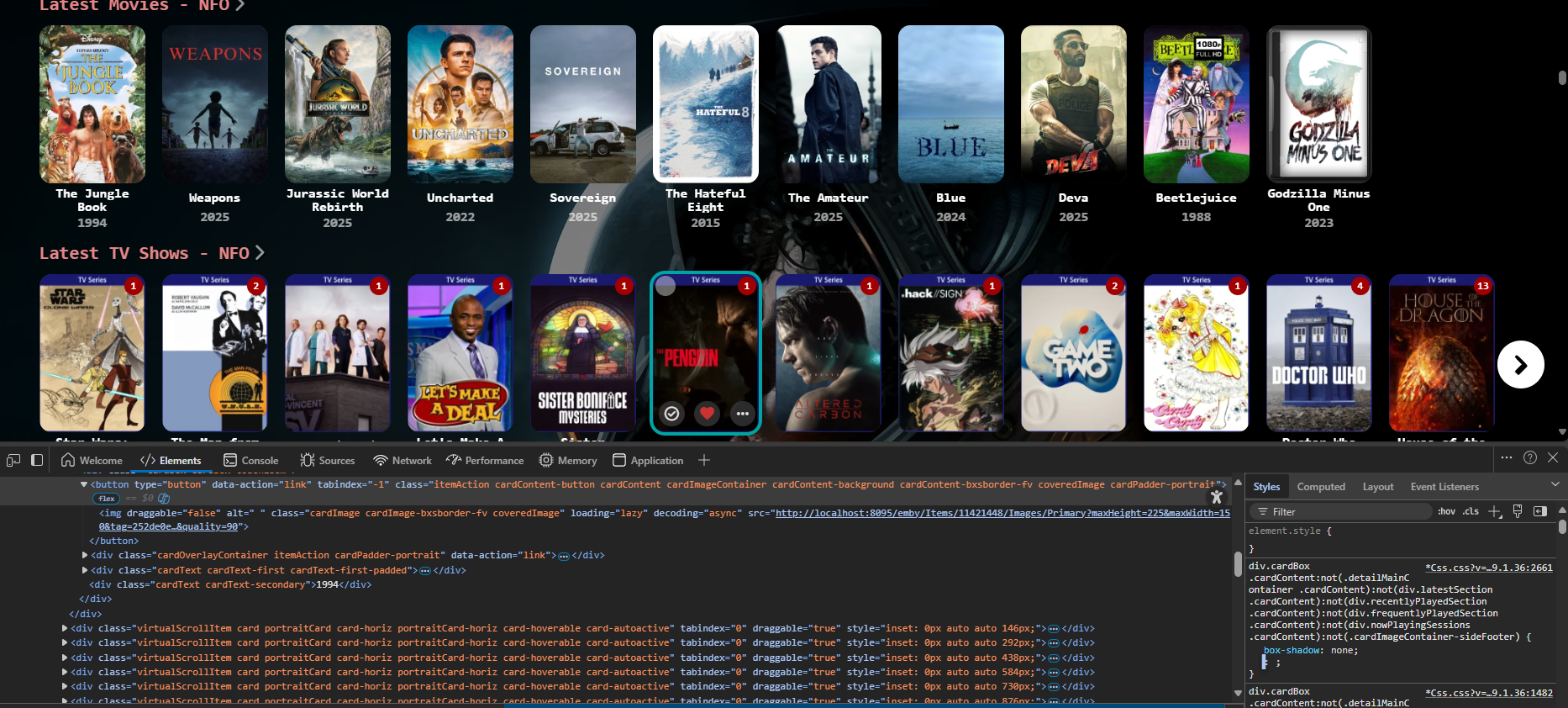

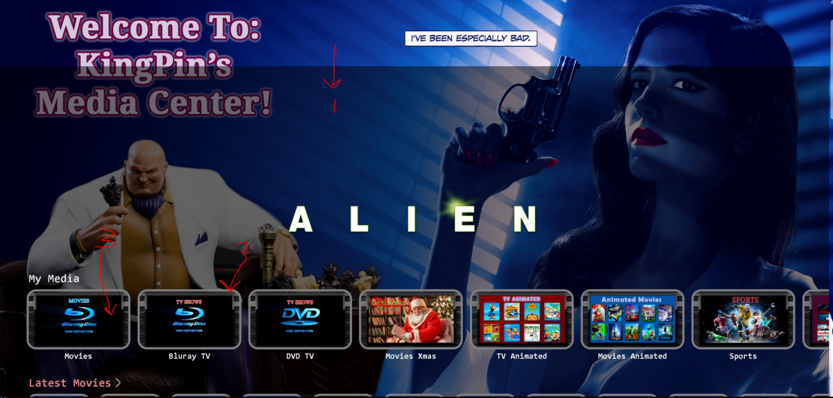

Happy2Play 9811 Posted October 7, 2025 Posted October 7, 2025 (edited) 1 hour ago, arrbee99 said: As you can tell, I rely a lot on Happ2Play, so I never know what to use with units - pixels, percentages, ems, whatever. Full screen for me 1 hour ago, King Pin said: 1- I want to get rid of the black tint that is over the home page. 1 hour ago, King Pin said: /* Move down to make space for backdrop and logo - Home and Favourites */ div.view-home-home .verticalSections { position: relative; top: 16em; background: rgba(0, 0, 0, 0.5); } change background to none 1 hour ago, King Pin said: 2 - I'd like to totally remove the grey border around all media. Hmm looks like a lot of redundant code here in triplicate But needs added I guess to all unless redundant code is removed. Quote div.cardBox .cardContent:not(.detailMainContainer .cardContent):not(div.latestSection .cardContent):not(div.recentlyPlayedSection .cardContent):not(div.frequentlyPlayedSection .cardContent):not(div.nowPlayingSessions .cardContent):not(.cardImageContainer-sideFooter):not(div.homeSectionsContainer div.scrollSlider div:nth-child(1) div.flex-direction-row div.itemsContainer div div button) 1 hour ago, King Pin said: 3 - Resize "My Media" images. If you can tell me the line I can fiddle around to size it properly. edit: I already have it set to extra small in the options. Not in this custom code so you look at default Card code and may need targeted pretty sure there are other topics on this one. 1 hour ago, King Pin said: 4. The "alpha picker" I think it's called that goes vertically down the screen (#-Z) I need to resize that also. lol lots of dups but the font-size Things are getting harder again as specific targets are getting to be to generic. Edited October 7, 2025 by Happy2Play

Happy2Play 9811 Posted October 7, 2025 Posted October 7, 2025 Just now, arrbee99 said: Dare I say 'Hopefully' to get rid of grey border round stuff search for - box-shadow: 0 0 0 4px #808080; and get rid of (or comment out before you get rid of...) Yes I miss read and wanted all media and from only my media. Remove this three times. Quote div.cardBox .cardContent:not(.detailMainContainer .cardContent):not(div.latestSection .cardContent):not(div.recentlyPlayedSection .cardContent):not(div.frequentlyPlayedSection .cardContent):not(div.nowPlayingSessions .cardContent):not(.cardImageContainer-sideFooter) { box-shadow: 0 0 0 4px #808080; }

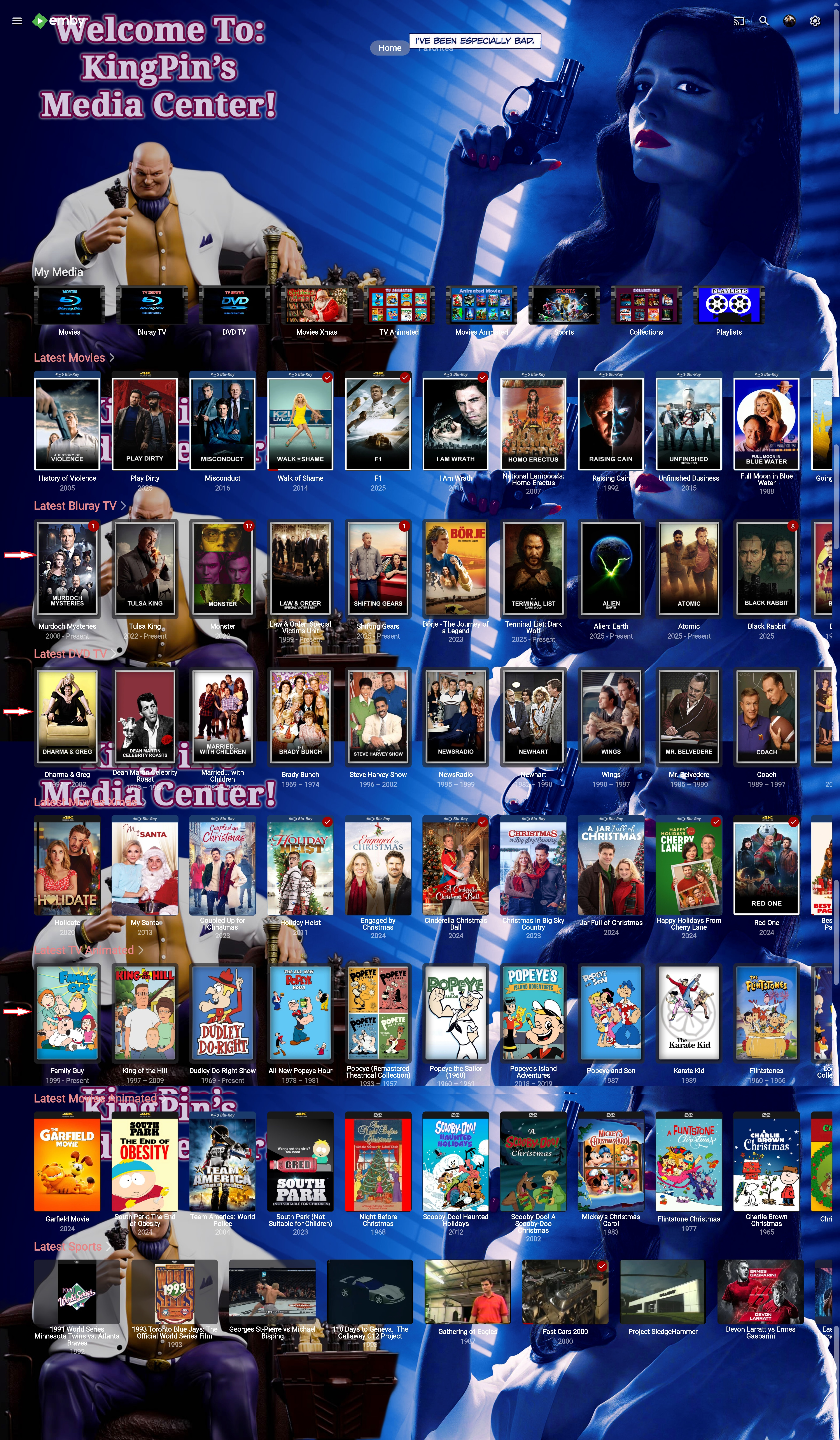

King Pin 34 Posted October 7, 2025 Posted October 7, 2025 @Happy2Play oops I meant the smokey background, not sure how to explain it. The shadow/haze that covers the background. It's #1 on the image. I appreciate the help folks. I will take a look at all this later on today. Thanks @arrbee99
King Pin 34 Posted October 7, 2025 Posted October 7, 2025 (edited) Everyone that has been mentioned has worked so far so thank you very much. Except one weird thing. There is still that grey border only on the homepage and only on a few rows. You can see the rows marked with the red & white arrow on the left hand side. Edited October 7, 2025 by King Pin
Happy2Play 9811 Posted October 7, 2025 Posted October 7, 2025 2 hours ago, King Pin said: There is still that grey border only on the homepage and only on a few rows. Did you remove this or change them to box-shadow:none;? Note arrbee99 code has it listed like three times as mentioned and shown in screenshot. Quote div.cardBox .cardContent:not(.detailMainContainer .cardContent):not(div.latestSection .cardContent):not(div.recentlyPlayedSection .cardContent):not(div.frequentlyPlayedSection .cardContent):not(div.nowPlayingSessions .cardContent):not(.cardImageContainer-sideFooter) { box-shadow: 0 0 0 4px #808080; } 1

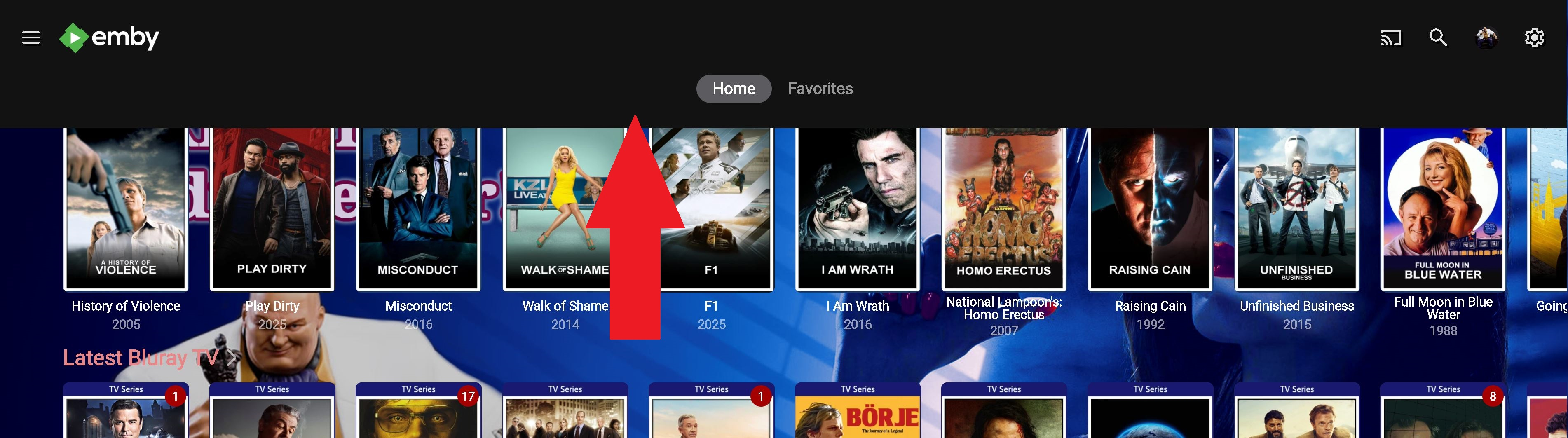

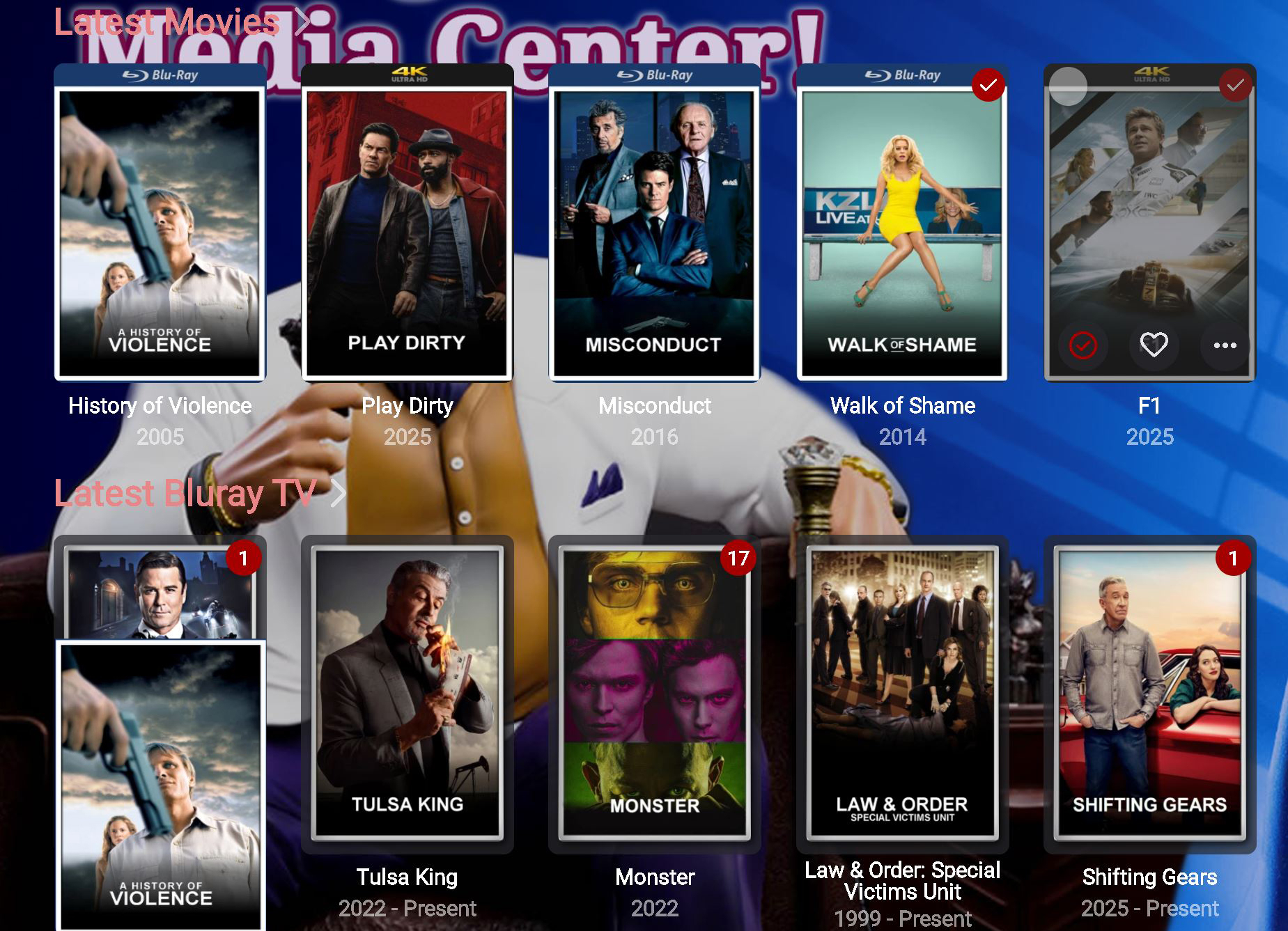

King Pin 34 Posted October 8, 2025 Posted October 8, 2025 I figured it out. After noticing there was a size difference between Movie and TV posters I checked my CoverArt Plugin and somehow it was only workin for movie folders. If you notice in the image the size difference and lack of coverart for the second row of posters? Well I added the Coverart to tv posters and all is good now. After a lot of messing around I think I have everything back to where I like it. Except one thing as shown in the second image. Can the height of this black area be reduced and the "Home Favorites" buttons are moved to the top ? 1
