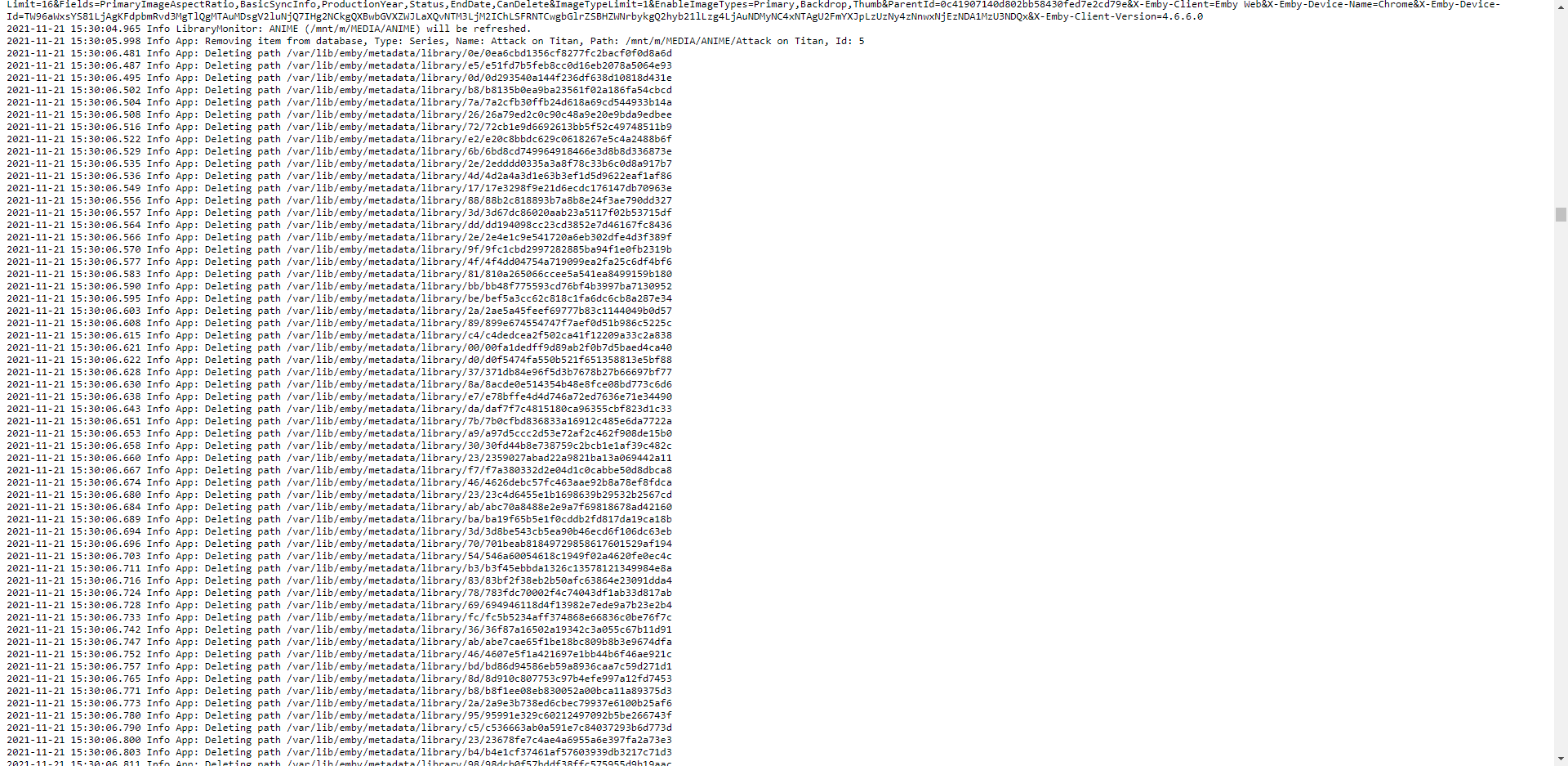

mw420blazeit 2 Posted November 21, 2021 Author Posted November 21, 2021 I did everything which was mentioned in this thread 9 hours ago, Happy2Play said: If you are not saving nfo and images with media then you would have to shut down Emby and manually update Path for this library and items, and maybe other columns depending on your setup. Similar to this as it is a little dated, as TypedBaseItems is obsolete. everything was working as intended and i was happy but emby started scanning the library on its own and decided that all the metadata needs to be deleted
Happy2Play 9812 Posted November 21, 2021 Posted November 21, 2021 Correct as all the database entries have moved so they are now no longer valid and re-added from the new location. If you have nfo and images with media then you have nothing to worry about. Otherwise you have to do what I said above.
