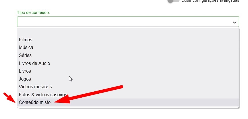

I need to make a mixed library, with videos and audios, will be of COURSES classes.
The problem is that the audios don't appear. Only videos appear.

Hi, I don't understand your question. The gallery I created was of mixed content.
The audio and video files are in the same folder
What could I do to make the audio files appear in the gallery? only video files appear in the gallery.

and then experiment a bit with different library content types: Mixed content, Music Videos, Home Videos, adding those folders separately as library paths in Library setup (+):

Edit: Just did a quick test with Mixed-content type library, getting both audio and video files to show in Folder view with any library path setup, as long as you keep them separated in per-type subfolder:
