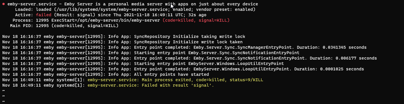

marciomaiden 3 Posted November 18, 2021 Author Posted November 18, 2021 The service stops and I can't access it. Neither by browser nor by apps. I have to do an emby-service restart to be able to access the service again
marciomaiden 3 Posted November 18, 2021 Author Posted November 18, 2021 As you can see on the picture

Q-Droid 1011 Posted November 20, 2021 Posted November 20, 2021 Signal 9/KILL is a deliberate kill, not sign of a crash. You didn't post any details about your server so check the syslog and look for signs of memory exhaustion and oom killer or other activity killing processes.
marciomaiden 3 Posted November 20, 2021 Author Posted November 20, 2021 53 minutes ago, Q-Droid said: Signal 9/KILL is a deliberate kill, not sign of a crash. You didn't post any details about your server so check the syslog and look for signs of memory exhaustion and oom killer or other activity killing processes. You're right. I attach the server specifications. The point is that this problem only started happening with 2 or 3 versions, it always worked well. I think the problem is with Ubuntu's oom, it seems to me. I don't have much experience with servers.
Q-Droid 1011 Posted November 20, 2021 Posted November 20, 2021 Software in general isn't known for getting smaller and more efficient with each release... Emby on your server might have been just below the threshold of memory usage and the latest update pushed it over the edge. If you can try it then another GB of RAM might get things back on track. 1
