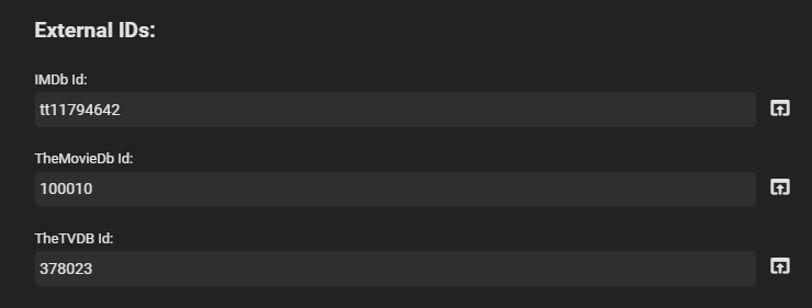

nuentes 41 Posted November 16, 2021 Posted November 16, 2021 (edited) I have this issue with essentially 2 shows. On my server, I have the following 4 shows that are affected: The Office The Office Superfan Episodes Mythbusters Mythbusters Streamlined For each of the non-standard versions, I essentially removed The Office from my scan folder, scanned the new folder as The Office, and then made minor edits to the tvshow.nfo, and then moved The Office back into my scan folder. However, whenever I watch any episodes of the above series, the progress for both shows is updated. So if I start an episode of The Office and stop it, then Continue watching will show my progress for The Office AND The Office Superfan Episodes. It's a tad annoying. I would like to know exactly what I need to do to separate these two series. This happens when I stream from Emby on the web, Emby Android app, and Emby Next Gen for Kodi, so this is some server side issue. Edited November 16, 2021 by nuentes clarification of areas affected
ebr 16309 Posted November 16, 2021 Posted November 16, 2021 Hi. They would need to have different global IDs (tvdb).
nuentes 41 Posted November 16, 2021 Author Posted November 16, 2021 I removed the theTVDB id field from the series and tested, and they are still linked. Are they linked via the tvdb Episode ids? How would I even go about removing that field from all of my nfo files for these two series?
ebr 16309 Posted November 16, 2021 Posted November 16, 2021 Just now, nuentes said: I removed the theTVDB id field from the series and tested Were there any other global IDs? The status is tracked by series/season/episode.
nuentes 41 Posted November 16, 2021 Author Posted November 16, 2021 Yes, there were imdb and themoviedb as well, and I wiped those fields as well. Again, I wiped them at the series level. Not season or episode. It would take me hours to modify all season and episode metadata for these two series.

rbjtech 5335 Posted November 17, 2021 Posted November 17, 2021 .. maybe change the External ID's to fake ID's (add an extra 999 on the end etc), as by deleting them altogether, emby likely thinks they are missing and tries (successfully) to get them again based on the naming.
nuentes 41 Posted November 19, 2021 Author Posted November 19, 2021 Apologies for the delay. Was dealing with unrelated server issues. That appears to have worked. Procedure below: Move Series and Series Clone folders outside of your scanned library folder Scan Library Files for the affected Library and wait for it to complete Confirm both Series and Series Clone were removed from Emby Edit the tvshow.nfo file for the Series Clone. Find any id fields (at the series level only - you don't have to edit actor id fields), and append a bunch of 9's to the end (I chose 6), and save the tvshow.nfo file Add both series back to the scanned library folder Scan Library Files for the affected Library After this, Emby finally sees the two series as unique. 1
rbjtech 5335 Posted November 19, 2021 Posted November 19, 2021 I also believe you can also use the GUI / metadata editor to do point #4 above. ie Edit these, lock and save.
nuentes 41 Posted November 19, 2021 Author Posted November 19, 2021 49 minutes ago, rbjtech said: I also believe you can also use the GUI / metadata editor to do point #4 above. You can, but there are additional ID's in the nfo that do not appear in the gui, including <id>, tvrage, and a few others. I decided to simply edit every single one of them, rather than test to determine exactly which one(s) I need to edit.
