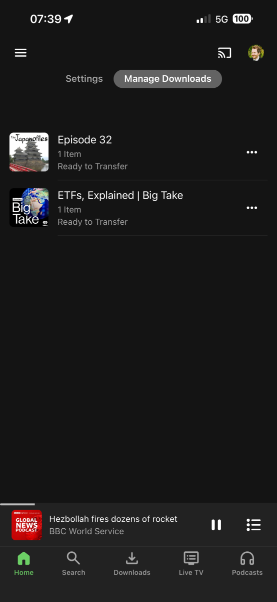

Natelanxon 28 Posted February 7, 2023 Posted February 7, 2023 Unfortunately that’s not the case for me on cellular connections. On Wi-Fi there’s no problem. Still on 5G Emby sits on read to transfer. I’m on the latest iOS 16.3 and the latest Emby 2.2.6.
Marc0 29 Posted February 7, 2023 Author Posted February 7, 2023 33 minutes ago, Natelanxon said: Unfortunately that’s not the case for me on cellular connections. On Wi-Fi there’s no problem. Still on 5G Emby sits on read to transfer. I’m on the latest iOS 16.3 and the latest Emby 2.2.6. Just to make sure you know: You are aware there is a checkbox in settings in the Emby iOS app that prevents downloads when on 4G/5G, right?
Natelanxon 28 Posted February 7, 2023 Posted February 7, 2023 Of course. First thing I checked. It’s always set to allow 5G. I have the same setting checked in iOS settings too to allow cellular use.
Marc0 29 Posted February 7, 2023 Author Posted February 7, 2023 40 minutes ago, Natelanxon said: Of course. First thing I checked. It’s always set to allow 5G. I have the same setting checked in iOS settings too to allow cellular use. Just checking you Wilson

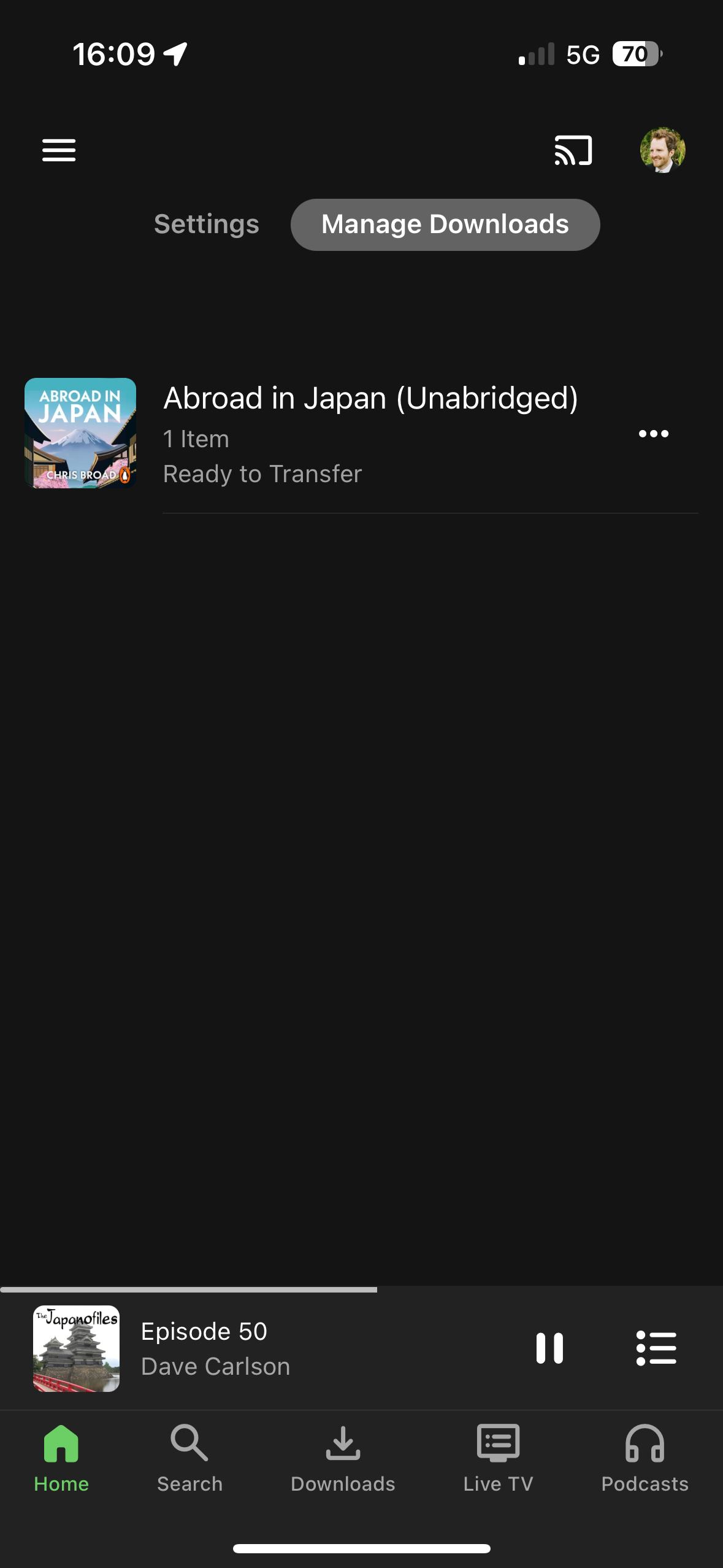

Natelanxon 28 Posted August 25, 2024 Posted August 25, 2024 (edited) Hey team. Reupping this thread as I have a new iPhone and still have this same issue I’ve had for years of items stuck “ready to transfer.” If you can remind me how to get whatever logs you’d need to diagnose I’ll get that for you. Edited August 25, 2024 by Natelanxon
