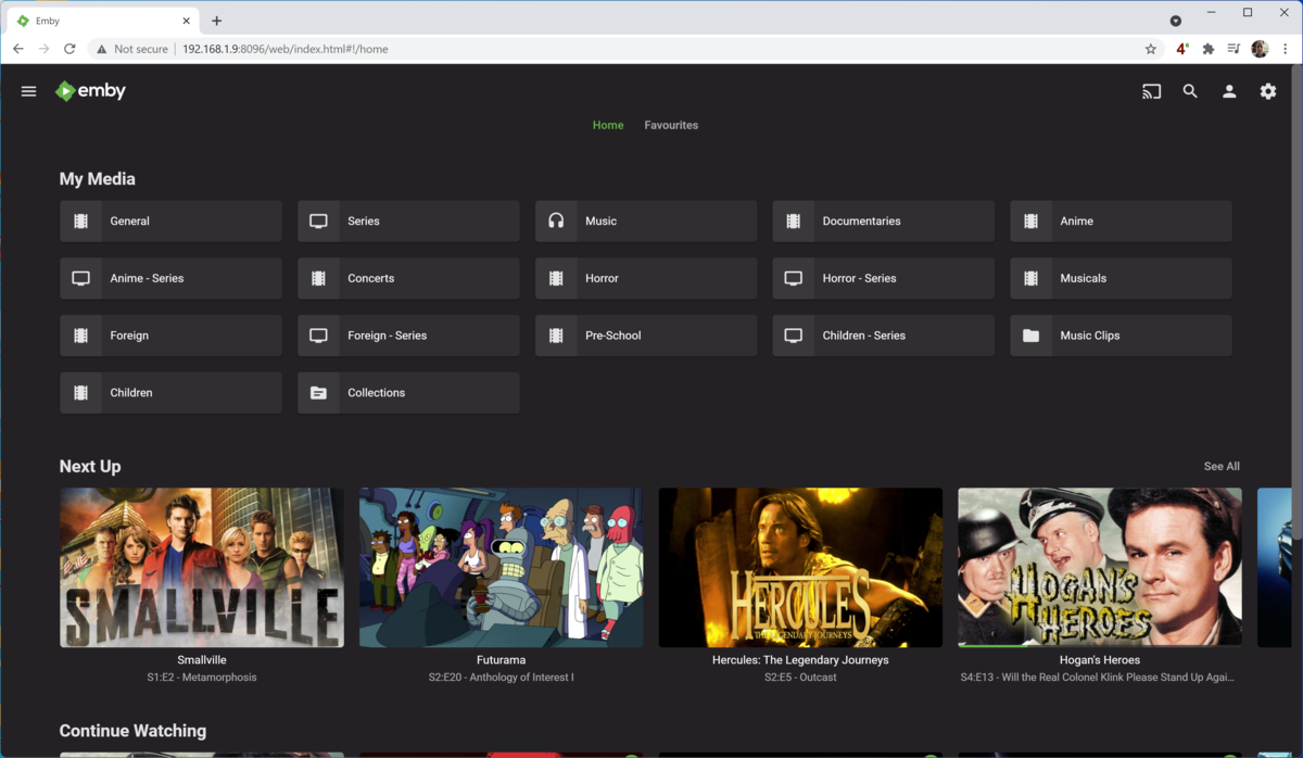

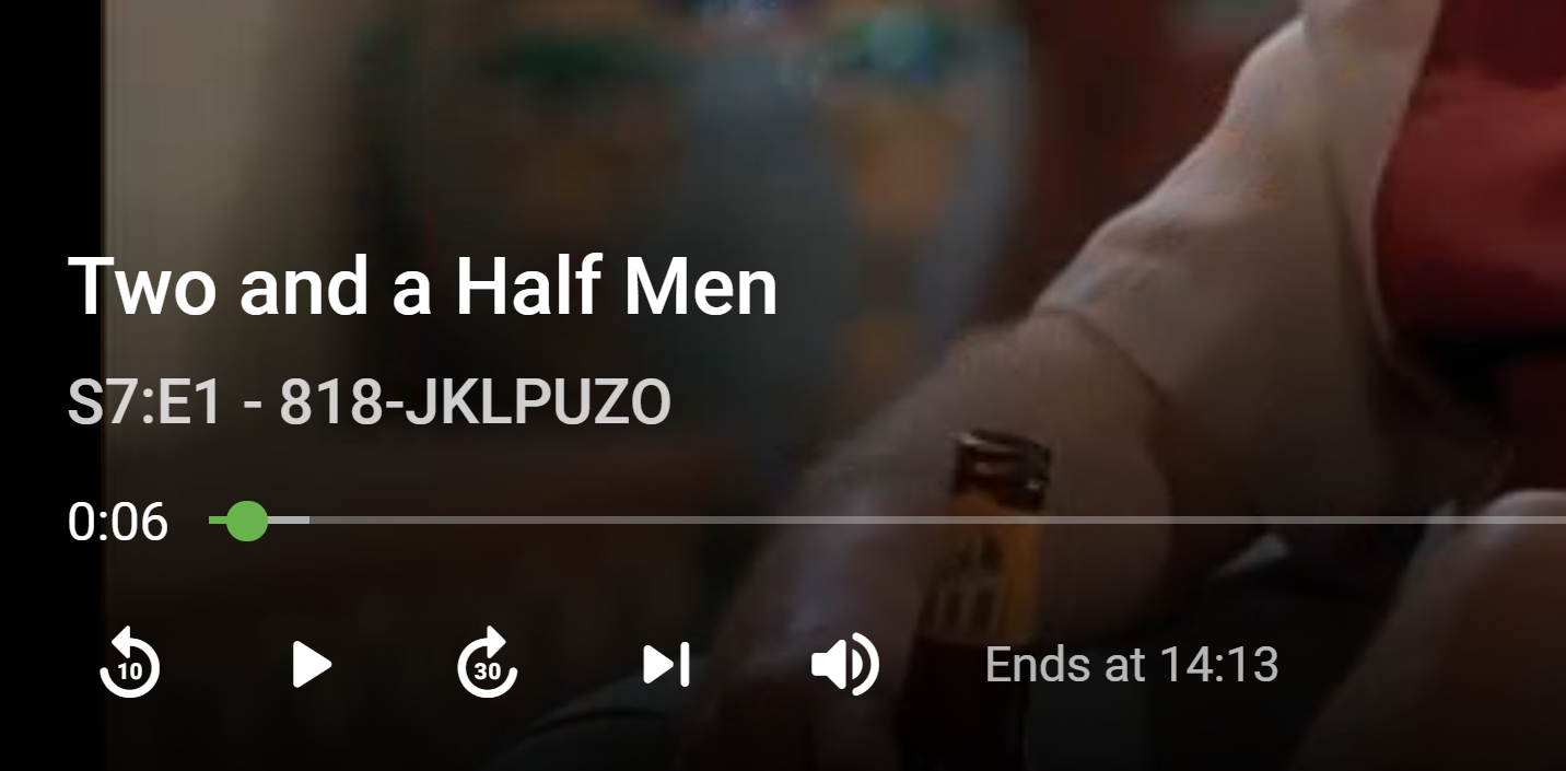

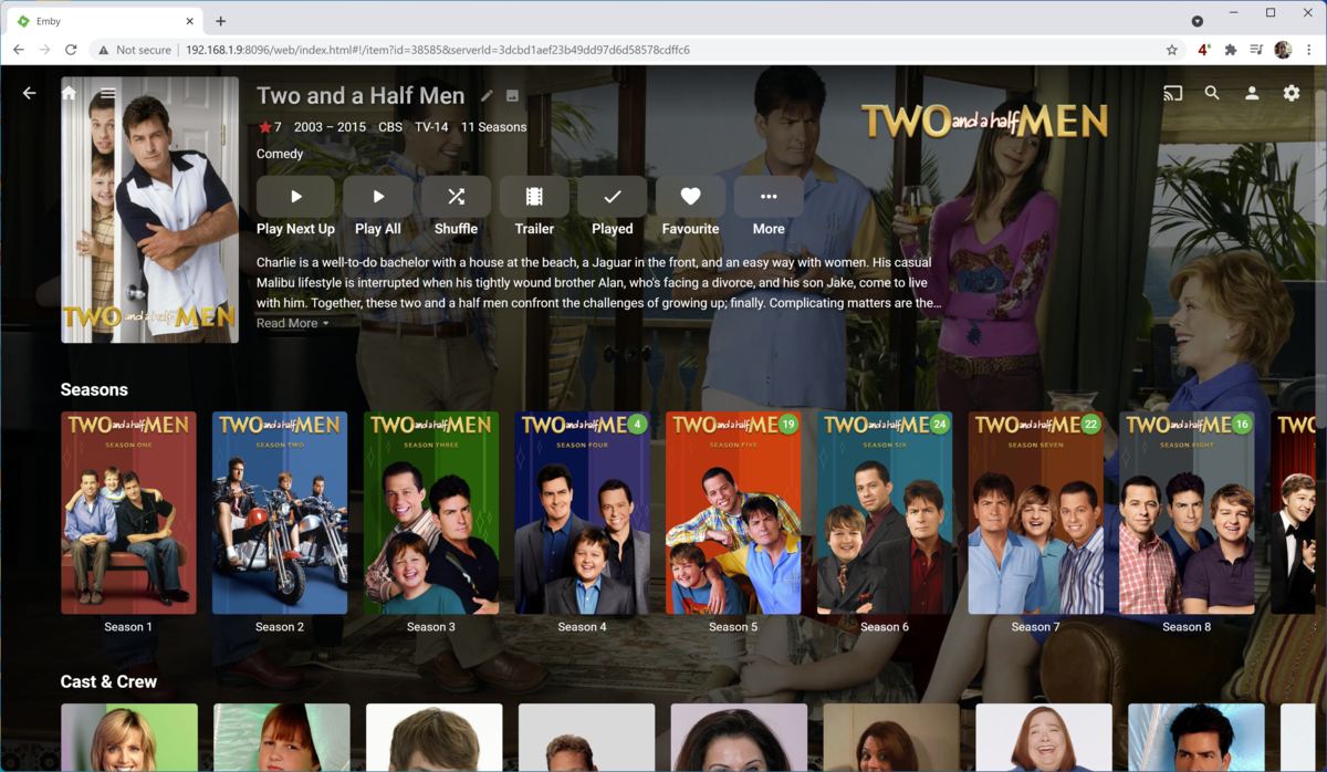

damichab 2 Posted November 14, 2021 Author Posted November 14, 2021 H Luke. The two screen shots below... The first one shows the 'Next Up'. The second one shows the series "Two and a Half Men" which I watch on regular rotation (Not the first time I have watched this). This should be showing on the list. The second image shows the series. As you can see, it is part way though season 4. When I press the 'Play Next Up', what plays is the episode s7e1. This is the second cycle through this series where this has happened (The first few times this series was played, it worked ok). It does not matter which episode should be played next, one before s7e1, s7e1 itself, or any after it, the same s7e1 plays next and the series never shows on the 'Next Up' list. The series on the 'Next Up' list that do show up, show and play the correct episode. There are a number of series that don't show up correctly - I just picked "Two and a Half Men" as a convienient example.
ebr 16307 Posted November 14, 2021 Posted November 14, 2021 Hi. This is a re-watch scenario, correct? Try this, go to S6E24 (or whatever the last episode is) and mark it watched and then mark it unwatched again. Then go to the last episode you actually watched and play it and skip to the end and back out. Did that have any impact?
damichab 2 Posted November 14, 2021 Author Posted November 14, 2021 9 hours ago, ebr said: Try this, go to S6E24 (or whatever the last episode is) and mark it watched and then mark it unwatched again. Just tried this and it makes no difference. Something with the series has got itself corrupted. Can the button itself be reset? I have also tried (in the past) resetting file s7e1, the whole season (6 & 7) and the whole series - none of which made any differnece.

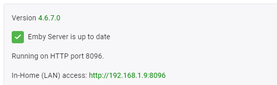

damichab 2 Posted December 18, 2021 Author Posted December 18, 2021 When is 4.7 to be released? Currently my server is on 4.6.7 and the message is that this is up to date. When are you planning on releasing 4.7? I had an idea that my user profile might have been corrupted, so I created a new one to replace the old one. Interestingly, all the tv series that seem to be out of whack, are still out of whack at the same episodes as it was before. I then realised that I could have saved time by checking my wife's user profile! Hers too had the Next up episode in all the same wrong places. So I guess it has nothing to do with user profiles.
Happy2Play 9800 Posted December 18, 2021 Posted December 18, 2021 (edited) 1 hour ago, damichab said: When are you planning on releasing 4.7? No one can say as, but Combine Continue Watching row is currently broke in 4.7.0.19. Edited December 18, 2021 by Happy2Play
