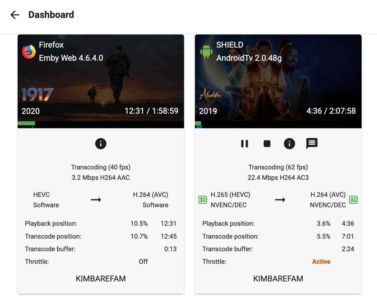

BirdBare 9 Posted November 9, 2021 Posted November 9, 2021 Hello, I am running emby in a Kubernetes container on Truenas scale. I seem to be only getting 1 GPU transcode where I know my device offers 2 max. GPU - Nvidia P620. I've attached an image and log files I might have missed a setting so I apologize if so :) ffmpeg-transcode-f41c8f3f-9574-44c1-a0f2-24dd8ace4560_1.txt ffmpeg-transcode-8f53af99-5fc5-4562-9308-edb4167a9065_1.txt embyserver(1).txt

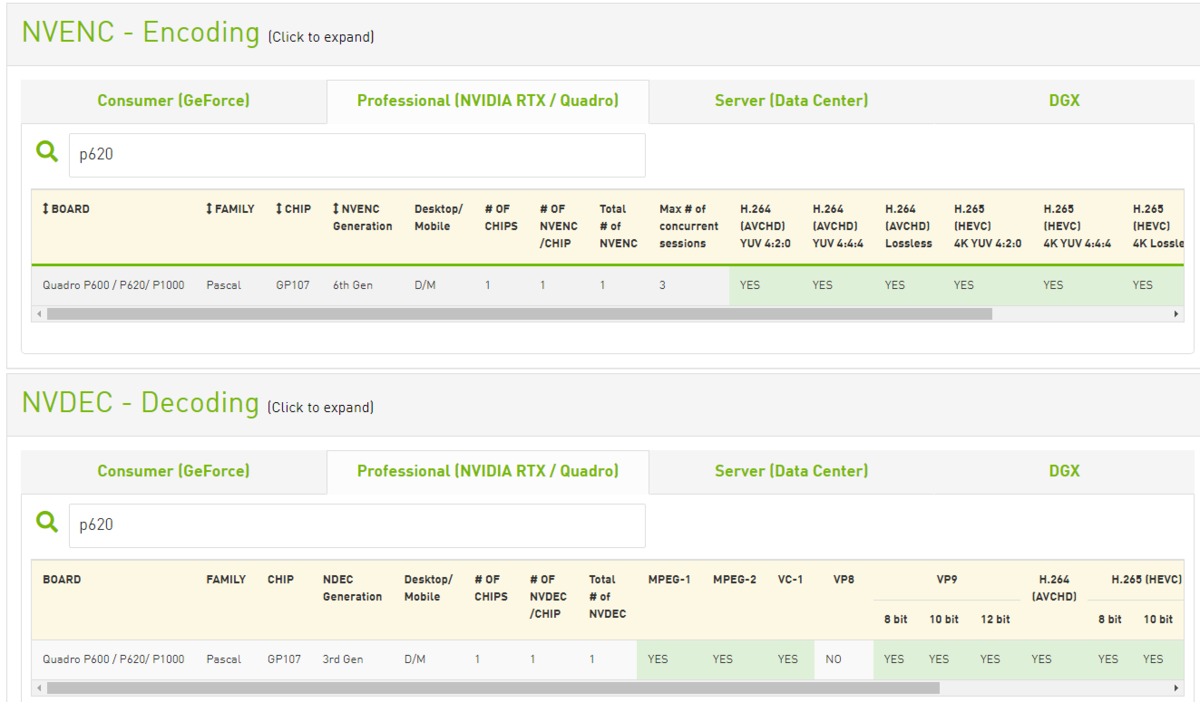

Happy2Play 9813 Posted November 10, 2021 Posted November 10, 2021 (edited) To me it looks like a limitation in the card. But the devs would have to comment more. decoder->cvdl->cuvidCreateDecoder(&decoder->decoder, params) failed -> CUDA_ERROR_OUT_OF_MEMORY: out of memory But per the Nvidia matix you only have 1 decoder. Video Encode and Decode GPU Support Matrix [NEW] | NVIDIA Developer But have no idea how the patch works. Edited November 10, 2021 by Happy2Play
Luke 42246 Posted November 10, 2021 Posted November 10, 2021 These are also both tone mapping, which is a very intensive process. Are you sure it can handle two of that at once?

softworkz 5133 Posted November 10, 2021 Posted November 10, 2021 4 hours ago, Luke said: These are also both tone mapping, which is a very intensive process That's true, but only when done in sw. The CUDA tone mapping is just about nothing for an Nvidia card.
BirdBare 9 Posted November 10, 2021 Author Posted November 10, 2021 (edited) 2 minutes ago, softworkz said: That's true, but only when done in sw. The CUDA tone mapping is just about nothing for an Nvidia card. Good to know! Do you think the issue is available ram then? I can get 5 1080p he transcodes but only 1 4k. Edited November 10, 2021 by BirdBare
