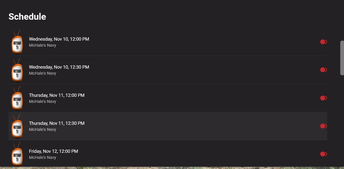

clarkss12 304 Posted November 9, 2021 Posted November 9, 2021 (edited) I was perusing my scheduled recordings and found that even though I already have the episodes recorded, they are scheduled to record again. This is the greatest feature of the DVR function under Emby, not re-recording episodes already in the library. McHale's Navy is recording an episode that is already in my library. Not sure when this started, since I just noticed it. All the criteria are in the episode, so it should not be recording. Also, all of the future episodes are scheduled to record, even though they are already in my library. I added a video to help explain. 88695274_DuplicateEmbyrecordings.mp4 ffmpeg-transcode-57c5d792-513b-4ce1-aea9-8d0b1e469f49_1.txt ffmpeg-transcode-f3ea2c95-5677-4455-a183-724234c0042a_1.txt embyserver.txt Edited November 9, 2021 by clarkss12 added logs
clarkss12 304 Posted November 9, 2021 Author Posted November 9, 2021 Here is the duplicate recording......... The only difference I see is in the episode numbering system.... Original is >> McHale's Navy - 2x23 - Dear Diary.mpg Possibly recorded by the HDHomeRun DVR, or TVheadend... Episode just completed recording. >> McHale's Navy S02E23 Dear Diary.ts Completed recording.mp4
Luke 42288 Posted November 9, 2021 Posted November 9, 2021 21 minutes ago, clarkss12 said: I was perusing my scheduled recordings and found that even though I already have the episodes recorded, they are scheduled to record again. This is the greatest feature of the DVR function under Emby, not re-recording episodes already in the library. McHale's Navy is recording an episode that is already in my library. Not sure when this started, since I just noticed it. All the criteria are in the episode, so it should not be recording. Also, all of the future episodes are scheduled to record, even though they are already in my library. I added a video to help explain. 88695274_DuplicateEmbyrecordings.mp4 89.56 MB · 0 downloads ffmpeg-transcode-57c5d792-513b-4ce1-aea9-8d0b1e469f49_1.txt 22.35 kB · 0 downloads ffmpeg-transcode-f3ea2c95-5677-4455-a183-724234c0042a_1.txt 24.7 kB · 0 downloads embyserver.txt 11.34 MB · 0 downloads Hi, did you read the help text underneath the option of "don't record episodes that are already in my library".
clarkss12 304 Posted November 9, 2021 Author Posted November 9, 2021 (edited) 6 minutes ago, Luke said: Hi, did you read the help text underneath the option of "don't record episodes that are already in my library". So, McHale's Navy - 2x23 format will NOT work?? Can it be made to work? Edit, the 2x23 format has to be recognized by Emby, because it shows up under recorded episodes....... Also, what does the "split versions apart" mean?? Edited November 9, 2021 by clarkss12
Luke 42288 Posted November 9, 2021 Posted November 9, 2021 It means that if the guide data doesn't have that information then there's no way to perform that comparison, therefore you get additional recordings.
clarkss12 304 Posted November 9, 2021 Author Posted November 9, 2021 8 minutes ago, Luke said: It means that if the guide data doesn't have that information then there's no way to perform that comparison, therefore you get additional recordings. But the guide data DOES have the correct information, as far as I can tell.

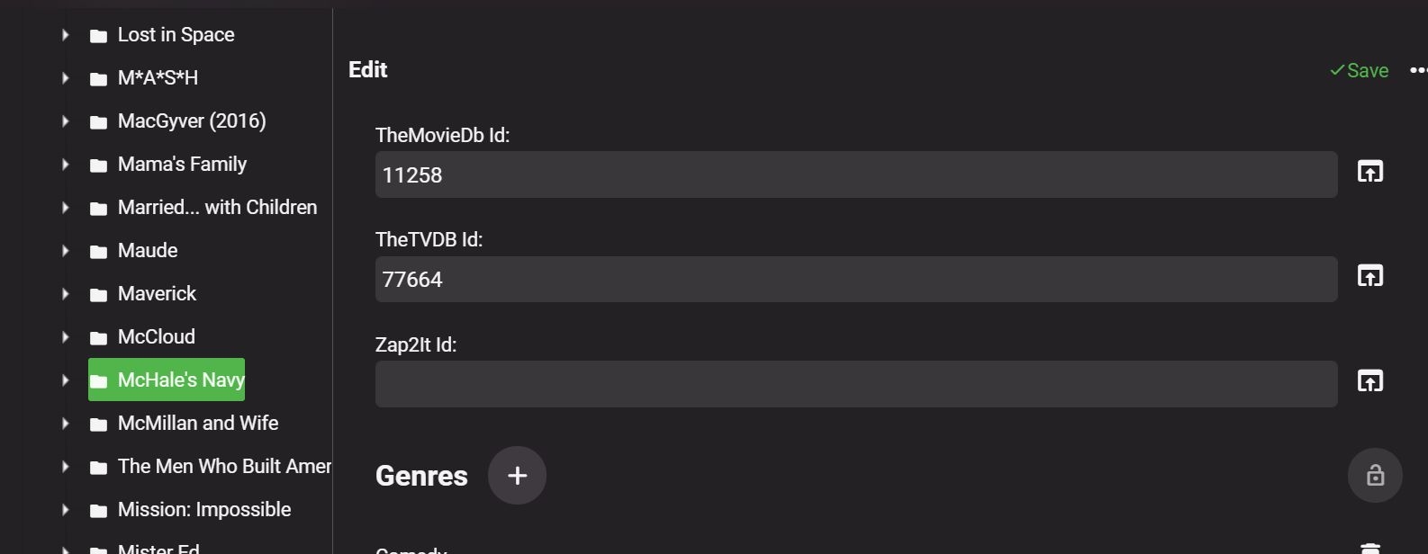

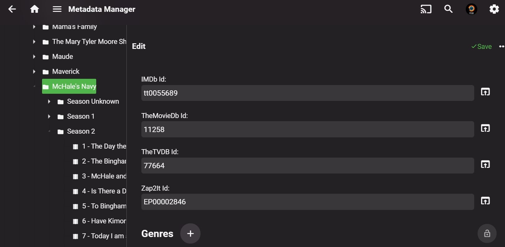

Luke 42288 Posted November 9, 2021 Posted November 9, 2021 Try making sure your existing series has a zap2it id in the metadata editor.
clarkss12 304 Posted November 9, 2021 Author Posted November 9, 2021 (edited) I have an issue about accessing the recent recordings for the metadata information. My DVR recording destination is a hard drive on one of my mini PCs (H (\\Beelinkgtr)). I move most of my recordings to a different device that has an internal hard drive )\\192.168.10.185\Movies\Shows). Now, this issue pops up, I can't access the meta data for the episode that just recorded.... Hope this video makes sense. But, the duplicate recordings have the same information, but nozap2it id . They are the same episode, when I play them. McHale's Navy - 2x23 - Dear Diary.nfo McHale's Navy S02E23 Dear Diary.nfo reverts to storage drive2.mp4 Edited November 9, 2021 by clarkss12
Luke 42288 Posted November 9, 2021 Posted November 9, 2021 Quote Now, this issue pops up, I can't access the meta data for the episode that just recorded.... I don't quite understand. Just make sure you have an Emby library setup for whatever the location is supposed to be, and configure the dvr recording paths appropriately. Quote Try making sure your existing series has a zap2it id in the metadata editor. At the series level.
clarkss12 304 Posted November 9, 2021 Author Posted November 9, 2021 9 minutes ago, Luke said: I don't quite understand. Just make sure you have an Emby library setup for whatever the location is supposed to be, and configure the dvr recording paths appropriately. At the series level. Ok, guess I was a little dense. The current recording "series" has a value in the Zap2it field, but not the other recordings. Can I copy the Zap2it ID into the "series" that is missing that value, and problem will be solved??? Thanks for your help.
clarkss12 304 Posted November 9, 2021 Author Posted November 9, 2021 I copied the Zap2it ID to the "series" that did NOT have a value, then did a library refresh. They are still scheduled to record........
clarkss12 304 Posted November 9, 2021 Author Posted November 9, 2021 I copied the zap2it ID entry from my current recording directory to the Series with out the Zap2it ID. I then deleted the nfo information for my existing recording that is scheduled to record tomorrow. I then MOVED the future scheduled recordings to the DVR drive. After a library refresh, the moved "future" recordings created a new nfo file. Did anther library refresh, but that future episode is still scheduled to record........ This garble probably does not make sense....... Anyway, I just moved the episodes that have already been recorded 2 years ago to the location that the current recordings are stored. This is scheduled to be recorded tomorrow. I moved that episode ( that I recorded 2 years ago) into the folder that this recording will go into... It should NOT record, since there is an existing episode in the folder. McHale's Navy WMYD-DT2 - 20.2 Wed, 11/10, 12:00 PM 30 min "The Novocain Mutiny" 3/03/1964, Season 2 / Episode 25 , Comedy, Classic, Military, War, Situation Comedy When Fuji begins to experience a very painful toothache, his complaints reach McHale and the crew, who attempt to get him an appointment with the local island Dentist, while a rigid Fleet Officer is making an inspection tour.
clarkss12 304 Posted November 10, 2021 Author Posted November 10, 2021 Hope I am not beating this old horse to death. I moved this episode into my recording folder yesterday "McHale's Navy - 2x25 - The Novocain Mutiny", and it acquired a different nfo information. Today, at noon, it recorded the same episode, into the same recording folder. I really can't understand why it is recording the same episode. Not a life changer, but I think you should be able to change the way you look for episodes..... McHale's Navy.mp4 McHale's Navy - 2x25 - The Novocain Mutiny.nfo McHale's Navy S02E25 The Novocain Mutiny.nfo

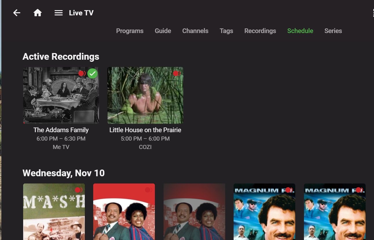

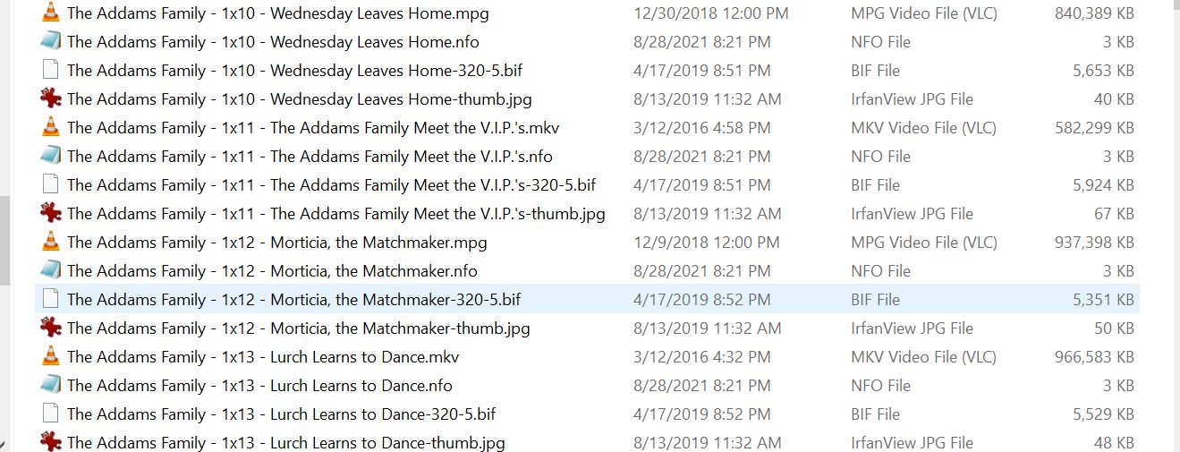

clarkss12 304 Posted November 10, 2021 Author Posted November 10, 2021 Something has seriously changed. The Adams Family has 2 seasons with a total of 64 episodes. I have all of them on my storage device where I keep my completed series. Now, Season 1 episode 11 of the Adams Family is scheduled to record again in a few minutes............. Something is happening here, not exactly clear, but a man with a gun over there is telling me to beware!!!! Sorry, I had throw that in "For What It's Worth by Buffalo Springfield" But, seriously, something has to have changed. Either that, or I just came out of a coma and noticed it. .. 1
clarkss12 304 Posted November 10, 2021 Author Posted November 10, 2021 Right now, Emby is recording the Addams Family, season 1 episode 11. I already have that episode that I recorded March 12, 2016, why is it recording now??
