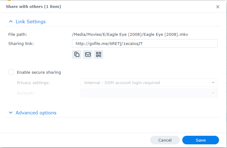

Carlo 4561 Posted November 9, 2021 Posted November 9, 2021 I've been watching as @GrimReaper has been giving you excellent advice on what to try to diagnose this and I would have done exactly the same thing. Can you upload your latest hardware_detection log file for us to look at? Can you share Lost in Russia for us to use to test with? You can probably right click on the media file and choose share: Then just PM me the link you see above. You can adjust how long the link is good for in the advanced options if you like. If you don't have this configured on your NAS then you could also upload the file to dropbox, google drive or similar as well. Thanks. 1
Sailence 0 Posted November 9, 2021 Author Posted November 9, 2021 8 minutes ago, cayars said: 我一直在看着 @GrimReaper 一直在给你很好的建议来尝试诊断这个问题,我也会做同样的事情。 你能上传你最新的hardware_detection日志文件给我们看看吗? 你可以分享迷失在俄罗斯供我们用来测试吗? 您可能可以右键单击媒体文件并选择共享: 然后PM我你上面看到的链接。 如果您愿意,您可以在高级选项中调整链接的有效时间。 如果你没有在你的 NAS 上配置这个,那么你也可以将文件上传到 dropbox、谷歌驱动器或类似的。 谢谢。 lost in Russia: http://sailence.top:5000/sharing/hVC7C5cgF password:Embysupport And I don't know where can I find the hardware_detection log file.
