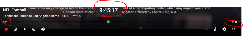

Spacefred 0 Posted November 8, 2021 Author Posted November 8, 2021 Quote Hi. At this time, the recording and the live channel are two separate things. If you choose to "watch from the beginning" then you are watching the recording, if not, you are just watching the live channel and would only be able to seek back to the point where you started (in seek mode). Thanks for the explanation - makes sense now. Hopefully there is an enhancement in the wings Quote Hi. The time on the left is the current time in the program. The time on the right is the time that is left in the program (shown as a negative number). This is fairly common display in media players. The full run time of the program is already shown above the progress bar. I actually cannot make out what the example you showed is showing because it has what looks like random values for everything except the popup current time... The example is from the emby web app - this was last night's football game. It started at 8:20 and was scheduled to end at 11:30. My screenshot was doe at 9:45. The same view on the android app uses the time remaining - If you can let me know how to get a screenshot of the android app, It will make is easier to show what I mean.
ebr 16337 Posted November 8, 2021 Posted November 8, 2021 1 hour ago, Spacefred said: The example is from the emby web app - this was last night's football game. It started at 8:20 and was scheduled to end at 11:30. My screenshot was doe at 9:45 Ah, okay now I see. The TV app shows the progress bar just like any other item. Start is at 0, current position is time from 0 and length is the length.
