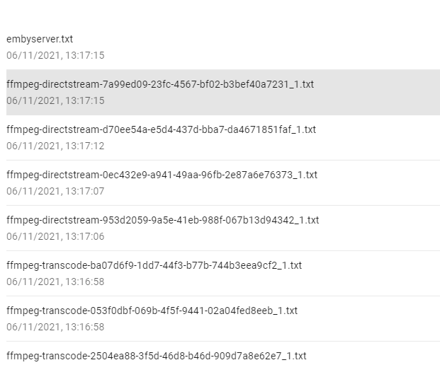

7Davids7 1 Posted November 6, 2021 Author Posted November 6, 2021 Thank you for your quick response Sorry, I have never had to send a log before. Which one is it as my system is showing lots This is just a small shot of them
Luke 42245 Posted November 6, 2021 Posted November 6, 2021 5 minutes ago, 7Davids7 said: Thank you for your quick response Sorry, I have never had to send a log before. Which one is it as my system is showing lots This is just a small shot of them Hi, please attach all of the ones that were modified during the time frame in which the problem was experienced. Thanks.
