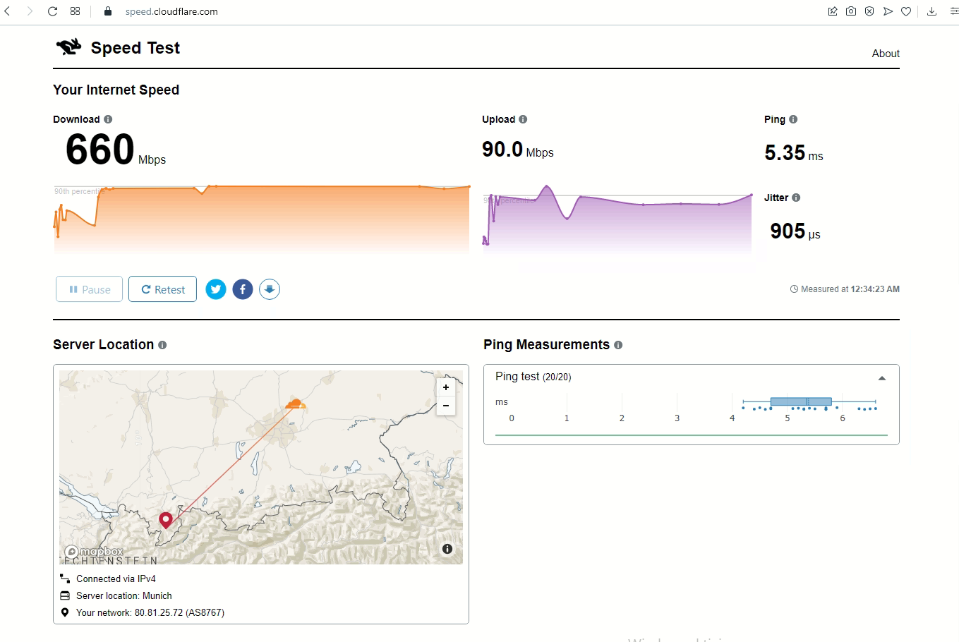

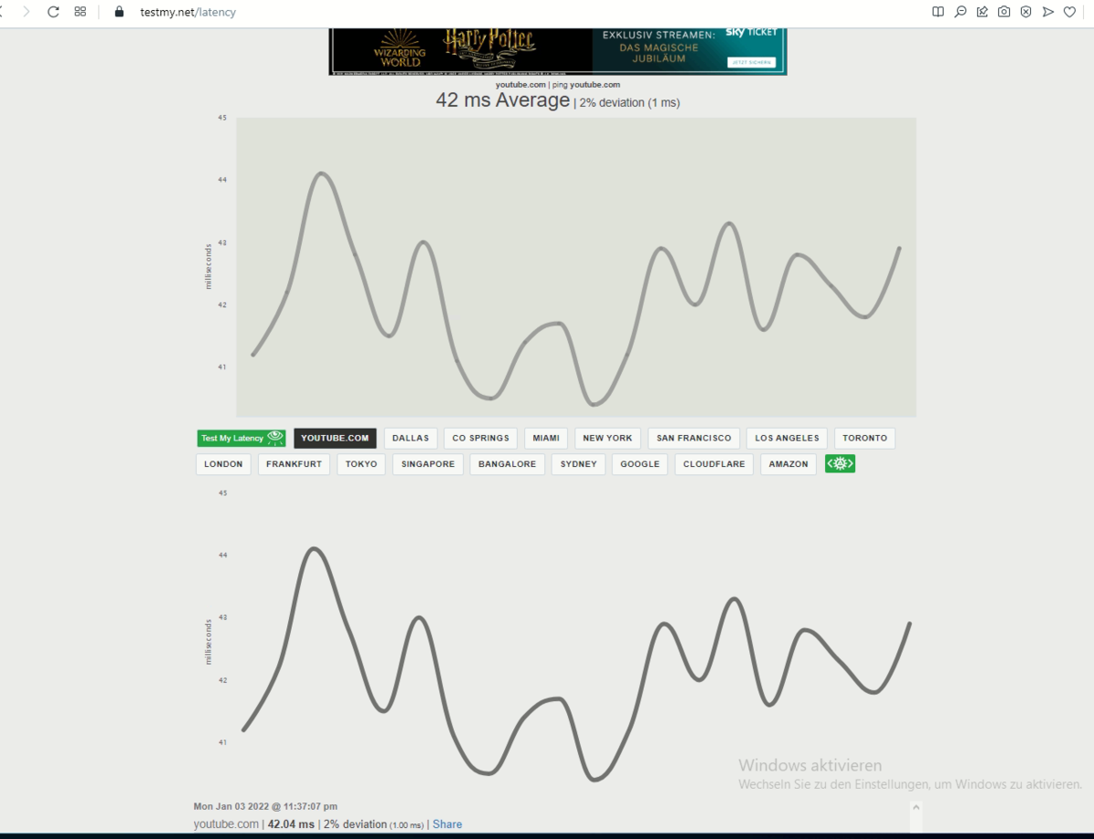

Carlo 4561 Posted November 7, 2021 Posted November 7, 2021 Try this simple thing. Test your speed from any computer on your network at: https://www.speedtest.net/ https://speed.cloudflare.com/ I bet you will see a disappointing difference in bitrates. Cloudflare also calculates jitter to see if this is a potential problem. Now try those same tests when you're network bandwidth is being used with heavy streaming from Emby. I'll bet that speedtest.net will still show a high rate while cloudflare.com will drop because it's doing a better, more realistic test. You'll also see jitter rise a bit as well. Now try: https://testmy.net/latency?addr=cloudflare.com https://testmy.net/latency?addr=youtube.com Try the other locations on that as well. This site uses TCP vs ICMP pings which is much more accurate and your ISP isn't going to let those packets through as a priority giving you false ping times. This site also has a section at the bottom for you to host a file and be able to accurately test you own site as well which you want to do while your Emby server is at that 50Mb transfer you see. Latency can play a huge factor in what you can stream. Now with all that said, 50Mb just sounds odd and really sounds like your provider is limiting to. The test above will help a lot to figure this out. While streaming to a client, run all three of those tests and report back what you get from each of them or just grab a few screen shots. I half expect speedtest.net to still be high, Cloudflare to be pretty realistic of bandwidth available and testmy.net to show throttling from your provider.
caffeineshock 18 Posted January 3, 2022 Author Posted January 3, 2022 On 11/7/2021 at 6:49 PM, cayars said: Try this simple thing. Test your speed from any computer on your network at: https://www.speedtest.net/ https://speed.cloudflare.com/ I bet you will see a disappointing difference in bitrates. Cloudflare also calculates jitter to see if this is a potential problem. Now try those same tests when you're network bandwidth is being used with heavy streaming from Emby. I'll bet that speedtest.net will still show a high rate while cloudflare.com will drop because it's doing a better, more realistic test. You'll also see jitter rise a bit as well. Now try: https://testmy.net/latency?addr=cloudflare.com https://testmy.net/latency?addr=youtube.com Try the other locations on that as well. This site uses TCP vs ICMP pings which is much more accurate and your ISP isn't going to let those packets through as a priority giving you false ping times. This site also has a section at the bottom for you to host a file and be able to accurately test you own site as well which you want to do while your Emby server is at that 50Mb transfer you see. Latency can play a huge factor in what you can stream. Now with all that said, 50Mb just sounds odd and really sounds like your provider is limiting to. The test above will help a lot to figure this out. While streaming to a client, run all three of those tests and report back what you get from each of them or just grab a few screen shots. I half expect speedtest.net to still be high, Cloudflare to be pretty realistic of bandwidth available and testmy.net to show throttling from your provider. i did setup a test-vm to exclude the system where the actual emby-server is installed to cause the problem i did download several jellyfin-testfiles and well... everything as expected: i get slown down by something here are the messurements while watching a high bitrate file (bitrate ~100mbit so it has to stop the playback every few seconds because of the limited upload) i did them without ssl (since it did not have any impact on the results in the past). On 11/7/2021 at 2:58 PM, ebr said: Your ISP is undoubtedly smart enough to recognize the speedtest sites and will do everything it can to not block or shape that I would imagine. youre probably right. i cannot imagine anything that can cause that slowdown on my side (like router, firewall, modem or switch)
