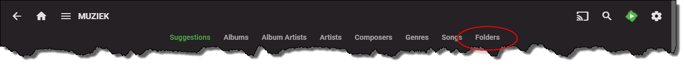

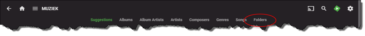

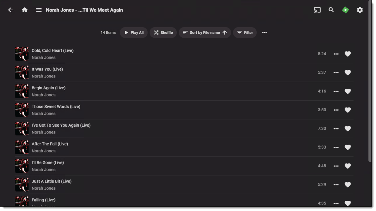

Now I noticed that, when I go to music --> folders --> click on an album, I'm redirected to:
https://myserver/web/index.html#!/list/list.html?parentId=209987&serverId=c15e29a3226b472faa47dd4bd028e4e6, that shows me a list of numers:

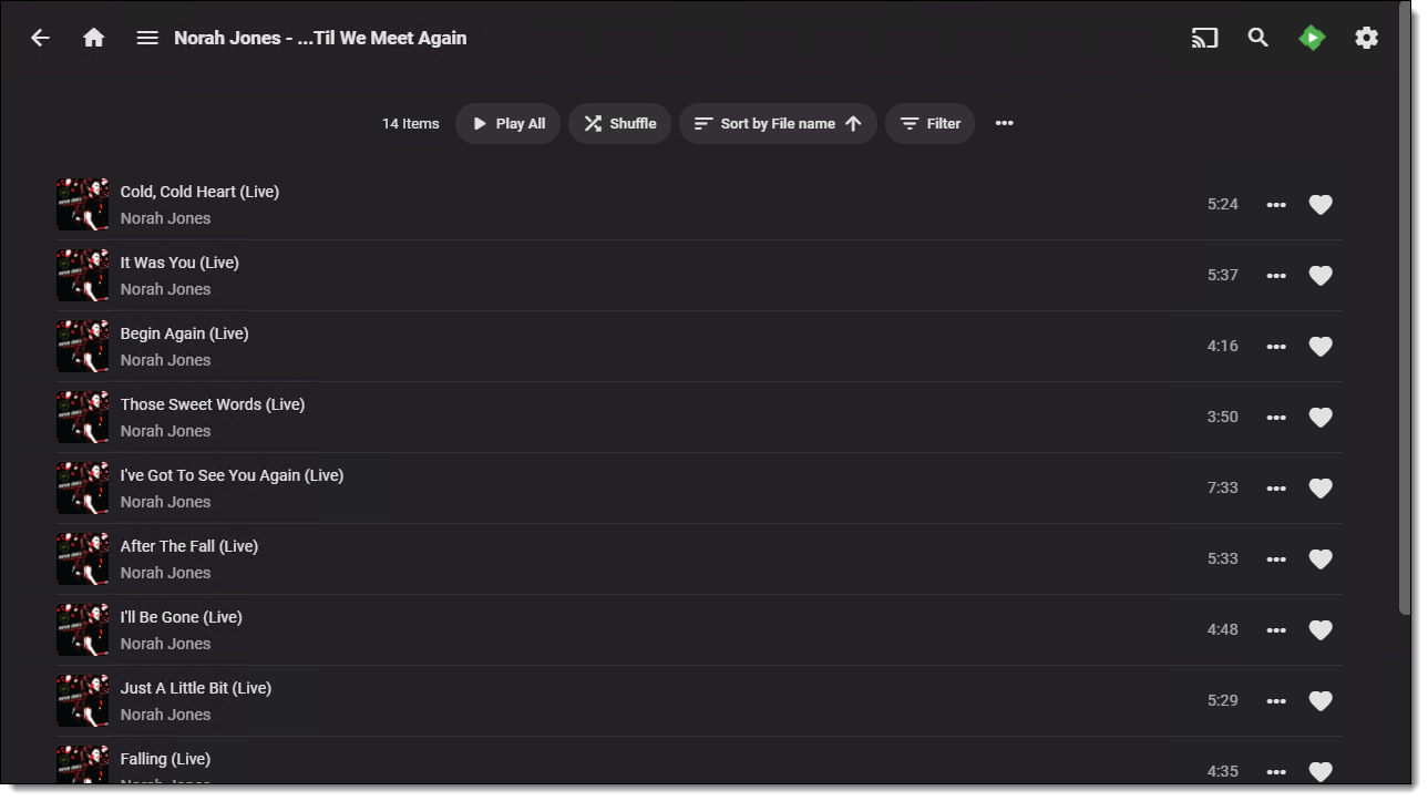

If I go to artist --> album, I'm redirected to
https://myserver/web/index.html#!/item?id=256197&serverId=c15e29a3226b472faa47dd4bd028e4e6
which shows me not only the songlist, but also some more information:

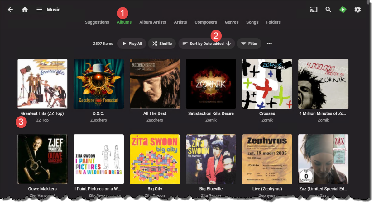

  4. this introduced a library scan, and "date added" was modified: the scan was scanning all my music (sub)folders alphabetically, so artists starting with "z" were last added
  5. with your tip above, I modified "options.xml" of "MUZIEK" --> library changed content type indeed, but metadata i.e. "date added" was overwritten by previous scan.
  6. I removed the library "MUZIEK-NEW"
  7. a new scan was introduced with same logic: scanning the main directory alphabetically, so ZZ-top is again "last added"
I suppose I've lost this metadata ("date added") 😞

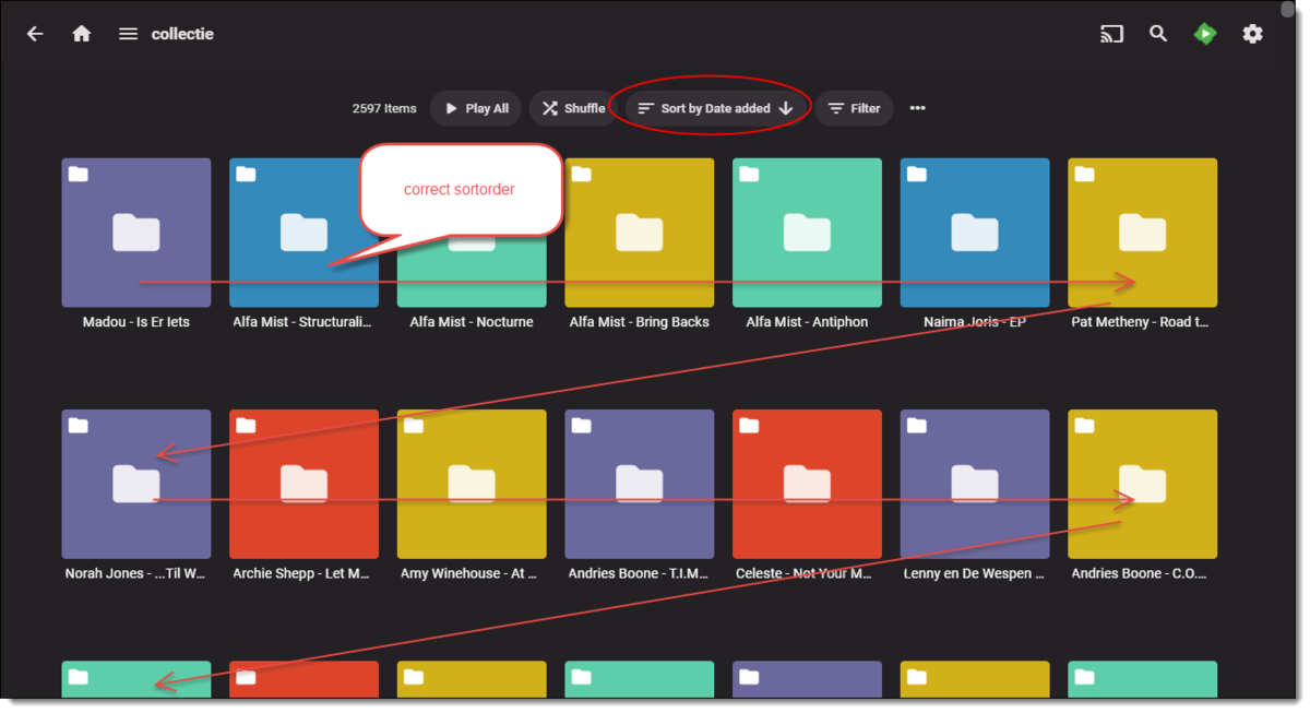

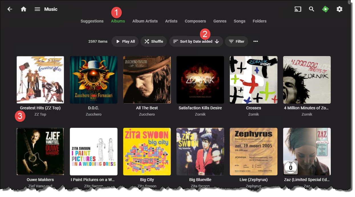

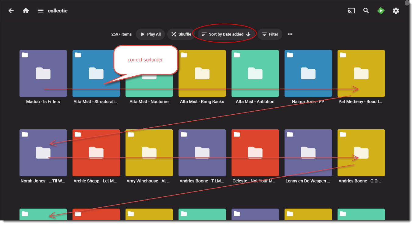

if I sort my library in the folder-view by "Date added";
the sortorder is correct (don't look at the ugly icons, the library scan is still running now.... 🙂 ):
Maybe one can refine the logic of the library scanner so that the date of the folder is taken into account when scanning?
This should be possible, as it is already now for songs: If I view my songs sorted by "Date Added", the order is correct! (based on file datestamp)

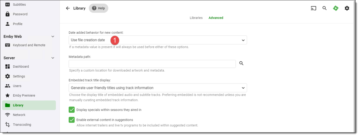

Check out this setting and see if it will help.

This setting doesn't impact album date added, as noted above the song/track will use it. emby uses the date the tracks are consolidated into the album, which is "correct" for new music. If like above you create a new music library or rebuild the library all albums will be given a date added of the current date.
This can be fixed a couple of ways... @Luke ?

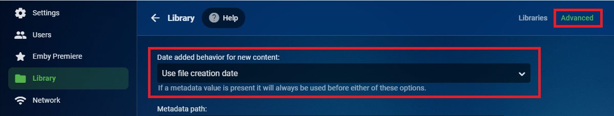

Below is one mitigation. The folder date is really the date the album dateAdded.
23 hours ago, plessers@gmail.com said:

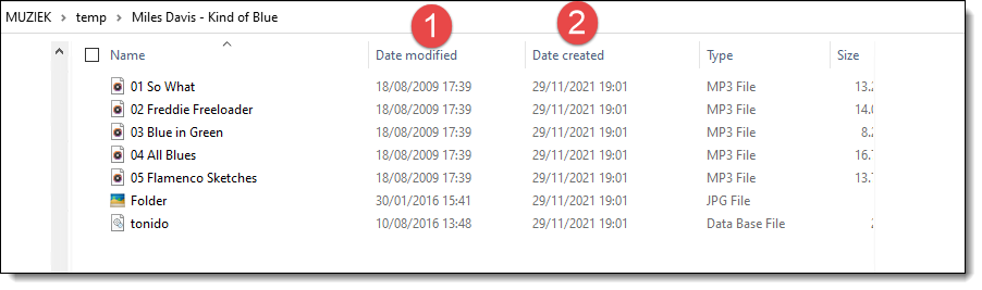

another question: what date will you taken into account?  "Date modified" or "Date created"?
I'm just asking because if you copy an album from one folder to another folder, the tracks in the folder will have "Date created" as date from the copy action, and "Date modified" will be the "original" date:
In my case "Date modified" would be the preferabele date for the album. (Although I can imagine that others want "Date Created"...)
grtz
B

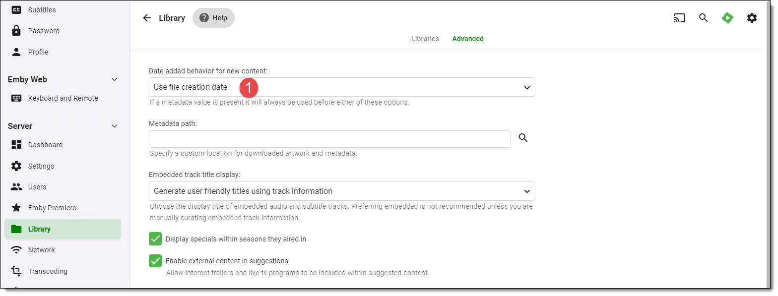

The date that comes from the advanced library option to control where date added comes from.
Happy2Play
That is the defect of COPY as that is the date that file was created not the original unless you use tools/options that preserve original file timestamps.  But applying embedded metadata changes modified date.  So there is no true method that will work for everyone.
