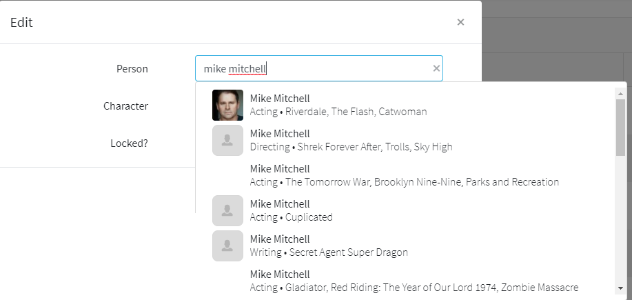

Happy2Play 9802 Posted November 1, 2021 Posted November 1, 2021 I don't thinks so as the linking is coming from item metadata, and this linking is happening in the database. So manually a same named person manually will not create any new linking. Luke would have to add something this a people query when adding a person so you choose if existing person is correct or new person to the database and you provide the properids. Similar to how the online provider do it, show existing or create new. I think your only option is adjusting this within the database, but @Lukewould have to confirm this.

Happy2Play 9802 Posted November 1, 2021 Posted November 1, 2021 Luke would have to implement something similar to this for manually adding People to items in this same named people environment with a New person option that is further down the list in this example. But pünktchen's method is what I did in the past. But in the end if you could add this person to the provider sites this would/should resolve the Emby issue as the item would return the person with properid. 1
gillmacca01 220 Posted November 2, 2021 Author Posted November 2, 2021 @pünktchen, thanks for the tip about adding a number at the end and remove afterwards, works a treat. @Happy2Playlove the screenshot, that would look cool, if it ever happened
