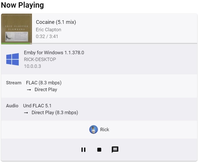

FrostByte 5453 Posted November 2, 2021 Posted November 2, 2021 (edited) Yes, no issues here. Been playing music all day However, I'm only using it from home on my network. Edited November 2, 2021 by FrostByte 1
