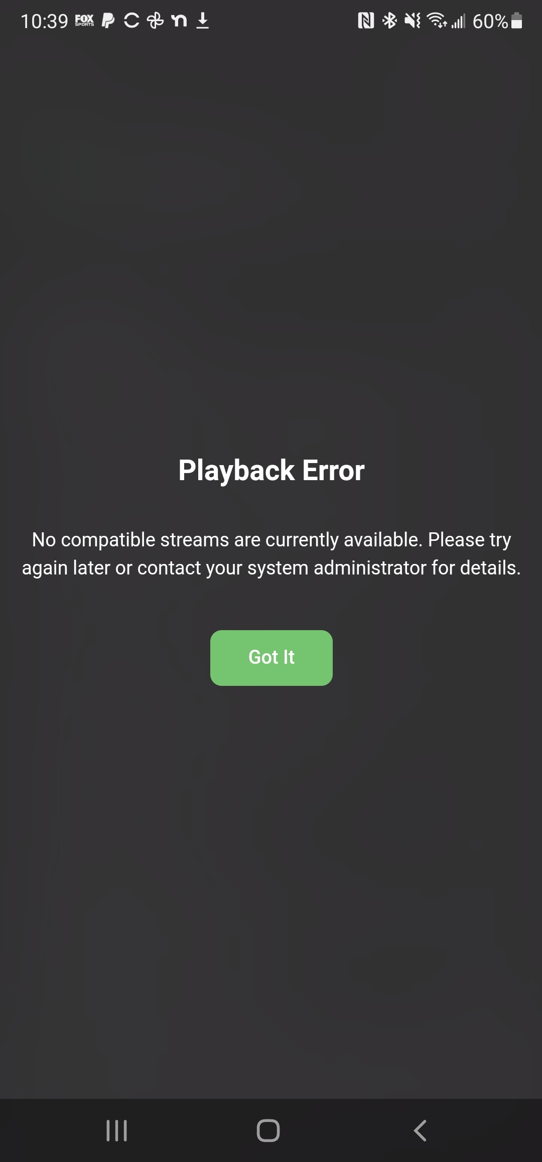

mgranger 4 Posted November 1, 2021 Author Posted November 1, 2021 Now the files are not even playing from the server. This happened about 10:30 on Oct 31 embyserver (1).txt embyserver (1).txt
Luke 42243 Posted November 1, 2021 Posted November 1, 2021 13 hours ago, mgranger said: Now the files are not even playing from the server. This happened about 10:30 on Oct 31 embyserver (1).txt 9.12 MB · 1 download embyserver (1).txt 9.12 MB · 0 downloads hi @mgranger, can you please attach the corresponding ffmpeg log from that attempt? Thanks.
mgranger 4 Posted November 1, 2021 Author Posted November 1, 2021 Here is the latest file I had in the log folder. Timestamps don't seem to match what I expected but it is the latest one that was there ffmpeg-transcode-8a221aaf-e01b-4790-8d4d-700424f6ebbd_1.txt
Luke 42243 Posted November 2, 2021 Posted November 2, 2021 OK it looks like you've set the quality setting in the app to about 20 mbps. Can you try lowering that much lower, to say 3 mbps? Then you can work your way higher as you see success with it playing smoothly.
