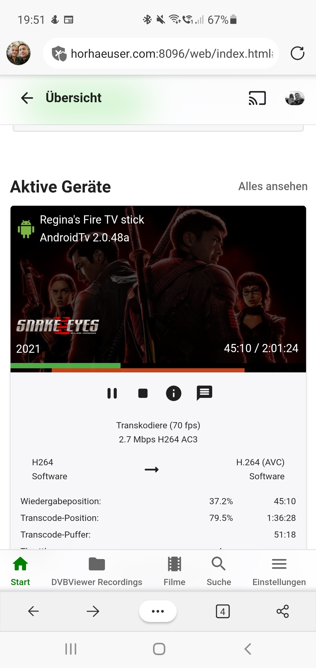

Horhäuser 7 Posted October 31, 2021 Posted October 31, 2021 (edited) Hallo, Ich besitze diesen Server: HPE ProLiant MicroServer Gen10 Plus, Pentium Gold G5420, 8GB RAM (P16005-421). Ich benutze die Emby Version 4.6.4.0 und habe eine Emby Premium Lizenz. Harfwarebescheunigung ist aktiviert, aber wird nur per Software transcodiert Edited October 31, 2021 by Horhäuser

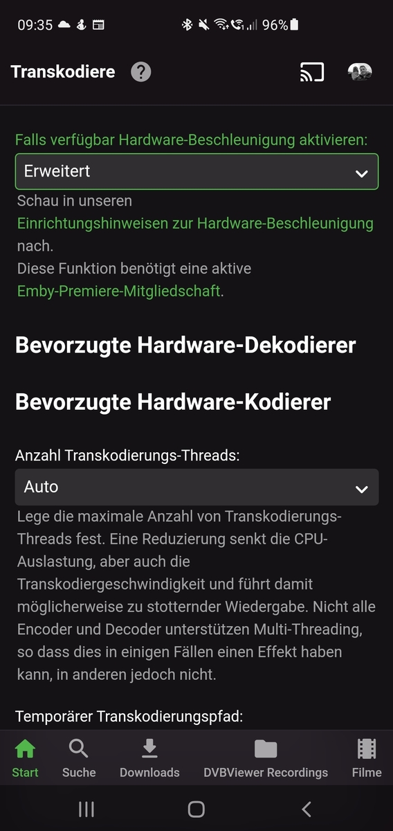

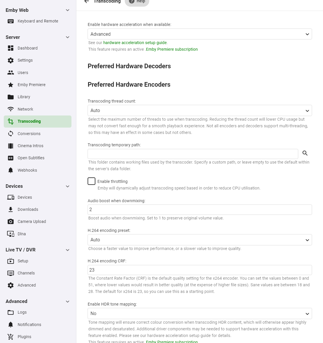

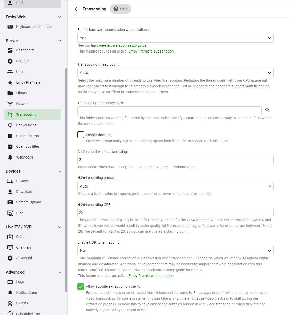

Carlo 4561 Posted November 1, 2021 Posted November 1, 2021 Hi, that has HD Graphics 610 so it should support Quicksync by Emby for hardware transcoding. Please do us a favor and switch your system to English for a minute and then grab a couple of screen shots of the Transcoding menu setup. If the first option is not set to Advanced also switch it to this after grabbing the first set of screen shots and now do the same. Set your language back again now. Post those screenshots so we can see how things are configured. Thanks
Happy2Play 9802 Posted November 1, 2021 Posted November 1, 2021 Since the image shows no decoders or encoders can you post the server and hardware-detection log.
