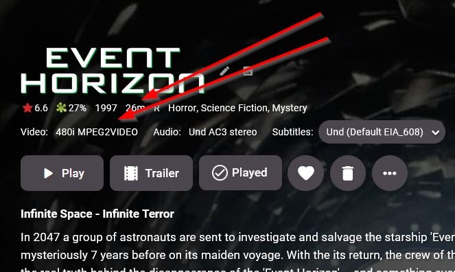

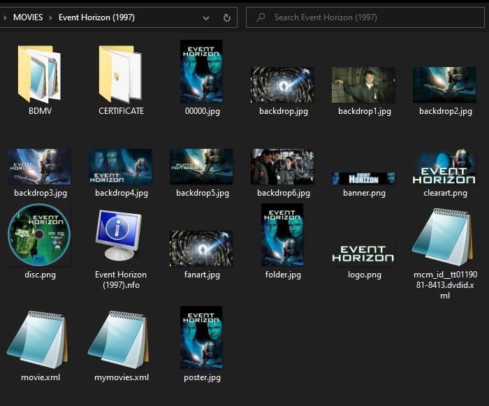

rms8 14 Posted June 1, 2022 Posted June 1, 2022 Was going to create a new topic, but this sounds pretty spot on to what I am seeing. Just re-installed Emby Server on my Server PC after I wiped it and re-installed Win10. I've noticed A LOT (hundreds) of movies are now displaying the wrong runtime. When I try to play that movie the run time bar at the bottom also reflects the same incorrect run time, meaning if the runtime shows 12m then the movie ONLY plays for 12 minutes so fast forwarding to the end doesn't work since I can't get to the end. I have already tried rescanning. No dice. I also re-ripped (and more than once) a few movies to test if it helps. No dice. Some examples below. ALSO note that in addition to the runtime issue I ALSO noticed that some of these affected files show the wrong video format too. Like Event Horizon below. I screen shot the actual folder and you can clearly see it is a ripped bluray. BTW I rip ALL my movies to their native folder structure. I prefer to keep it that way if at all possible. And before anyone asks....yes I converted one of the affected movies (Alita) to MKV and the correct runtime is now displayed. But I have nearly 2000 movies on my server and do not want to convert them all to MKV. Any ideas ?????
Cheesegeezer 3106 Posted June 1, 2022 Posted June 1, 2022 32 minutes ago, rms8 said: Was going to create a new topic, but this sounds pretty spot on to what I am seeing. Just re-installed Emby Server on my Server PC after I wiped it and re-installed Win10. I've noticed A LOT (hundreds) of movies are now displaying the wrong runtime. When I try to play that movie the run time bar at the bottom also reflects the same incorrect run time, meaning if the runtime shows 12m then the movie ONLY plays for 12 minutes so fast forwarding to the end doesn't work since I can't get to the end. I have already tried rescanning. No dice. I also re-ripped (and more than once) a few movies to test if it helps. No dice. Some examples below. ALSO note that in addition to the runtime issue I ALSO noticed that some of these affected files show the wrong video format too. Like Event Horizon below. I screen shot the actual folder and you can clearly see it is a ripped bluray. BTW I rip ALL my movies to their native folder structure. I prefer to keep it that way if at all possible. And before anyone asks....yes I converted one of the affected movies (Alita) to MKV and the correct runtime is now displayed. But I have nearly 2000 movies on my server and do not want to convert them all to MKV. Any ideas ????? ok so my ideas are Alita trailer has been picked up as the main source the other movies are in multi-part format.... bone collector-part1.mov, bone collector-part2.mov, etc I would first off delete nfo files --> identify the movie from IMDB ID or TMDB Id --> refresh metadata --> full Library scan. See if any of that works.

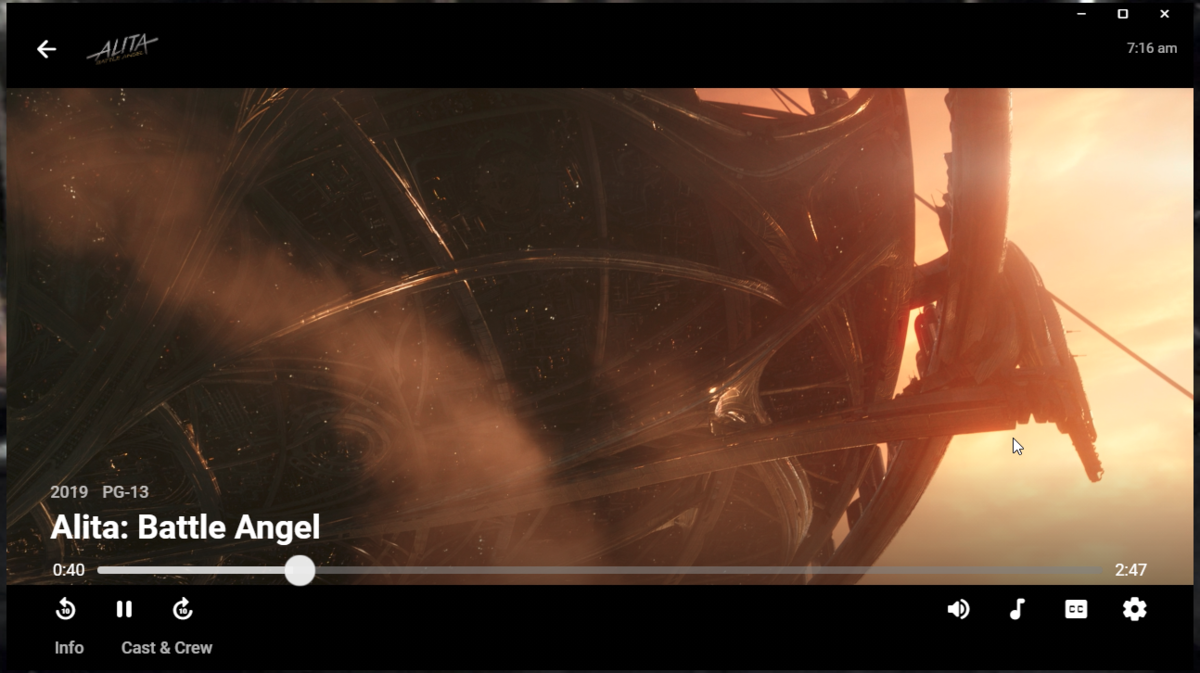

rms8 14 Posted June 1, 2022 Posted June 1, 2022 26 minutes ago, rms8 said: Will Do ! Thanks for the suggestion annnnd....looking forward to Iridium !!!! I did a search for *.nfo on all drives and deleted. Then ran a full library scan and metadata refresh. But it did not help. Here you can see when trying to play Alita, it only shows the movie being 3 minutes long :

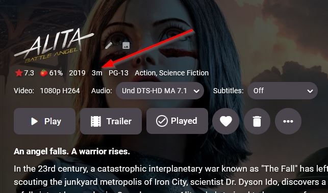

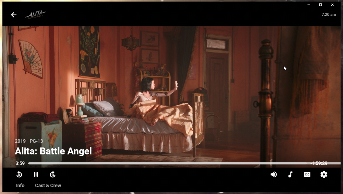

rms8 14 Posted June 1, 2022 Posted June 1, 2022 W A I T ..... I skipped to the end and THIS TIME the movie kept playing ....I stopped and went back to the library but it still shows 3 minute runtime. Going to check other movies now.
rms8 14 Posted June 1, 2022 Posted June 1, 2022 Sooo, as can be seen, the movie still shows runtime as 7min, but now it will continue to play beyond that 7 minutes. Weird.....

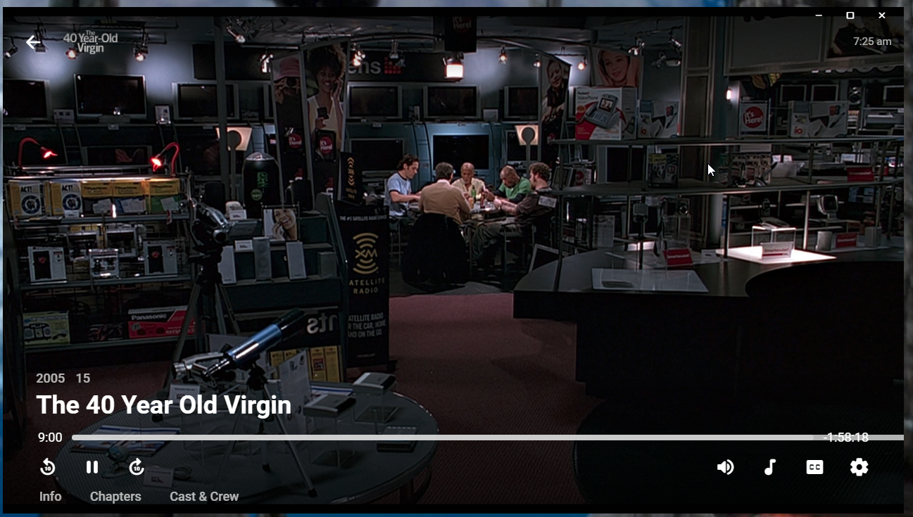

rms8 14 Posted June 1, 2022 Posted June 1, 2022 (edited) In this example the server says the movie is 1 day 1 hour and 30 minutes long. It plays and when the movie actually ends (about 1.5hrs) it goes back to the menu as it should. After deleting the NFO's per Cheese's suggestion, perhaps I should delete the whole Movies library (spread across 3 drives) and rebuild it from scratch. I'll let you know how that goes. U P D A T E : After deleting the libraries, then re-adding them from scratch the movies still show the very incorrect runtimes, but at least they appear to be playing through to the end. I've only checked two of the hundreds, but assuming they will all behave the same at this point. I suppose I can live with this very odd discrepancy, but it disables one of the very cool features which is the one which displays what time the movie would end if you started it right now. Any other ideas on how to get Emby server to display the correct runtimes on these movies? To recap, I deleted ALL the NFO files, un-selected that from the library menus, deleted the library and rebuilt from scratch. Thanks all, Rob Edited June 1, 2022 by rms8
