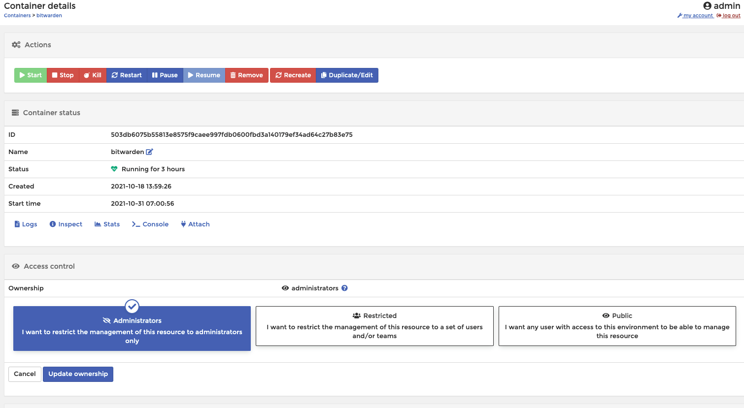

gretagarbo 3 Posted October 31, 2021 Posted October 31, 2021 Hello! I had issues with my emby container not seeing one of my folders so I recreated it to investigate. Bad luck I set it to private (not administrators) so i can't access it or freeing the ports (You'll see i've tried to create another instance). Last but not least i'm not at home but i can access my openmediavault server. I know it's more about docker than emby but i didn't find how to set it to administrators or reinstall from scratch docker on openmediavault 6 alpha. To make it short i want to remove cool_borg. Thank you for your help!
CassTG 113 Posted October 31, 2021 Posted October 31, 2021 (edited) In portainer: Click on the faulty docker 2nd box down is access control so click on change ownership set to admin That should do it Edited October 31, 2021 by CassTG

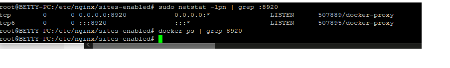

gretagarbo 3 Posted October 31, 2021 Author Posted October 31, 2021 (edited) Thank you @CassTG I couldn't do it. I purged docker-ce and reinstalled it. I re-created emby from scratch but portainer says "ports 8096 and 8920 are already allocated". I don't know how to free my ports because the only containers i see are portainer and emby. Edited October 31, 2021 by gretagarbo added output of grep 8920 (same for 8096)
CassTG 113 Posted October 31, 2021 Posted October 31, 2021 (edited) Are you setting your dockers up on Host Network? As Creating a custom bridge network is seriously the best way forward I presume you are not running behind a proxy ssl but going direct? You could technically just map different ports as a worst case if you cant wipe the server i.e map 8921:8920 that way public access is via port 8921 which maps internally to emby as 8920 and then change the public port in Emby settings itself whats the output of docker container ls --all Also after you purged docker did you remove the folder below which is where all images volumes etc are contained just to make sure. Obviously doing this will wipe everything so if you done a scan in emby it would start a fresh Quote WARNING - this deletes everything images, volumes all data etc so only do if you are happy starting a fresh sudo rm -rf /var/lib/docker If you did do a scan you could backup your emby data volume folder and move out of this folder to root temporarily then move back once you reinstall docker Edited October 31, 2021 by CassTG

Solution CassTG 113 Posted October 31, 2021 Solution Posted October 31, 2021 I would Remove Docker as per their instructions then execute the comand above Reboot and check the netstat command again before reinstalling 1
gretagarbo 3 Posted October 31, 2021 Author Posted October 31, 2021 I did what you just said and I works @CassTG Thank you 1
