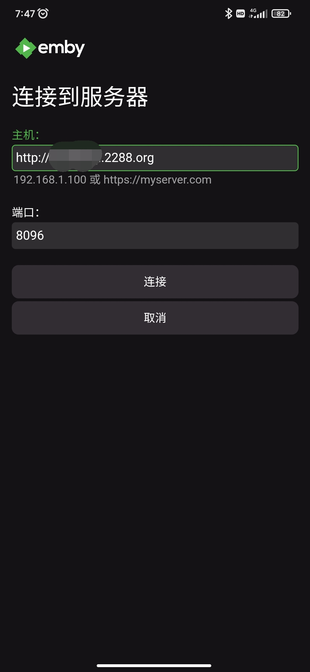

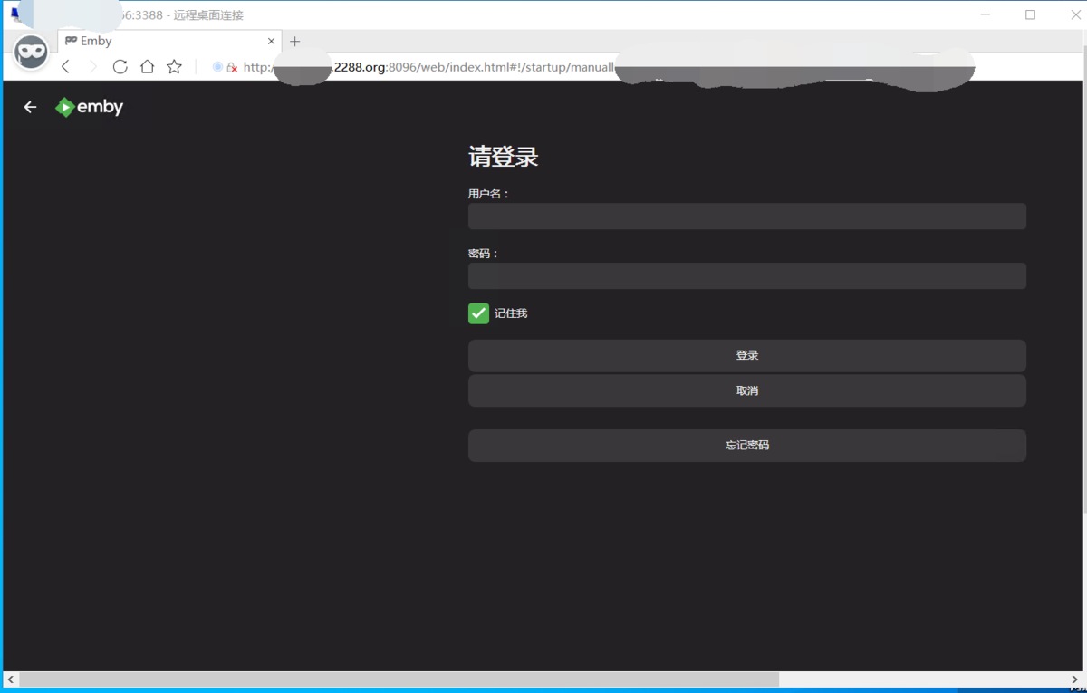

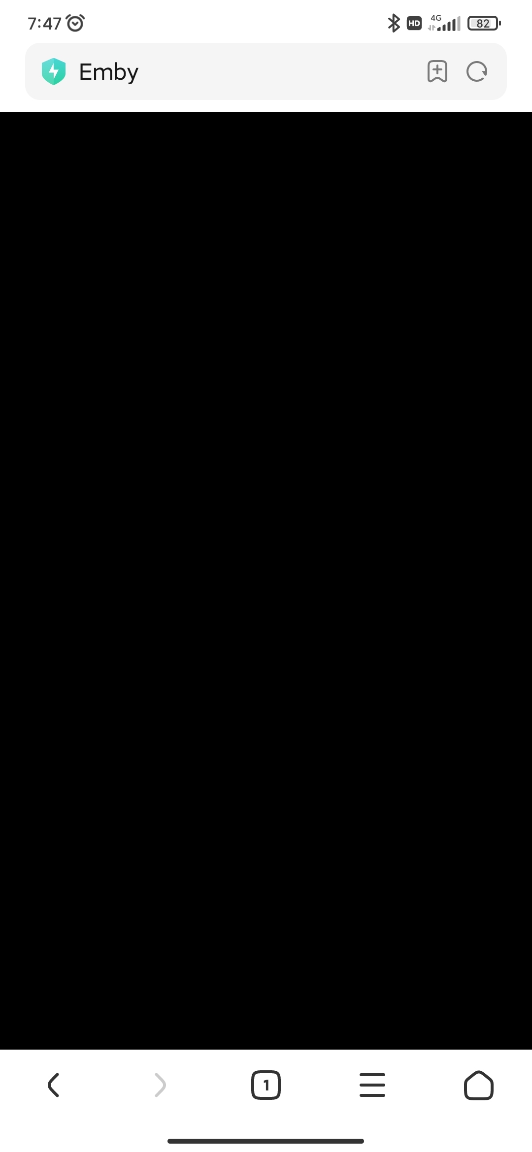

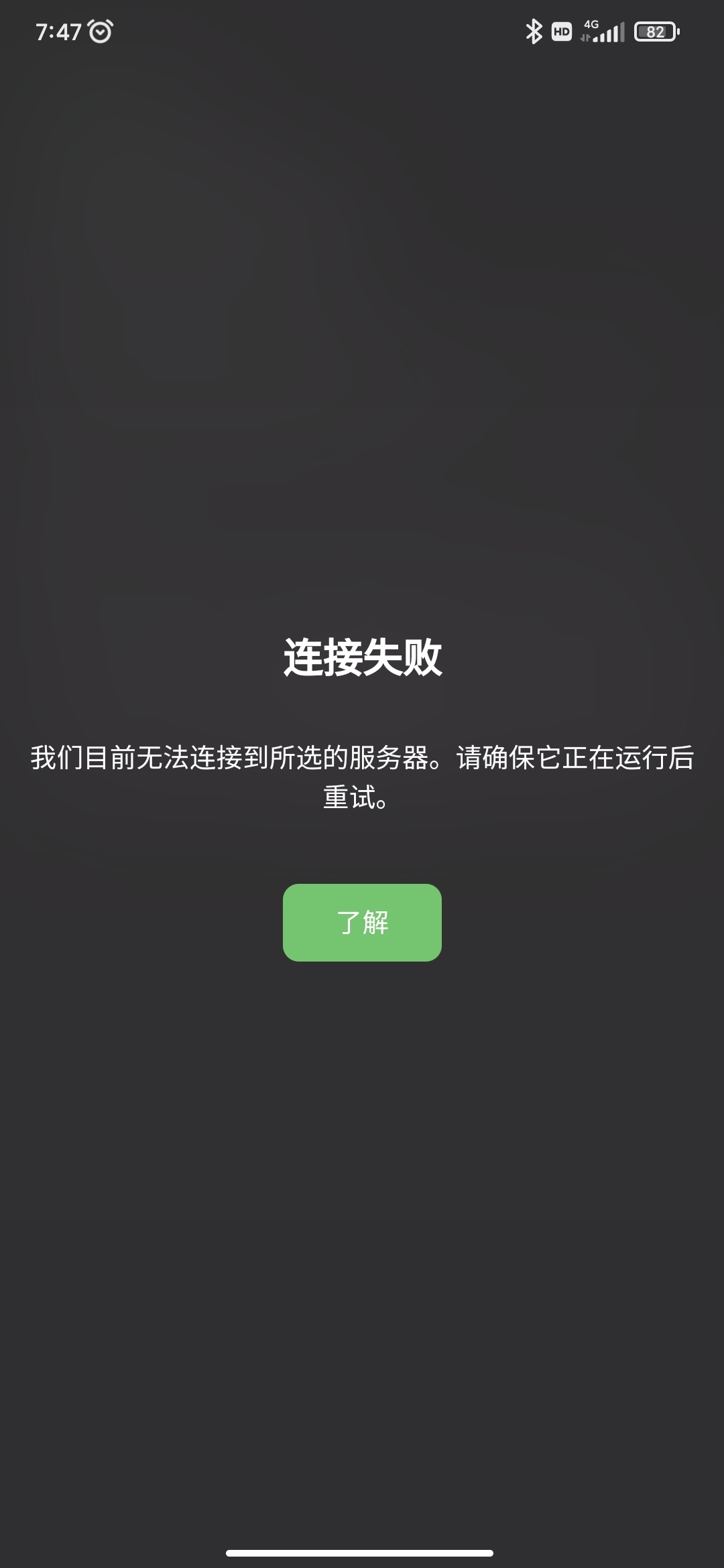

Solution Villager 1 Posted October 31, 2021 Author Solution Posted October 31, 2021 (edited) The following images are all remotely accessed The first one is a remote PC browser, which can be opened and logged in normally. The remaining three are all remotely accessed from an Android phone, the first is from the phone's browser, and it only shows a black page,The input address is http://Mydomain:8096, jump address is http://Mydomain:8096/web/index.html, but can't jump landing interface. The second and third ones are for android mobile APP login, the connection failed. And in the same Android phone APP, with public IP access, also can be logged in normally. but that the DDNS domain name is abnormal, and my home broadband is dynamic IP. At present, it is tested in three different networks under the group hui, but it cannot be remotely accessed by DDNS through AAP, while the router uses ROS, Aikuai and H3C "Connection failed, we cannot connect to the selected server. Make sure it is running and try again". Edited October 31, 2021 by Villager

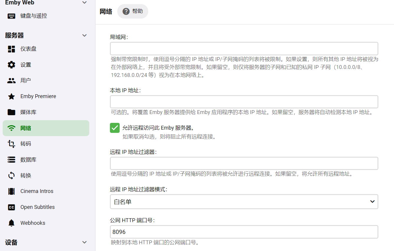

Carlo 4561 Posted October 31, 2021 Posted October 31, 2021 What do you mean by "jump address"? If that's a redirection service forget about trying to use it. Your mobile connection is showing a domain setup but your server is setup using IP. These should match. If you are going to use a domain, enter that in Network menu domain name field.
Villager 1 Posted October 31, 2021 Author Posted October 31, 2021 It may be that my description is wrong, http://Mydomain:8096, the address after opening is the following, http://Mydomain:8096/web/index.html, not like the URL in the first picture to log in interface

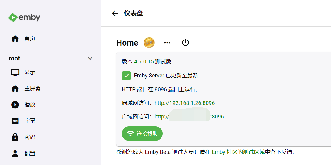

Carlo 4561 Posted October 31, 2021 Posted October 31, 2021 Does Emby dashboard show the remote connection using the same domain?
Villager 1 Posted October 31, 2021 Author Posted October 31, 2021 (edited) Thank you, everybody. Problem solved. DDNS service provider problem, changed a service provide, No problem Edited October 31, 2021 by Villager 1
