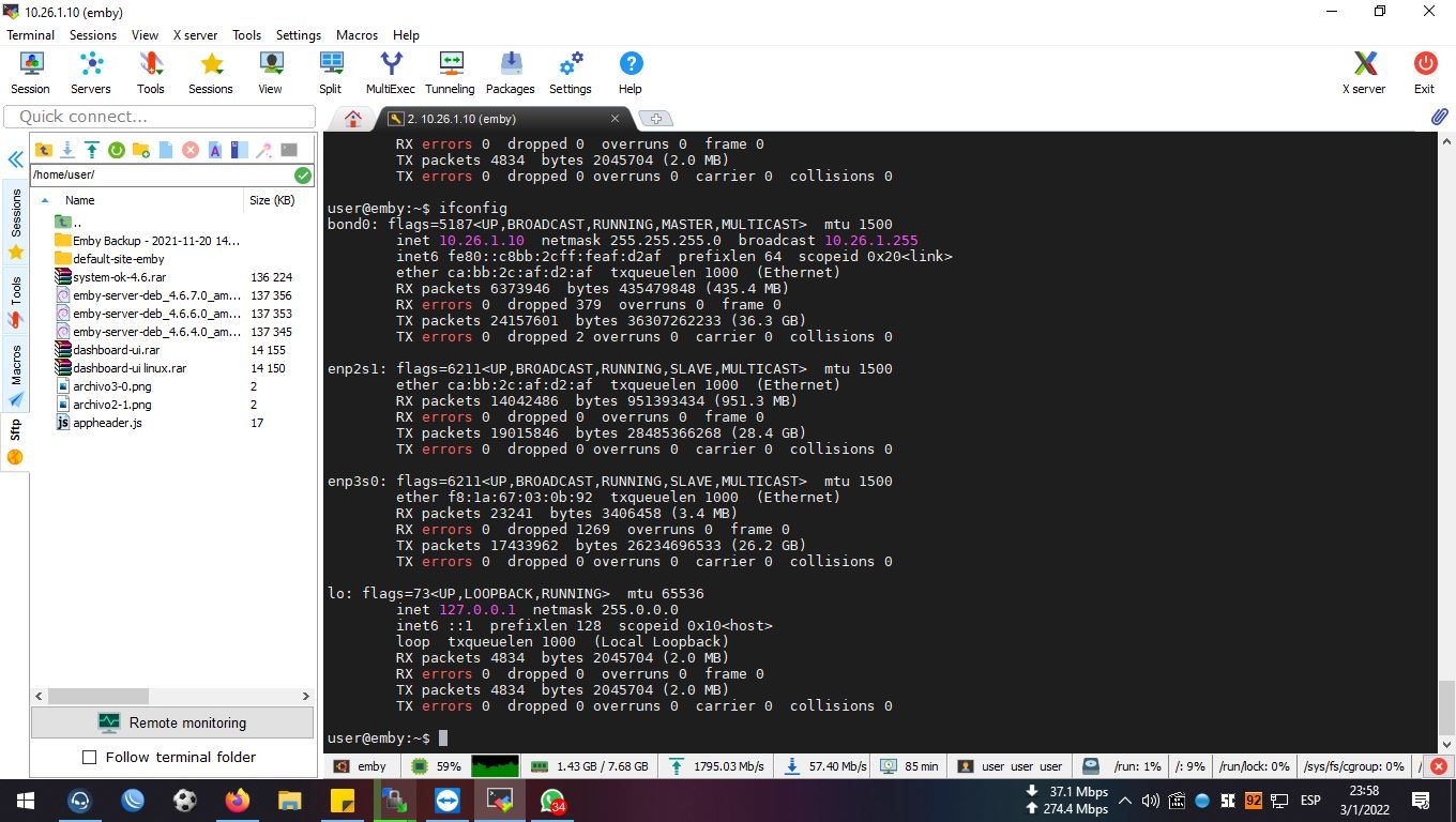

Mstinga 6 Posted December 31, 2021 Posted December 31, 2021 (edited) Good evening and congratulations to all of you, if any of you are using Nginx as a reverse proxy, the same thing happened to me that the Emby service stopped or gave an error, I started to check carefully and eliminate the Nginx server and buff the server It is running without any problem, now it is much faster, and it has been a week without problems, this could be the solution to those who are experiencing the same thing as me. Currently I have 651 users and simultaneously I have about 107 users online and the server has not presented any more problems since I did the ones I raised. Edited December 31, 2021 by Mstinga 3

Mstinga 6 Posted January 4, 2022 Posted January 4, 2022 Here is a photo of the optimization that we achieved 2
