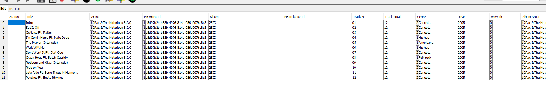

thelanranger 11 Posted October 26, 2021 Author Posted October 26, 2021 I did that all. The screenshots are showing how the data is displayed in jaikoz and emby and then how it is not displayed properly. How do I resolve this?

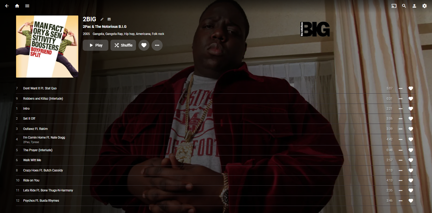

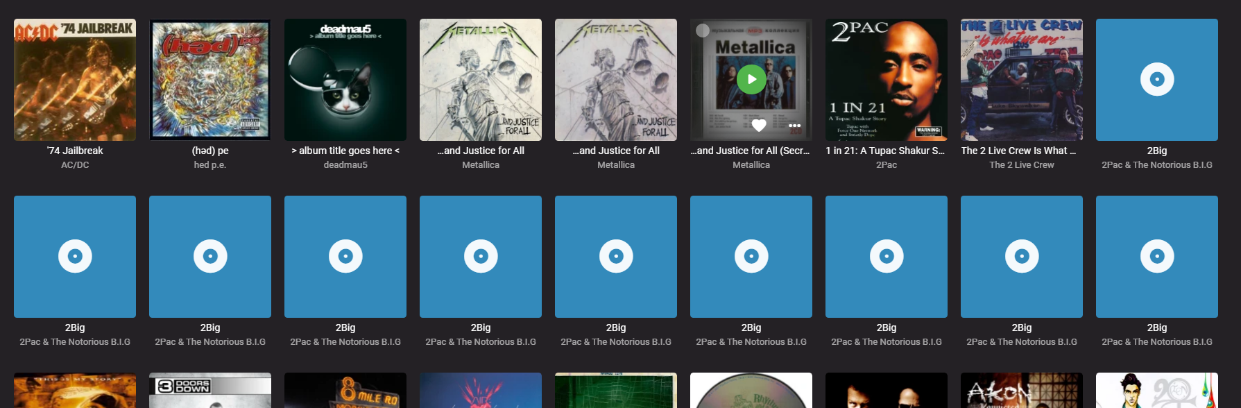

thelanranger 11 Posted October 27, 2021 Author Posted October 27, 2021 This is a good example but I have a bunch of stuff that does the same as this. The naming is all correct and it doesn't have a MB id available so I blanked those tags out. When emby scans it it makes every single song its own album folder with blank artwork. It's killing me, softly. 2Big.rar

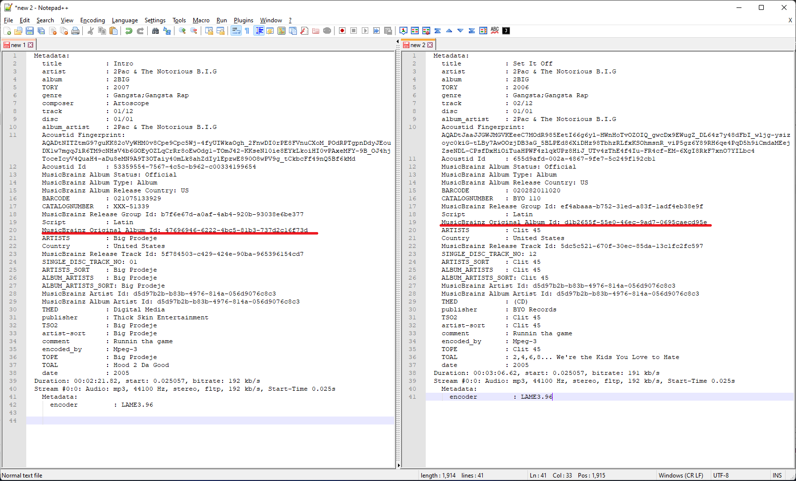

Luke 42287 Posted October 27, 2021 Posted October 27, 2021 13 minutes ago, thelanranger said: This is a good example but I have a bunch of stuff that does the same as this. The naming is all correct and it doesn't have a MB id available so I blanked those tags out. When emby scans it it makes every single song its own album folder with blank artwork. It's killing me, softly. 2Big.rar 49.97 MB · 2 downloads Easy answer - the songs are all tagged with different musicbrainz album ids (and different release group ids). Please note - these tags are not required, but if they are present they will be used and therefore need to be correct. So you have two options - fix them so that all values are the same for every track, or just remove them altogether.
Happy2Play 9814 Posted October 27, 2021 Posted October 27, 2021 (edited) Yes as Luke mentioned. Even thought I did not see these differenced in mp3tag, they are visible via ffprobe which is what Emby uses to read metadata. So I am guessing there are multiple embedded tags versions. This causes track 1 and 2 to be different albums along with different release groups also. Edited October 27, 2021 by Happy2Play

Happy2Play 9814 Posted October 27, 2021 Posted October 27, 2021 (edited) I am guessing there are different tag versions going on here as the this image is not seeing everything ffprobe sees. Edited October 27, 2021 by Happy2Play
thelanranger 11 Posted October 27, 2021 Author Posted October 27, 2021 I just looked at these in Jaikoz and the tags you were describing are labeled as "MB Original Release ID" and stripping them out did nothing. I also can't even see that tag at ALL in mp3tag so I'm not really sure why you're reading that instead of the MB Release ID?
Happy2Play 9814 Posted October 27, 2021 Posted October 27, 2021 (edited) 50 minutes ago, thelanranger said: I just looked at these in Jaikoz and the tags you were describing are labeled as "MB Original Release ID" and stripping them out did nothing. I also can't even see that tag at ALL in mp3tag so I'm not really sure why you're reading that instead of the MB Release ID? All I can say is Emby uses ffprobe to read embedded tags. So you can not reliably depend on what any other program sees or write. But when there are conflicts like this I alway nuke all tags and retag. I have already shown it is possible with your media. Here are your files with stripped MBZids, what do you get? But yes my example mis-identified the album on MBZ query. 2Big.zip Will remove files in a day or so. Edited October 27, 2021 by Happy2Play

thelanranger 11 Posted October 28, 2021 Author Posted October 28, 2021 I removed the other tag that shows up in Jaikoz and it didn't change the display in emby. Neither mp3tag nor Jaikoz is showing the tag that is referenced in Happy2Play's post. The only way I can see it in Jaikoz is to dig into the preferences and specifically add a column (this is a paid program btw). Once I did that and removed the tag on those file and rescanned then they still showed up the same. I'll download his stripped out copy and replace it to test, but it seems like you're reading unconventional tags? And also, this brings us back to the whole "why can I just turn all this off?" thing and "why can't I see any of this information in the metadata manager?" thing.
