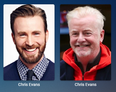

MBSki 1116 Posted October 25, 2021 Posted October 25, 2021 Why are these 2 different people getting linked together? I favorited Chris Evans (aka Captain America; IMDB: nm0262635) and Chris Evans (IMDB: nm0262632) from Bob the Builder was favorited too. The IMDB numbers are different so these are clearly 2 different people. It seems to be doing a name match only. Is this a bug? Any known workaround?
