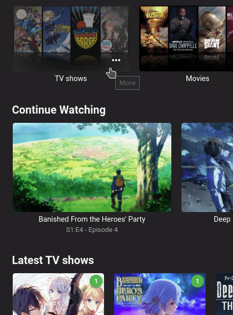

zofryer 5 Posted October 25, 2021 Posted October 25, 2021 (edited) So, sonarr just added something to my library. So I'm looking for it on Emby. Emby doesn't see it yet. So I right click TV and tell it to rescan library files. And if it feels like it, it does. But usually I have to force it to do it's job. I get ignored, so I restart the entire Emby server then tell it to rescan TV's library files and wow, like magic that works. Please fix this. I shouldn't have to kick your server to get it to do it's job. That's just sloppy coding. Make actions immediate. Note: there's a linux kernel utility called "inotify". It monitors filesystem inode changes. It was written by John McCutchan I believe. Your developers might want to use it. Food for thought. Edited October 25, 2021 by zofryer

zofryer 5 Posted October 25, 2021 Author Posted October 25, 2021 (edited) I mean I guess I could take a screenshot of Scan Library not working. You right click on a category, tell it to rescan library, and it does absolutely nothing. You restart the server, and tell it to do it, boom you get your pretty green circle and it counts up to 100 percent over a short spam of time, and your addition to your library shows up. So it feels like Scan Library has some sort of pointless or needless sanity check. Something that makes the experience dumb. I'll go further. Typically when something like this happens it's because of "asset bleed". You have a convenient config file or xml that covers a general area, so you just throw that other managable in there with it to consolidate. Then bam, something like Scan Library has a "check if this has ran in the past five minutes and queue it to run in two minutes" instead of a "do this immediately." Hope this helps. Edited October 25, 2021 by zofryer
CassTG 113 Posted October 25, 2021 Posted October 25, 2021 (edited) I know sometimes when i trigger a scan library from the home screen (via 3 dot menu) rather than in the settings (complete library scan), it does appear to do nothing for a minute or two, but if i refresh the page then it does show the circle on the category box eventually. Where as triggering a full scan from settings - library does appear instantly and shows in the Dashboard Edited October 25, 2021 by Happy2Play edited per request
zofryer 5 Posted October 25, 2021 Author Posted October 25, 2021 (edited) Yeah, that's the pause. it's needless. They should be looking for inotify kernel events, using them to know when a file is showing up, and just adding the new file. In the very least the Scan Library function should work immediately. For now I'm just going to keep restarting Emby to force it to act normal and Scan when it's told to do it. Edited October 25, 2021 by zofryer

zofryer 5 Posted October 27, 2021 Author Posted October 27, 2021 Ok, I'm going to reproduce the event to time it for the logs and I'll see if I can find a little animated gif creator. Motion will be needed to show it not working. Should be fun! Gimme a bit. 1
zofryer 5 Posted October 27, 2021 Author Posted October 27, 2021 embyserver.txt Here ya go. I've included animated gifs of it working and not working right. Here's my latest log. Thanks In Advance 1
