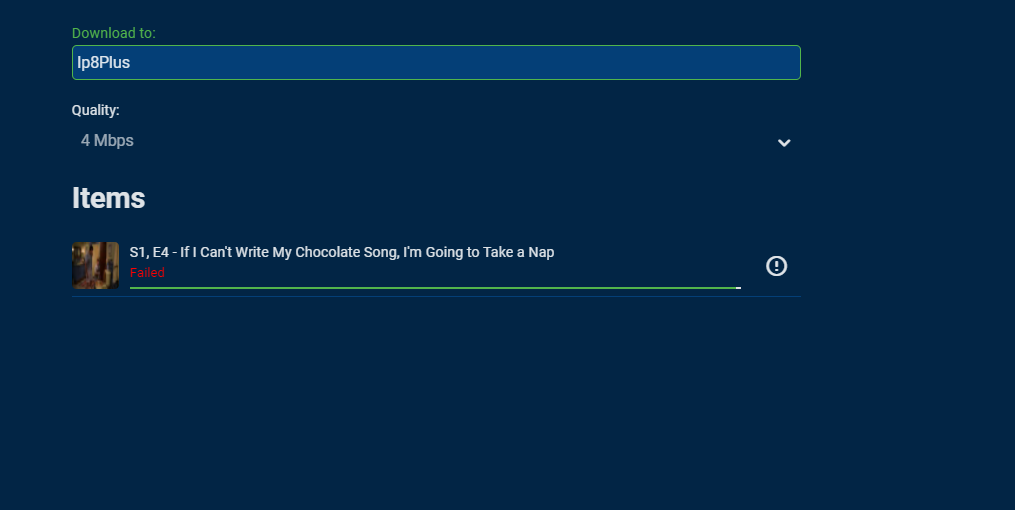

raudraido 48 Posted October 25, 2021 Posted October 25, 2021 Never have I ever successfully downloaded media to a device with transcoding. It fails all the time. What is the problem here? Emby shows "failed" after transcoding. Tried another emby server, downloaded to same device and it works. embyserver (2).txt ffmpeg-transcode-780c1803-1ab4-42c0-a5b1-0abc51872928_1.txt
Luke 42197 Posted October 25, 2021 Posted October 25, 2021 There was apparently an error during the conversion process. As a test, in server transcoding settings try turning off hardware transcoding and see if that helps.
raudraido 48 Posted October 25, 2021 Author Posted October 25, 2021 12 minutes ago, Luke said: There was apparently an error during the conversion process. As a test, in server transcoding settings try turning off hardware transcoding and see if that helps. Yes, it works without hw transcoding.

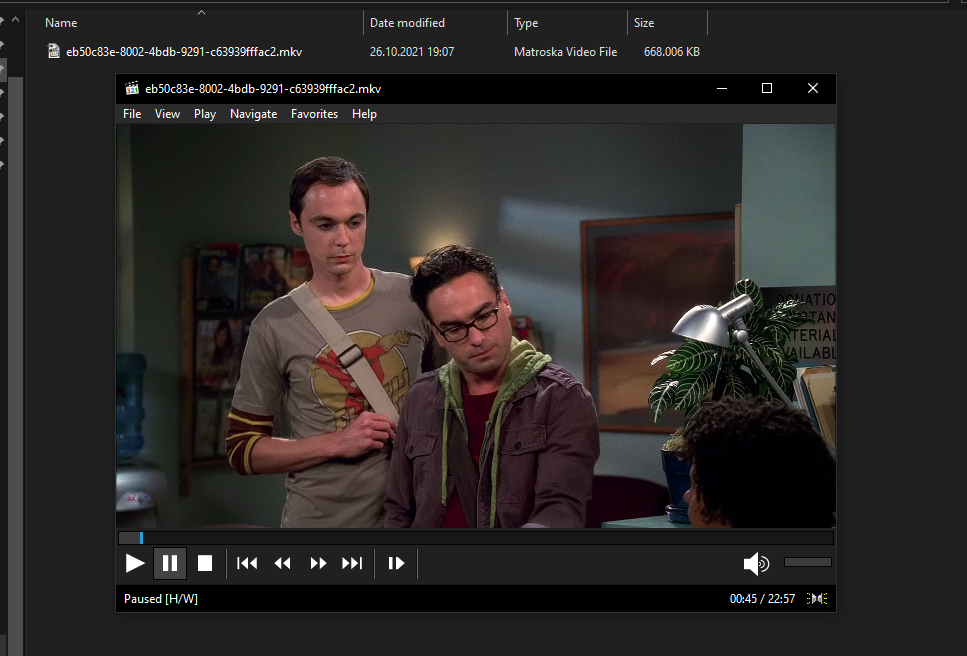

raudraido 48 Posted October 26, 2021 Author Posted October 26, 2021 1 hour ago, softworkz said: It's connected to the Radeon, right? You need to go into the BIOS and go through all settings regarding graphics: Make sure to enable something like "Dual Graphics" or multi-xx or Onboard+External, etc.. There's somewhere a setting that allows to configure graphics memory for the onboard graphics => choose the maximum Reboot & retry Bios has those settings in place. Yes, monitor is connected to radeon. It still transcodes file, and it appears in temp folder. After transcoding, it should start transfer, then fails.
softworkz 5129 Posted October 26, 2021 Posted October 26, 2021 Ah - my mistake. I thought that it would have ended prematurely in error. But the video length is just 21min. So it transcodes to the end, but exists with error. Due to the error exit code, the sync process gets stuck. Please give me some time to investigate. Thanks, sw
