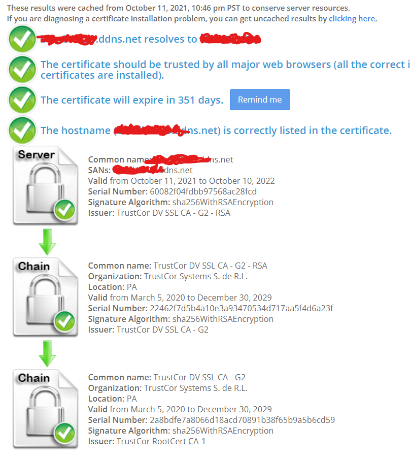

bandit8623 226 Posted October 24, 2021 Author Posted October 24, 2021 (edited) 12 minutes ago, ebr said: Hi. Is your SSL Cert from Letsencrypt? no-ip and its up to date. just tested my cert on 3 sites all green. all the other apps connect just fine remotely Edited October 24, 2021 by bandit8623

ebr 16337 Posted October 25, 2021 Posted October 25, 2021 16 hours ago, bandit8623 said: no-ip and its up to date. just tested my cert on 3 sites all green. all the other apps connect just fine remotely Did you "click here" to get uncached results?
bandit8623 226 Posted October 25, 2021 Author Posted October 25, 2021 2 hours ago, ebr said: Did you "click here" to get uncached results? Yes All green

bandit8623 226 Posted October 26, 2021 Author Posted October 26, 2021 (edited) 6 hours ago, Luke said: Let us know how you get on. Thanks. The sideload app works. I do get a notification to accept the ssl cert though. Connected right up after this screen. here is my phone when looking at the cert from my cellular data./ Edited October 26, 2021 by bandit8623
