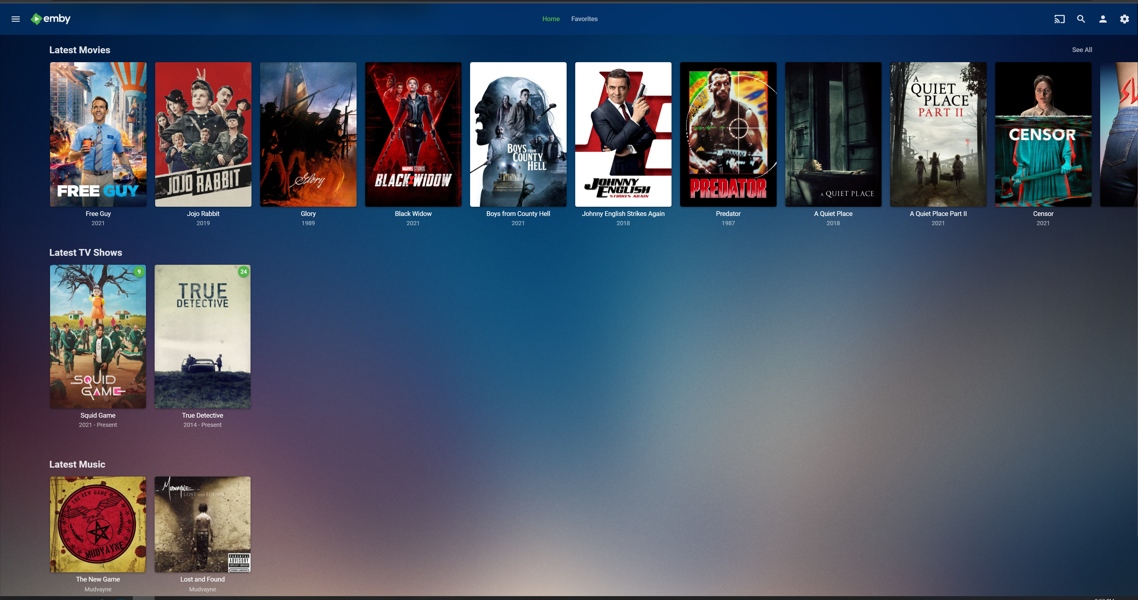

suprasaiyan123 3 Posted October 22, 2021 Posted October 22, 2021 (edited) Greetings all, my home screen over the last few months seems to have limited the amount of new content displayed for tv shows and music (movies are fine), this was something I hoped was going to be fixed by a new release, but i'm not sure if this is common or just me, nothing on the backend has been changed, unfortunate that new media is getting lost in the shuffle though. Screenshot added to depict the issue. Any assistance is greatly appreciated, thank you! Edited October 22, 2021 by suprasaiyan123
seanbuff 1353 Posted October 22, 2021 Posted October 22, 2021 Go into your Library settings and confirm your 'TV Shows' library type is set to 'TV Shows' and not 'Mixed Content' 1 3
suprasaiyan123 3 Posted October 24, 2021 Author Posted October 24, 2021 On 10/21/2021 at 10:28 PM, seanbuff said: Go into your Library settings and confirm your 'TV Shows' library type is set to 'TV Shows' and not 'Mixed Content' Thanks! @seanbuff that seems to have fixed it, a bit annoying though since these were never setup as mixed content initially
Happy2Play 9802 Posted October 24, 2021 Posted October 24, 2021 3 minutes ago, suprasaiyan123 said: Thanks! @seanbuff that seems to have fixed it, a bit annoying though since these were never setup as mixed content initially Yes there is a bug somewhere that has caused content type to change for some reason on some setups. Can only guess as the method of storing content type has changed over the years. But since we have seen this issue several times there is a guide to change content type if you do not want to remove and readd library. But sounds like you resolve the issue yourself. How to Change the Content Type for a Library - Tutorials and Guides - Emby Community 1
