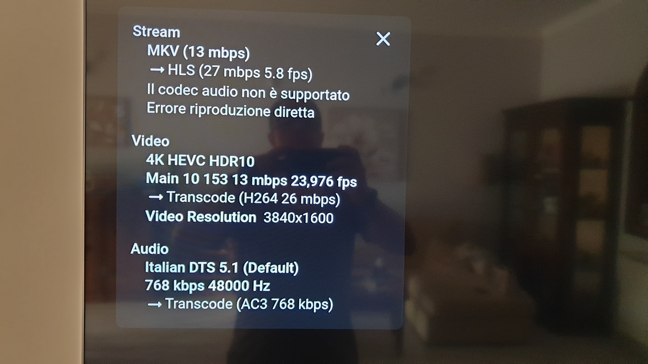

teicang 34 Posted July 2, 2022 Posted July 2, 2022 On 6/30/2022 at 12:24 AM, SamES said: lease let me know if you see new firmware updates for your TV, then we will have to work out how to test this Just checked, no update yet. Another questione about DTS and remux, if remux is due to my TV capabiities why before the release 4.7 or the test emby App it works without remux? I 'm sure to have seen movies with dts in the first track before the change and therefore with direct play , otherwise my Nas blocked,that now remux and therefore I'm not be able to play . Is this possible? Is the new server release 4.7 that change this behaviour? Thx
FrostByte 5453 Posted July 2, 2022 Posted July 2, 2022 Samsung removed the DTS decoder on all TVs starting in 2018. So, if your TV is >= 2018 the Emby app has always remuxed your files on the fly and you may have just missed it. Check the back of your user's manual for a chart that looks like the one in the link. Anything not in that chart the app will convert. If you want to test it out, just turn off transcoding on the server. 2021 TV Video Specifications | Samsung Developers
teicang 34 Posted July 2, 2022 Posted July 2, 2022 Hi Frost , i confirmed my TV not support the DTS , is a new TV But i don't undestand why before to update the emby server to 4.7 the movies with DTS works , i saw several 4k DTS movies and or the emby not remux or the remux was different and my Nas was enought to process. Now the CPU reach 100% of load the movies starts but after 1 secomd freeze. To passivate this function I have to connect with PC or can I do also by android app? Wich is the function to turn off? If I turn off the remux I will hear the sound however or not ? Another test I will perform will be to load back the official TV emby App without the last modification done by Sam and see if something change.
SamES 1084 Posted July 2, 2022 Posted July 2, 2022 It would have worked previously without transcode, but it would have been doing a remux. Transcode is converting the video, remux generally only touches the audio (at most). Remux has very low overheads and you probably wouldn't even have noticed it. You're transcoding at the moment as I introduced a change to try and improve the problem, but it actually made it worse. But it proved that my other change worked. It will all be good for you in the next USB release. 1
teicang 34 Posted July 2, 2022 Posted July 2, 2022 Ok now could be more clear, transcoding is for video and this create me problem, remux is for audio and if happen this should not create high CPU load and therefore no problem for me. Now with the actual modification not only the emby remux audio as before but in the same time also transcoding and therefore the movies stop I noticed also another little problem with the server , @Luke I transferred in ftps as usual 3 new movies inside a folder I use for emby, 1 movies happen immediately on the library , the other 2 no, I tried to refresh the folder , stop and start the server but the movies not happen, I checked inside the nas folder and they are present, any idea? Good night Sam&Frost&Luke
teicang 34 Posted July 3, 2022 Posted July 3, 2022 Hi friend, the app actually online for download is the same I already loaded with the Sam modification? If yes discard the following info. If instead is without the Sam modification following what I noticed. i just load again the Samsung App official version 1.2.9 downloaded direct from your site.(replaced the last one modify by Sam ) The situation didn't change. The movies with Dts remix audio but forced also to transcode also the video. I'M sure before to update ser ver 4.7 i was be able to see it , i supposed was due to the modification done by Sam in the app, but is therefore some change happen in this new server version? Sorry for my questions but is just to undestand if with the new app i will be able again to see the movies or not actually the most of them didn't work. Or if I have to prepare myself to erase all the istallation and install again server 4.6 . I would like to avoid it because I will loose all my customization ,collection and so on . So long job to restore all of them have a hace Sunday...here very hot
SamES 1084 Posted July 3, 2022 Posted July 3, 2022 Next USB version with the fix is not released yet. Worst case it will be in 14 days as that's when the current USB release will expire, so it will be published before that. Hang tight, it will fix the issue for you. 2
teicang 34 Posted July 18, 2022 Posted July 18, 2022 good morning my friends yesterday just come back form one week off I immediately download the new APP. WOnderfull result from first tests :-))))))))) Now all the DTS track is playable, the movies is in direct play while the audio goes in transcode I also checked the AUDIO track swap and tryed to play 2 tranck in the list.....all works fine till now CONGRATULATION YOU HAVE DONE A REALY GREAT JOB Do you need some example picture? ciao \Gianni 1

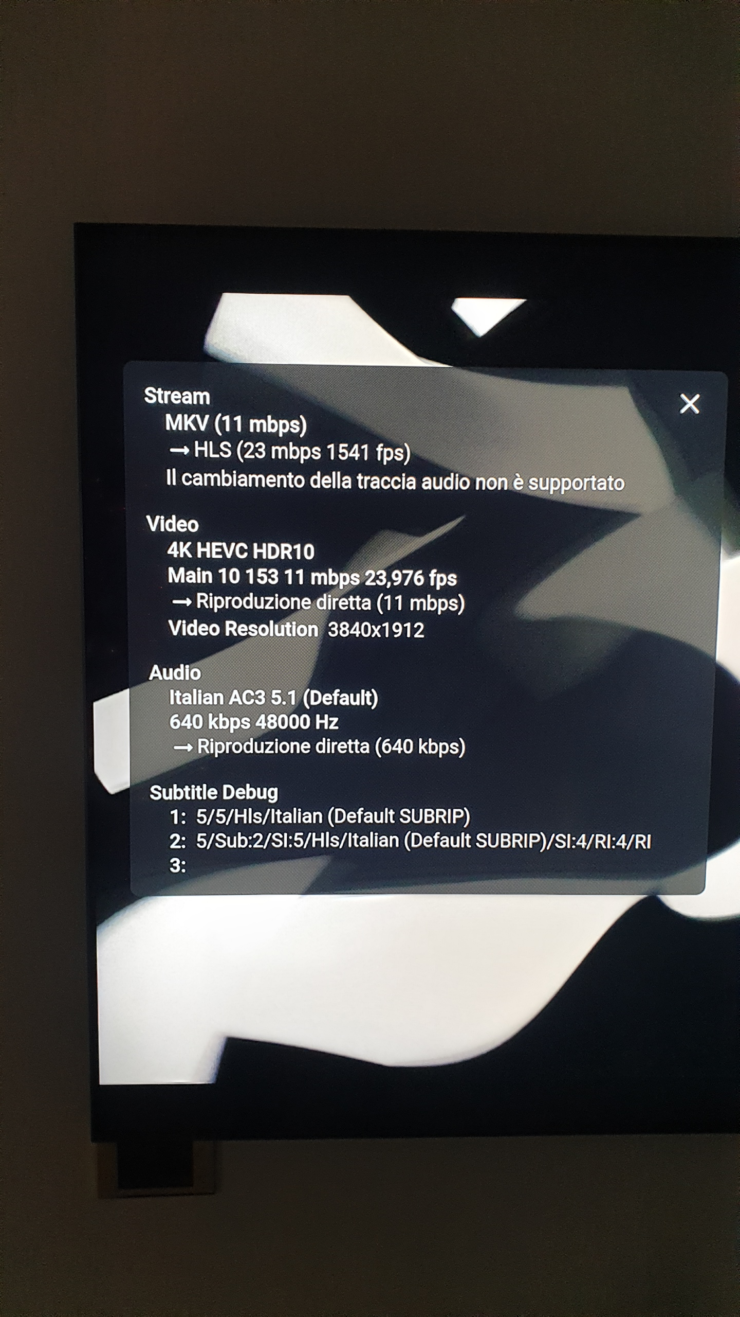

Barlog9511 17 Posted July 18, 2022 Posted July 18, 2022 (edited) Hello everyone In version 1.3.0 it is already possible to switch audio tracks ( thank you very much ) but what I noticed in the initial tests is that the video track never goes through Direct Play and in the logs there is a message "Switching audio tracks is not supported" Could someone please advise me what to do ? Thanks EDIT: In further testing I found movies where I still can't switch the sound track, but there again everything goes nicely through Direct play Edited July 18, 2022 by Barlog9511 1

SamES 1084 Posted July 18, 2022 Posted July 18, 2022 2 hours ago, Barlog9511 said: Hello everyone In version 1.3.0 it is already possible to switch audio tracks ( thank you very much ) but what I noticed in the initial tests is that the video track never goes through Direct Play and in the logs there is a message "Switching audio tracks is not supported" Could someone please advise me what to do ? Thanks For this year/model TV there is a firmware issue which Samsung has confirmed which is preventing the app from switching audio tracks on the client (which is required to do this and maintain DirectPlay). As a work around, when an audio track change is required, this is being confirmed on the server. In most cases, no conversion is done to the audio or video tracks, the track order is just switched in a new container on the server and it is delivered via DirectStream instead of DirectPlay. When Samsung release a new firmware update that resolve this problem then we can go back to changing audio tracks on the client and maintaining DirectPlay. 2 hours ago, Barlog9511 said: In further testing I found movies where I still can't switch the sound track, but there again everything goes nicely through Direct play I don't quite understand this bit. Can you please go over an example?

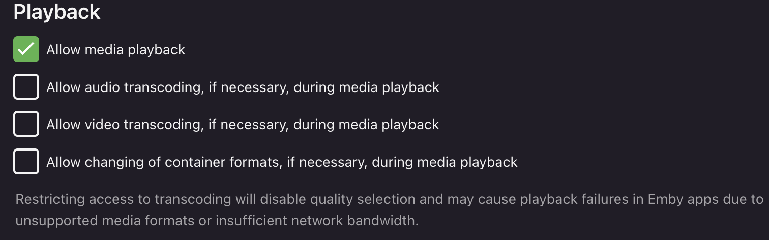

SamES 1084 Posted December 22, 2022 Posted December 22, 2022 @teicang, can you please check that you have the latest firmware, you will have to go to the Samsung downloads for your model and download and install if rom USB. There have been some new releases over the last few weeks, for example 65” Q80A QLED 4K HDR Smart TV (2021) | Samsung Support UK Please let me know which version you install Once you have the latest installed, to disable the server-side audio switching, turn off these setting (don't forget to save at the bottom of the page) Please try playback and check whether you can now select audio tracks - if you can, please confirm with Stats for Nerds that it is still DirectPlay For 2022 models, a recent firmware update has fixed their issue, so I hope this is also resolved Don't forget to turn these settings back on after testing.

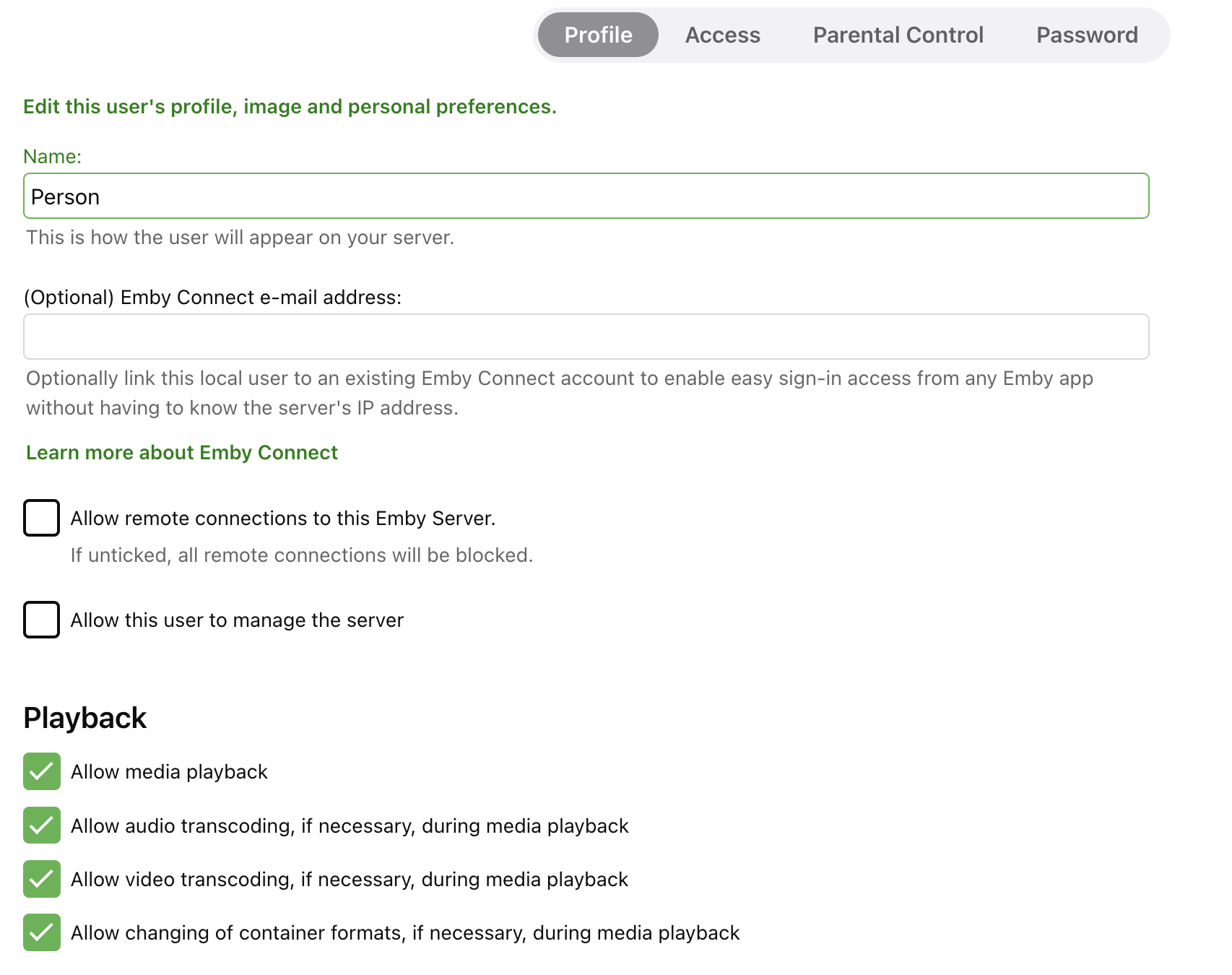

SamES 1084 Posted December 24, 2022 Posted December 24, 2022 14 hours ago, teicang said: Ps. Were do I found the setting you indicate ? From the TV app I don't see it ver. 1.4.9 Thanks. On the server, go to the settings for each user - it's a user setting

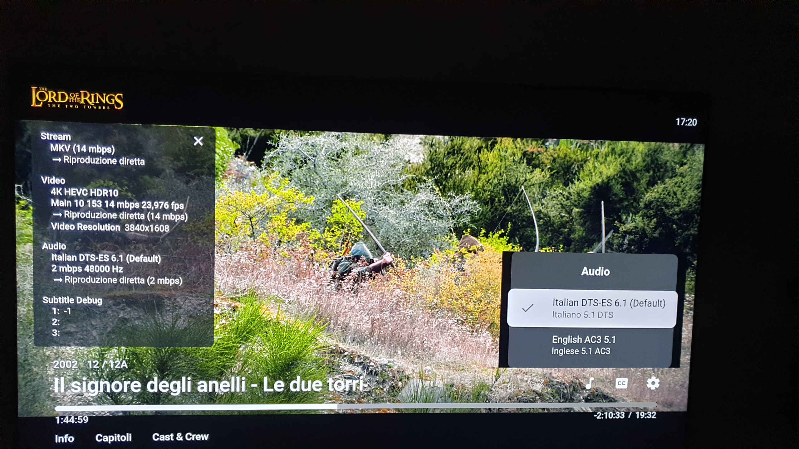

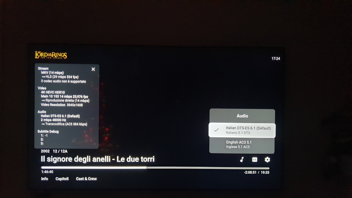

teicang 34 Posted December 29, 2022 Posted December 29, 2022 (edited) On 12/24/2022 at 10:06 AM, SamES said: Thanks. On the server, go to the settings for each user - it's a user setting Hi Sam, test done : first log OLD TV SW and no playback changed: (file old sw no change) after I update Samsung TV FW , version 2111 changed the playback setting and tryed to change languagge on the same movies, all works fine, I'm be able to swap form italian to english and vice versa. No log generated this time , the only one I saw looking the time when I have done the second test in the emby log is this : SW changed_sett changed _embyserver.txt Following the two screenshot of the nerds stat for both the test. no change Aftwr change new sw old sw no change_ffmpeg-directstream-31def5b2-c5c2-443f-9b8c-578e348881cc_1.txt old sw no change_ffmpeg-remux-9d999e38-2aac-4b0f-82b5-870e53d2305b_1.txt SW changed_sett changed _embyserver.txt Edited December 29, 2022 by teicang 1

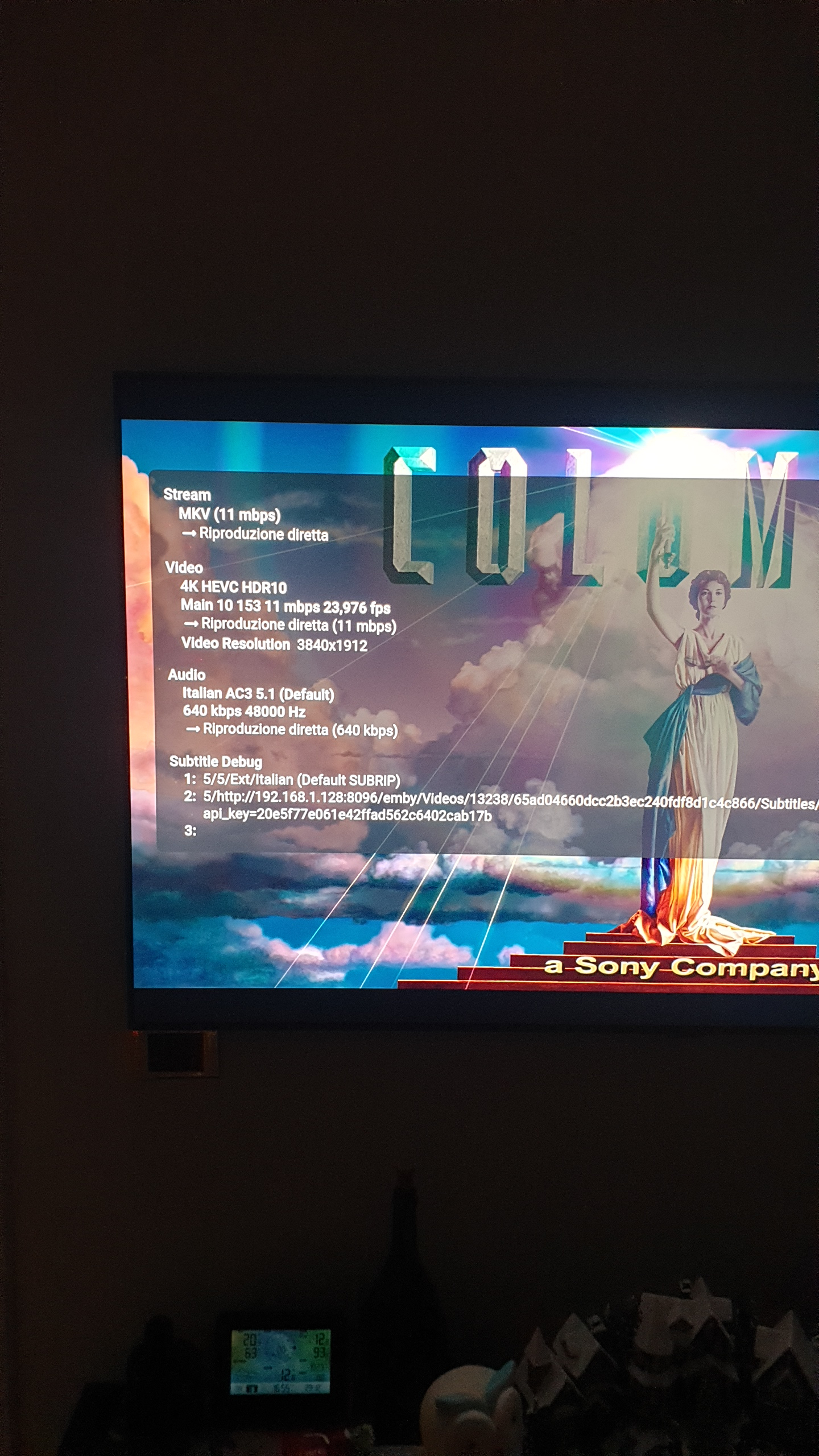

teicang 34 Posted December 29, 2022 Posted December 29, 2022 (edited) correction, I tryed another movie and without the playback feature ON the language change doesn't work. I tryed without the feature ON , only english works, and with the feuture ON , I can swap from English to Italian. The only thing I saw is that this movies is DTS while the other NO, if I remeber you asked me to test the DTS in the past test could be however ok because the Samsung not allow on tv DTS, if the transcode setting is off maybe i cannot swap the languagge in DTS following the LOG with feature playback OFF, ON , Playback off no swap Playback On swap and works ok playback feature activatedffmpeg-remux-f394355a-9c50-45f7-8c19-d86357478a12_1.txt playback feature activateffmpeg-remux-6eb7bed9-19e9-44b6-845a-34056254a8fb_1.txt Edited December 29, 2022 by teicang 1
SamES 1084 Posted December 29, 2022 Posted December 29, 2022 Perfect, that seems to confirm that the firmware fixed it. Yes, when you play a DTS track then the option 'Allow Audio transcoding' needs to be on, otherwise it won't be possible to play that track, so what you've observed is fine. Thanks!
