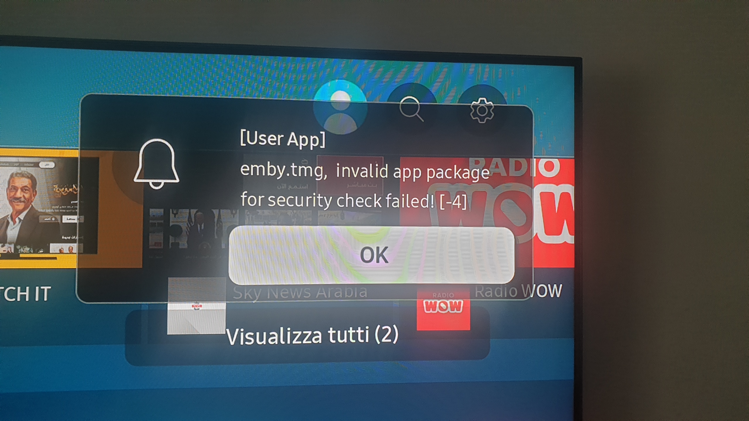

teicang 34 Posted February 26, 2022 Posted February 26, 2022 Hi Like unfortunately this pack is not loadable. I got this error when I try to install in the TV. Ciao Gianni
SamES 1084 Posted February 26, 2022 Posted February 26, 2022 (edited) Can you wait a few hours, then try again? If it still doesn't load then please report back. Edited February 26, 2022 by SamES
teicang 34 Posted February 26, 2022 Posted February 26, 2022 Ok Sam,ASAP I will come back in my house after lunch I will try again and post the result:-)
teicang 34 Posted February 26, 2022 Posted February 26, 2022 Hi tested again just now but same error. Impossible to load the app. Bye
