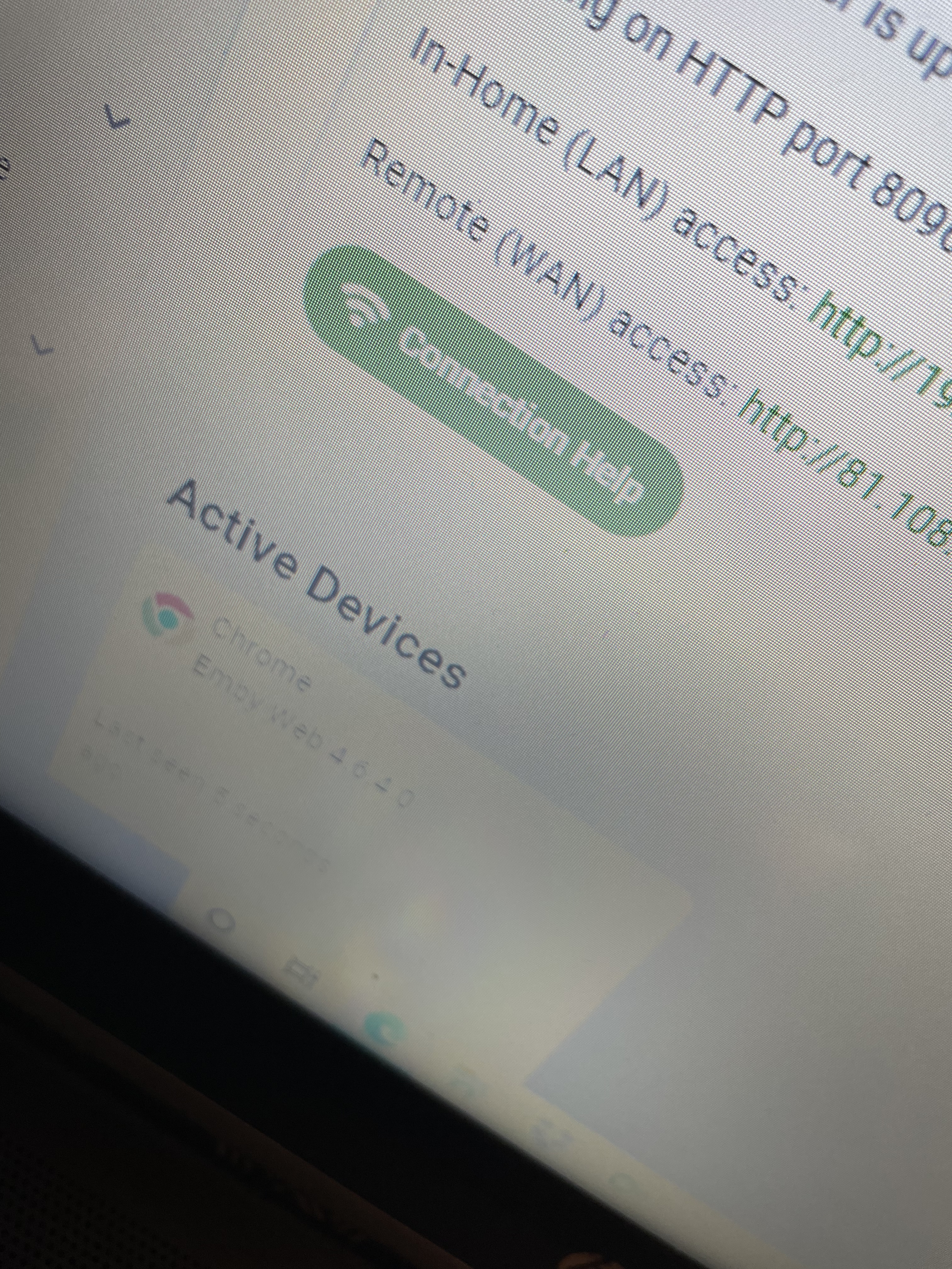

fivestartemby1 0 Posted October 15, 2021 Posted October 15, 2021 I have downloaded emby server, created an account on emby server & emby connect. I have downloaded 2 movies and put them in a folder which is the same folder I connected to my emby account and the 2 movies are now on my dashboard and when I pin my device all I get is the following in the photo I have attached. Do you have any advice? Is there anyway to check if my server is set for remote access? I would rather be able to connect a few of my friends and family up via the code, save any hassle. Make life easier.

fivestartemby1 0 Posted October 15, 2021 Author Posted October 15, 2021 Ok so I have now tried entering the In-Home (LAN) access url and Remote (WAN) access url into my mobile web browser with wifi connected which is the same wifi on my laptop with my emby server (laptop is also turned on with emby server open) and wifi also disconnected using mobile data and nothing loads. I have also noticed in the connectivity page it shows 2 buttons on the photo showing the urls and port, the buttons being Restart & Shut Down, I dont have these buttons on my dashboard, I only have a ‘connection help’ button. Photos attached below. Thanks for all your help!

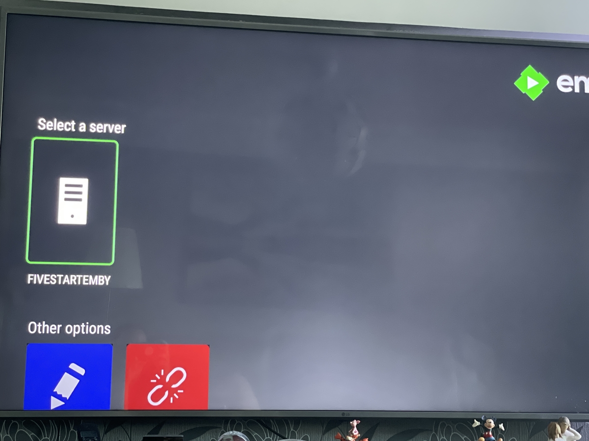

fivestartemby1 0 Posted October 15, 2021 Author Posted October 15, 2021 Ok done the above on my other laptop (macbook) opened right away and logged in. Wont work on mobile at all though… Emby is installed on my windows laptop and connected via wifi. My issue too is id like it to work when I connect the app with code via emby connect. Saves any hassle giving out the server address and port etc, just makes connecting friends & family devices easier. Right now when I connect the emby app on likes of firestick via the code on my emby connect it comes up with the photos attached below;
