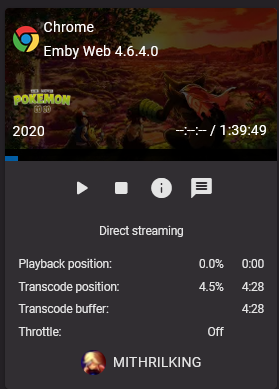

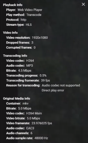

Jinhjy 2 Posted October 16, 2021 Author Posted October 16, 2021 Apologies for my delay/absence got super swamped with work. On 10/14/2021 at 9:46 PM, cayars said: Can you do this again but point out what works and what doesn't? I got a couple transcoding log files attached here for you. I noticed that for the ones that usually fail to play will create multiple transcoding files in the same play attempt, so that's why I made sure that naming for the log files are clear and a little easier to understand that they belong to same attempt and there was no attempt to skip forward in the attempts where it didnt work. As I am aware that usually new transcoding logs are created for skipping forward, like in Movie2's attempt where I did skip forward a couple of times. Since, a user and friend of mine was a little free they did a little testing remotely using Chrome Web while I was working, so I also attached the server log of that day (20211015) should probably see their activity around 2 am the movies and shows you might see them attempting to play should be with labels as to whether or not it worked: Quote Muppets mansion (x265 - worked), ida red (x265 -no), pokemon coco (x264 - no) Christine (x265 - no), mortuary collection (x264 - worked) Speed racer movie (x265 -no), speed racer anime (x265 - worked), shrek the third (x264 - no), yesterday (x264 - worked), the great wall (x265 - no), pacific rim uprising (x264 - worked), pacifim rim (x264 - worked), man of steel (x265 - no), zack justice league (x265 - no), birds of prey (x265 - no), gunsmith cats (x265 - worked), what if (x265 - worked), doom patrol (x265 - worked), injustice (x264 - worked), hobbit fanedit (x264 - worked) hitman bodyguard 2 (x265 - no), hitman bodyguard (x265 - no), search party (x265 - worked) There has been no correlation or change between remote and local on server machine attempts as to whether something will play or not, so I would consider my user's usage data just as good to analyze. On 10/14/2021 at 10:04 PM, pwhodges said: This can happen because of another aspect of the encoding, such as whether it is 10-bit - the effect of this varies critically with the means available for transcoding. Paul I dont believe this is the issue since rarely do I have 10-bit movies or media, and even the ones I do have previously played fine usually through transcoding, but idk maybe you're right. Here's a screenshot of the Media Info for one of the movies that doesnt work, you'll see its not 10-bit nor HEVC/x265: Lastly, I also attached the new logfile (20211016), since it includes a couple more attempts. Also it will include the following trials - transcoding log examples labeled as "Movie3-x264-Attempt2-Dashboard-Works". Which is something random that I tried is when I'm observing my user test playing the movies for instance. For those that dont work, I noticed it starts off "Direct Playing" for a second or two, then switches to "Direct Streaming" and starts to cache/transcode for a bit. [See four bellow screenshots] Now if I leave the user alone, the movie in this instance will fail to play and they will be stuck on that loading screen for a big, then eventually get the contact administrator pop-up message. However, if I click their media controls Play/Pause once or twice. The movie surprisingly will play, after blipping to "Direct Playing" for a second [See bellow screenshot], then to "Transcoding" like regular. When the movie does start to work and play for the user, while its transcoding, viewing the Stats for Nerds reveals that the reason for the transcoding is for some reason the Audio codec not being supported and a direct play error. Audio codec not being support being something that the user almost never had run into, especially with some of the movies they tried to play, since they worked fine before. Apologies for the brain, data and testing dump. Hope maybe you guys can possibly help me get closer to a solution more now. Thanks Movie1-x265-Attempt1-Did-not-Work-log1-ffmpeg-transcode-9ce1adac-05dd-4b69-9884-7f0594ef3460_1.txt Movie1-x265-Attempt1-Did-not-Work-log2-ffmpeg-transcode-34378561-c031-4dc8-a323-f66a21f8cac0_1.txt Movie1-x265-Attempt1-Did-not-Work-log3-ffmpeg-transcode-74c7be4d-1165-4a1f-a9f4-0da1de2a380e_1.txt Movie2-x265-Attempt1-Works-log1-ffmpeg-transcode-c5b7d1f1-a6da-45b9-be69-49d16c228e57_1.txt Movie2-x265-Attempt1-Works-log2-ffmpeg-transcode-db06972b-6527-40b0-857f-71c4149283b0_1.txt Movie2-x265-Attempt1-Works-log3-ffmpeg-transcode-a7c14c67-3837-492a-9a7f-d36740216d61_1.txt Movie3-x264-Attempt1-Did-not-Work-log1-ffmpeg-remux-33716ea8-8e2f-4abe-bf0d-d2716fb4334b_1.txt Movie3-x264-Attempt1-Did-not-Work-log2-ffmpeg-transcode-b9325944-d7f6-40ad-a381-1af11ed21571_1.txt Movie3-x264-Attempt1-Did-not-Work-log3-ffmpeg-transcode-cde06f9e-a365-4ba2-a02c-2c2c6668e06d_1.txt Movie4-x264-Attempt1-Did-not-Work-log1-ffmpeg-remux-fdc32af1-4fc1-4912-b808-85b843c888d0_1.txt Movie4-x264-Attempt1-Did-not-Work-log2-ffmpeg-transcode-a25f5840-f45a-4f80-9da9-7eed2085972b_1.txt Movie4-x264-Attempt1-Did-not-Work-log3-ffmpeg-transcode-f1a9b116-3a1a-4591-a9f6-e0720d57ac65_1.txt TVShowEpisode1-x265-Attempt1-Works-log1-ffmpeg-transcode-4cf5df53-6aa1-4c20-bb23-8a7e6dd468f8_1.txt Movie5-x265-Attempt1-Works-log1-ffmpeg-transcode-96cdbbbf-c6a6-4c9c-9b97-9804d1babb18_1.txt embyserver-20211015.txt embyserver-20211016.txt Movie3-x264-Attempt2-Dashboard-Works-log1-ffmpeg-remux-92b7d68a-be27-4953-8af7-20ec97f3bee2_1.txt Movie3-x264-Attempt2-Dashboard-Works-log2-ffmpeg-transcode-47d2dcbc-2db5-4176-9fa8-f122ccf3b64f_1.txt

visproduction 332 Posted October 24, 2021 Posted October 24, 2021 AC3 Audio causes the transcoding. I just ran into that today. I am fixing it with a video encoding program that allows reencoding just the audio tracks to AAC. I use AviDemux. You can also desginate the language of each audio track, which is nice.
