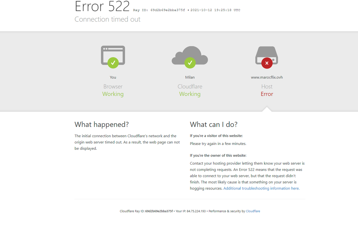

PINKISH 2 Posted October 12, 2021 Posted October 12, 2021 Hi, so i think it's fourth time in those last 2 years that i've been trying to make https work. But it never does. I have ovh domain name, i've configured cloudflare, the servers are working, i create a certificate, convert it to the good format, install it on my emby, add the password, i've forwarded the ports. And everytime it doesn't load and brings me to the cloudflare error page
PINKISH 2 Posted October 12, 2021 Author Posted October 12, 2021 on the ovh page i can see an overview of my website and i can see that page, but i can't access it in any way, it doesn't work, i can only use the http port to access the site
PINKISH 2 Posted October 12, 2021 Author Posted October 12, 2021 here is the log and the timed out page embyserver.txt

Carlo 4561 Posted October 14, 2021 Posted October 14, 2021 Hi, most likely something isn't correct in the the conversion you're doing for pem to pk#12. If you like, zip up the 3 cert files and PM them to me along with a password you want to use and I'll convert it for you to try. BTW, you can turn on debug logging (logs menu), then restart your server. Wait about 1 minute then take a look at your log file. You will see an error if the cert format or password is incorrect. Start with this step. It's also possible a setting is wrong on Cloudflare but if you followed the guide it should be ok. If you like I can do a remote support session with you to set this up as I've done it a hundred + times.
