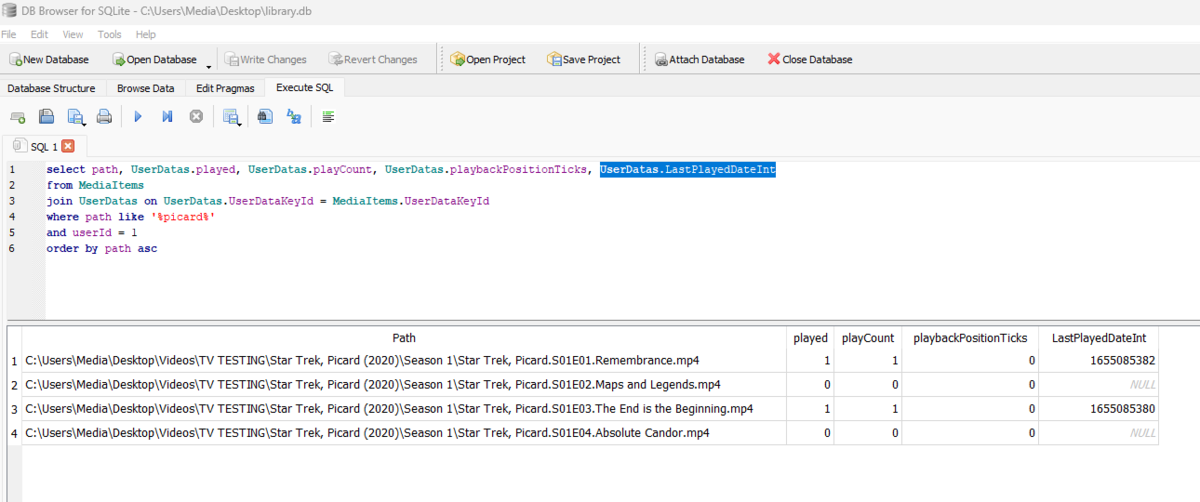

Happy2Play 9814 Posted June 13, 2022 Posted June 13, 2022 I believe UserDatas.LastPlayedDateInt is the key here. Test the order marked as watched. Marked three then one makes two next up, but marking one then three makes 4 next up.
TeamB 2440 Posted June 13, 2022 Author Posted June 13, 2022 1 hour ago, Happy2Play said: I believe UserDatas.LastPlayedDateInt is the key here. Test the order marked as watched. Marked three then one makes two next up, but marking one then three makes 4 next up. I guess that makes sense but I have completely removed the entry in UserDatas for that item and it is still showing up as the next up. Perhaps UserDatas is not even the correct table to be looking at, I am just guessing here.
