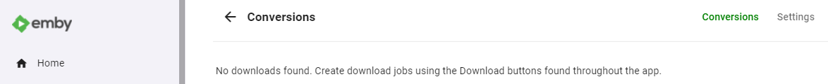

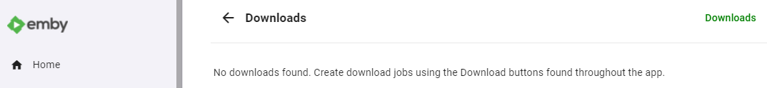

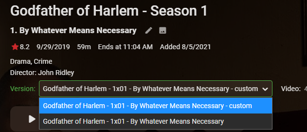

danergo 40 Posted October 11, 2021 Posted October 11, 2021 (edited) Hi! I know I can have multiple versions of the same media by renaming my media to the containing folder and adding " - versionname.ext" to it. This works as intended, although I think people need that very rare, and (as I) we don't remember the correct syntax. It would a be great to have an option in the metadata page where we can select one file and mark it as a version by providing our preferred name of the version. Then do this on the second, third, etc file, rescan the library, and done. What do you think? (Or we already have this somewhere, somehow?) Second thing which is a bit different, but belongs to here: I have added a "Conversion" to one of my media, to convert it down for lower end clients. It worked pretty well, now I have two versions when I'm browsing: But, I realized I don't need it (as it was just a test), and removed that from the Conversions page: Neither I have downloads: And after I removed and rescanned the library, this conversion has not been deleted, so I still have the "custom" version listed. I can't see that from the metadata manager either, so my only way to really remove the conversion is to delete through an SSH shell. I believe this is a bug, when I remove the conversion, it should remove physically the converted file, no? Thank you! Edited October 11, 2021 by danergo

danergo 40 Posted October 11, 2021 Author Posted October 11, 2021 Luke, no, let me rephrase with steps took: 1.) I have downloaded a movie with name 'taxi.5.1080p.blueray.fromusera.mkv' 2.) I identified it as "Taxi 5", and let Auto-organize putting into a directory, so it will be moved here: "Taxi 5 (2017)/taxi.5.1080p.blueray.fromusera.mkv'. 3.) I realized it's too "heavy" for my lower end devices, and I didn't want my NAS to convert it: I found another one and downloaded with name 'taxi.5.1080p.custom.mkv' 4.) I identified this later version too as "Taxi 5", and let Auto-organize moving it into the same directory. Now the directory is as the follow: Taxi 5 (2017)/taxi.5.1080p.blueray.fromusera.mkv Taxi 5 (2017)/taxi.5.1080p.custom.mkv Only the blueray is displayed in the library, and my original question's purpose was to find out if it's possible through metadata editor to rename physically these files in the filesystem, to let Emby recognize them as versions of each other. I know I can rename them via SSH/SCP access, but I'm looking for the way/possibility to do that from the Emby interface. I know I can change the display title, but that's good for me, I don't want to change that. I need to show Emby, that those two files shall be considered as versions. NB, if I rename them to these, Emby does recognize them: Taxi 5 (2017)/Taxi 5 (2017) - blueray.fromusera.mkv Taxi 5 (2017)/Taxi 5 (2017) - custom.mkv As versions of "blueray.fromusera" and "custom". Sorry for being blurry.
Luke 42268 Posted October 11, 2021 Posted October 11, 2021 OK as far as physically renaming, no, there's nothing in the metadata editor for that.

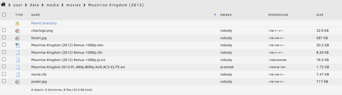

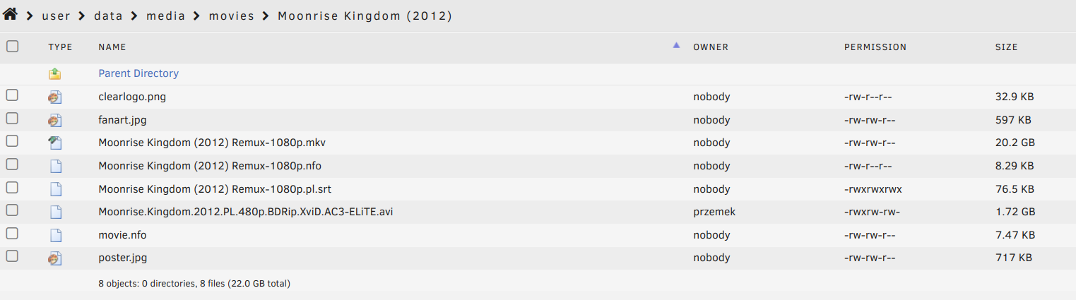

Przemek 70 Posted June 24, 2024 Posted June 24, 2024 On 10/17/2021 at 6:08 PM, Carlo said: Yes it should. Hi, can You tell me how to make one media in my case: just change names like that: Moonrise Kingdom (2012)_1080p_english.ext Moonrise Kingdom (2012)_480p_polish.ext without extensions?
Neminem 1629 Posted June 24, 2024 Posted June 24, 2024 Change the name of your 480p version to match the naming of your other files. The 480p is not named like the others. Movie Naming | Emby Documentation
Przemek 70 Posted June 24, 2024 Posted June 24, 2024 6 minutes ago, jaycedk said: Change the name of your 480p version to match the naming of your other files. The 480p is not named like the others. Movie Naming | Emby Documentation Like that?
Neminem 1629 Posted June 24, 2024 Posted June 24, 2024 (edited) You could try, but not sure that works. Since before the dash " - " you have BDRip or Remux Could never wrap my mind around it. Edited June 24, 2024 by jaycedk Edit

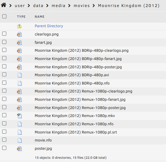

ebr 16347 Posted June 24, 2024 Posted June 24, 2024 Just now, jaycedk said: Since before the dash " - " you have BDRip or Remux Right - move the ' - ' to right after the common part of the name. 1
Przemek 70 Posted June 24, 2024 Posted June 24, 2024 28 minutes ago, ebr said: Right - move the ' - ' to right after the common part of the name. I make like that:

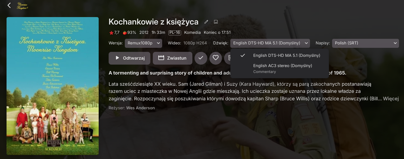

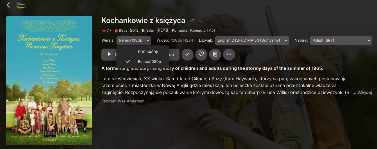

Przemek 70 Posted June 24, 2024 Posted June 24, 2024 Now it works: it's possible to add some info that bdrip 480p is polish language?
ebr 16347 Posted June 24, 2024 Posted June 24, 2024 14 minutes ago, Przemek said: it's possible to add some info that bdrip 480p is polish language? Whatever is to the right of the ' - ' in the file name will show in that drop down, so, yes. 1
