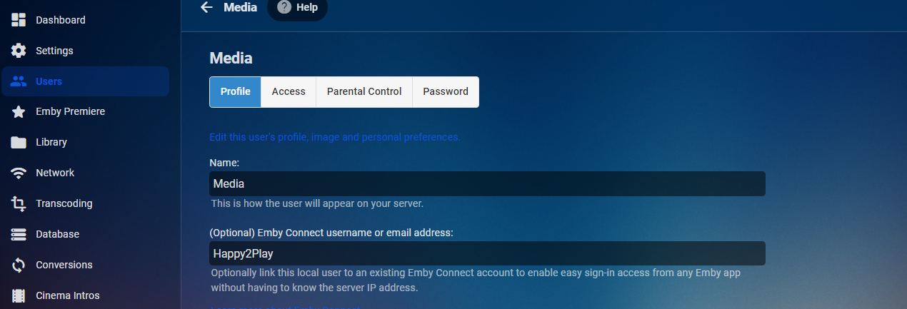

Happy2Play 9802 Posted October 8, 2021 Posted October 8, 2021 You can do that yourself as you control all your users. Remove Connect username, hit save, re-add Connect username, hit save. But you many need to elaborate on your issue.

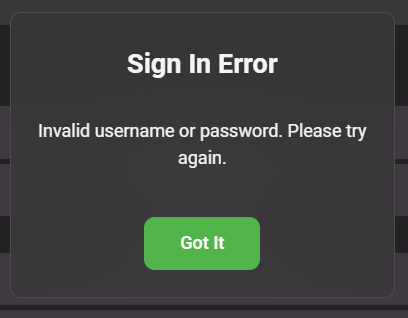

smartenjoyment 0 Posted October 8, 2021 Author Posted October 8, 2021 i can log into my server but i dont have access at all to the emby i get this messsage with right username and password as i can log into here with those details and if the admin was turn off i should still be able to log into emby and view my content with the admin side.

smartenjoyment 0 Posted October 8, 2021 Author Posted October 8, 2021 ok, when i say i can't log into my emby at all how does that not make make any sense, i have try both the app.emby.media and the ip address i have tried log in with my admin login details and with my email log in details which i know i was log into my emby about 4pm uk time and was fine when i try to log into again at 5pm couldn't access but speak to someone they could I have tried to log into my emby app on my phone / app on my firestick both can see my server but when i click on can't get access. Speak to someone which else which has a emby admin they think my account has been unlink from my log in details.

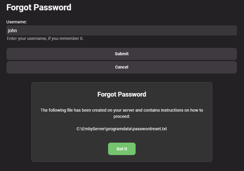

Carlo 4561 Posted October 9, 2021 Posted October 9, 2021 What OS do you have Emby Server installed on? When you open a browser and type in your local Emby Server address such as https://192.168.1.10:8096 you should get a login page. On that page is with a ? mark is "Forget Password". Have you used this?
smartenjoyment 0 Posted October 10, 2021 Author Posted October 10, 2021 hi, my server is Linux base, I have click on the forgot password that didn't work
Carlo 4561 Posted October 10, 2021 Posted October 10, 2021 It didn't give you instructions on where to find a text file located on your system? It will generate this text file regardless if you use an account that actually exists on the system. So if you got the message but were not able to actually reset the account it's because it doesn't exist. This feature is only useful to the admin of the system with access to the file system.

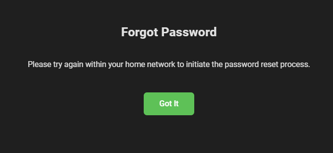

smartenjoyment 0 Posted October 10, 2021 Author Posted October 10, 2021 only get this message so i wonder if my account somehow be complete been deleted
Happy2Play 9802 Posted October 10, 2021 Posted October 10, 2021 1 hour ago, smartenjoyment said: This is telling you are on a Remote connection and have to be on your LAN to complete the request for a admin account. 1 hour ago, smartenjoyment said: only get this message so i wonder if my account somehow be complete been deleted Nope the account is still on your server. Are you currently Remote to your server?
