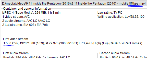

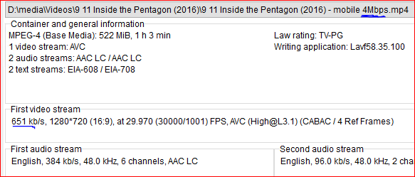

justinrh 264 Posted October 6, 2021 Posted October 6, 2021 (edited) original post title: Conversion bitrate not honored When I convert this file, the selected bitrate is not even close on the output file. original 8Mbps selected 4Mbps selected Edited October 7, 2021 by justinrh

Happy2Play 9802 Posted October 7, 2021 Posted October 7, 2021 Need the corresponding logs to see what Emby did as MediaInfo is really irrelevant. But am pretty sure there are other topics on this and will attach if I find them.
justinrh 264 Posted October 7, 2021 Author Posted October 7, 2021 logs attached Please explain how the stats of resultant file are not relevant? The whole point is to make a file of a certain quality, right? embyserver.txt ffmpeg-transcode-cee6c2b4-b066-414a-a681-eb62caa9d4ed_1.txt hardware_detection-63769147490.txt

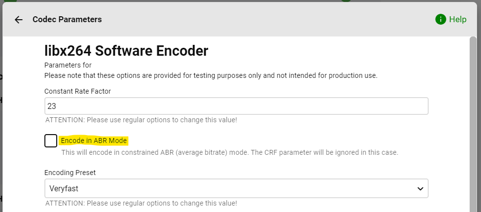

softworkz 5129 Posted October 8, 2021 Posted October 8, 2021 16 hours ago, Happy2Play said: @Luke @softworkzwasn't there a discussion about maxrate conversions as the conversion sits at about 1.5Mps instead of the set quality? -c:v:0 libx264 -g:v:0 180 -maxrate:v:0 3520000 Yes, this is something we haven't come to work on yet. For libx264, we're using the CRF (constant rate factor) mode which isn't working in a way to hit the desired bit rate. The options for getting closer are: 1. Use lower CRF Values Means lower than the default (23), e.g. 16-22 2. Try ABR Mode To activate, you need to install the "Emby Diagnostics" plugin and adjust the encoding parameters of the libx264 encoder under "Advanced Transcoding": We've documented this a number of times, but received just minimal feedback so far. (which might explain the prioritization) As I always said: feedback on playing around with this is welcome! softworkz 1

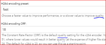

justinrh 264 Posted October 8, 2021 Author Posted October 8, 2021 @softworkz It seems to me you are trying to control too many factors, as they all do the same thing, so which wins? CRF and preset both determine quality output. Consider Handbrake's UI - only one or the other (bitrate or CRF) can be set, but not both; then a preset is just a prescribed CRF. We have too many inputs acting at the same time. Given this UI, what quality value is the user actually going to get?
softworkz 5129 Posted October 8, 2021 Posted October 8, 2021 (edited) 5 minutes ago, justinrh said: CRF and preset both determine quality output. Consider Handbrake's UI - only one or the other (bitrate or CRF) can be set, but not both; then a preset is just a prescribed CRF. We have too many inputs acting at the same time. That's not correct. A preset is not a prescribed CRF! In simple words: CRF determines the output rate ("constant rate factor") The presets determine the amount of compute resources to use for encoding (you can have better and worse quality at the same encoded bitrate) Edited October 8, 2021 by softworkz
justinrh 264 Posted October 8, 2021 Author Posted October 8, 2021 Then maybe Emby's use of 'preset' is different than Handbrake's use of 'preset'. In HB, selecting a preset changes the CRF to a certain value, then the user can adjust from there overriding the preset value. Either way, how is a user supposed to grasp these two settings? Both are said to determine "quality". There is no way to correlate.

justinrh 264 Posted October 9, 2021 Author Posted October 9, 2021 (edited) I set CRF = 18 (preset = veryfast). "8Mbps" -> 6.5Mbps (1920x1080), "4Mbps" -> 2.8Mbps (1280x720). Much closer! The visual quality is much better. I'm curious as to why the frame size changes - another variable not shown to the user! Tomorrow I'll play with the diags plugin if I have time. Edited October 9, 2021 by justinrh
softworkz 5129 Posted October 9, 2021 Posted October 9, 2021 10 minutes ago, justinrh said: I'm curious as to why the frame size changes - another variable not shown to the user! This is because the conversion uses the same logic as for playback: for playback, we have the bandwidth as input parameter (either auto-detected or set by the user). Going from there, we need to find the best way to present a video, and with a given bandwidth, there are certain steps where the overall result will be better at a lower resolution instead of keeping the resolution and reducing the bitrate only. 1
justinrh 264 Posted October 9, 2021 Author Posted October 9, 2021 I installed the diag plugin and don't see anything for libx264 in these pages:
softworkz 5129 Posted October 9, 2021 Posted October 9, 2021 Got to "Transcoding", choose "Advanced" and Save. Got to "Advanced Transcoding", scroll down to libx264 Encoder and click on the gear button.
justinrh 264 Posted October 9, 2021 Author Posted October 9, 2021 There is no 'advanced' on the Transcoding page.
Happy2Play 9802 Posted October 9, 2021 Posted October 9, 2021 1 minute ago, justinrh said: There is no 'advanced' on the Transcoding page. You do not see this drop down box?
